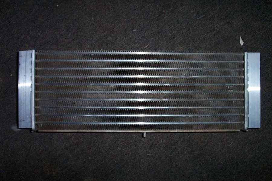

UPDATE!!!!
OK everyone I have whacked up the IC and started to reassemble.....I have the cored TIG welded together now i'm fabbing up the endtanks tell me what you think.

nice looking man. she going to be up and running before the nc/sc meet? i should have my spool stage 3 on then, we can talk turbos.
I look forward to you joining the ranks!
chdesign said:
not big enough my ass the core is 20x8x2.75 more than enough it will flow 400 hp.
That's a nice looking job. My core is only 15X9X3 and It was pretty tight in the front. I guess you must have a bit more room up front in the 3rd gens. Are you planning on running your piping under the front frame? Did you need to mod your bumper to let this thing fit?
Rick
i haven't looked at how to route the piping yet.....i thought about under the frame but i'm using 2.5" piping and thats gonna hange quiet a bit my bumper doesn't come as low as the P5's and the Mp3s so it would show some also.....one pipe under the frame might not be bad and i can run the other somewhere else.....and the total length with endtanks will be 25 inches tip to tip of the intercooler. I will make it fit. I will even break teh sawzall out if i have to which i will....i'm going to hav eto do some hacking thats for sure....as for by March 23rd i have no idea depends on how fast i get money and how fast i can get the parts fabbed and test fitted.....regardless i will bring what i have done with me to show off probably.....i will more than likely have everythign installed by then except the turbo itself so that when i do get the turbo on its just the turbo and mani that i will have to bolt on a 1 hour job no biggy.....my thing is going to be hooking up the MF2 and the gauges along with my O2 simulator which i finally got....its a huge project but it willbe worth it.
