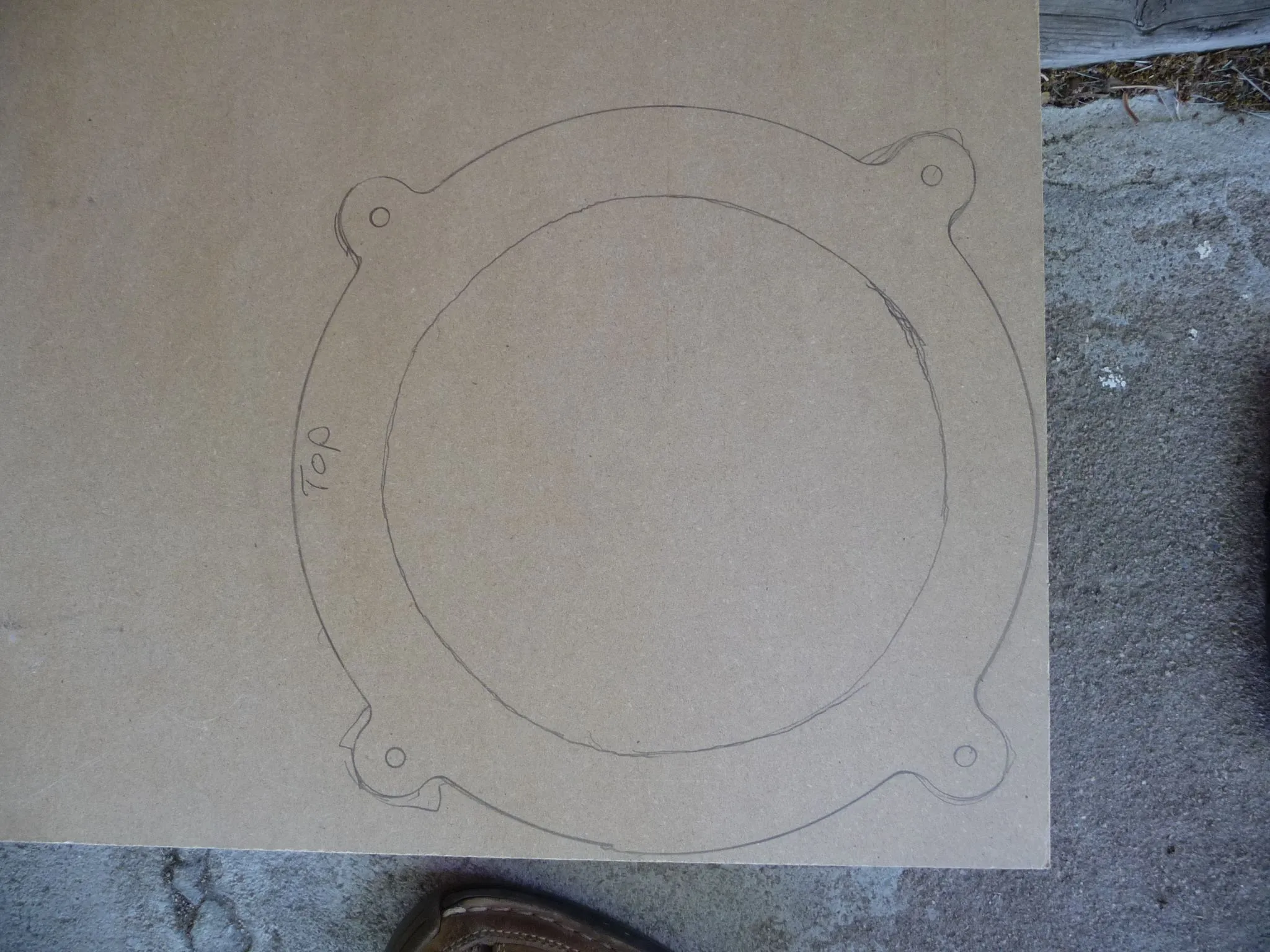

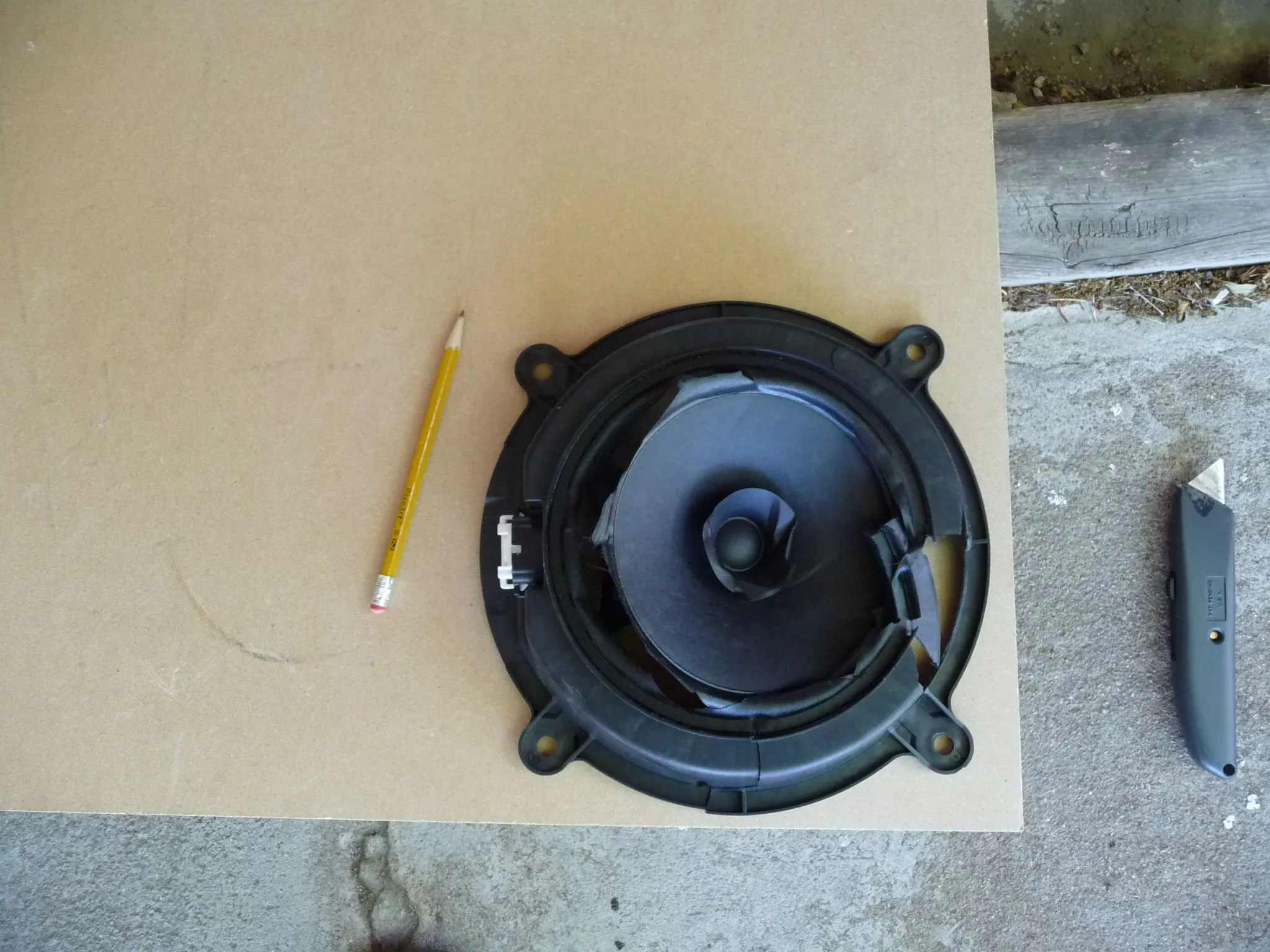

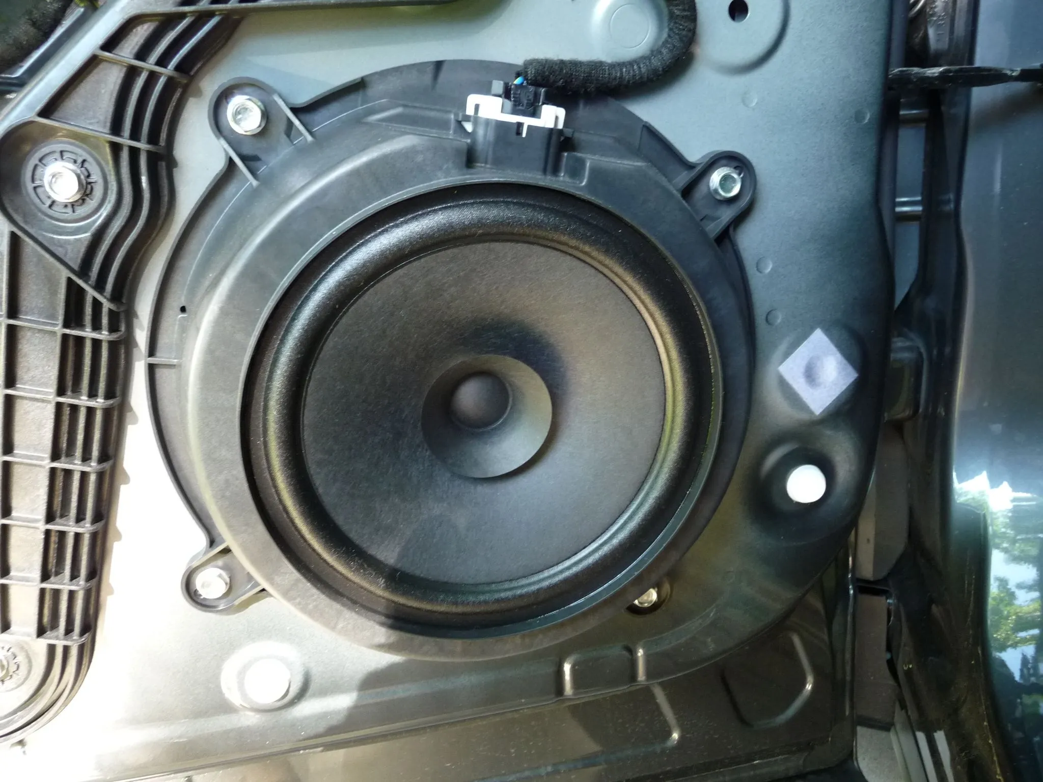

The first picture is the stock speaker with large frame. You'll use the frame as a template for an mdf spacer.

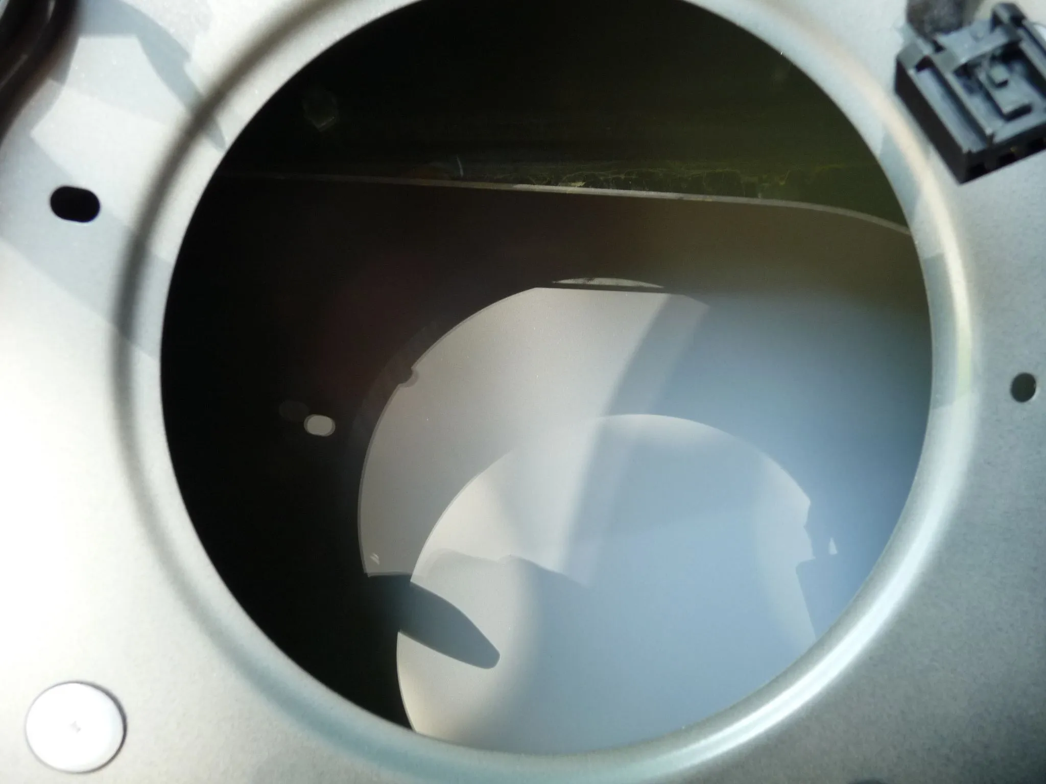

The stock opening is big enough, but when you wire up the speakers, make sure none of the wiring is against the sheet metal edges. I missed that on the first one and was getting a short and then I got glue/caulking all over my hands taking it back out and redoing it.

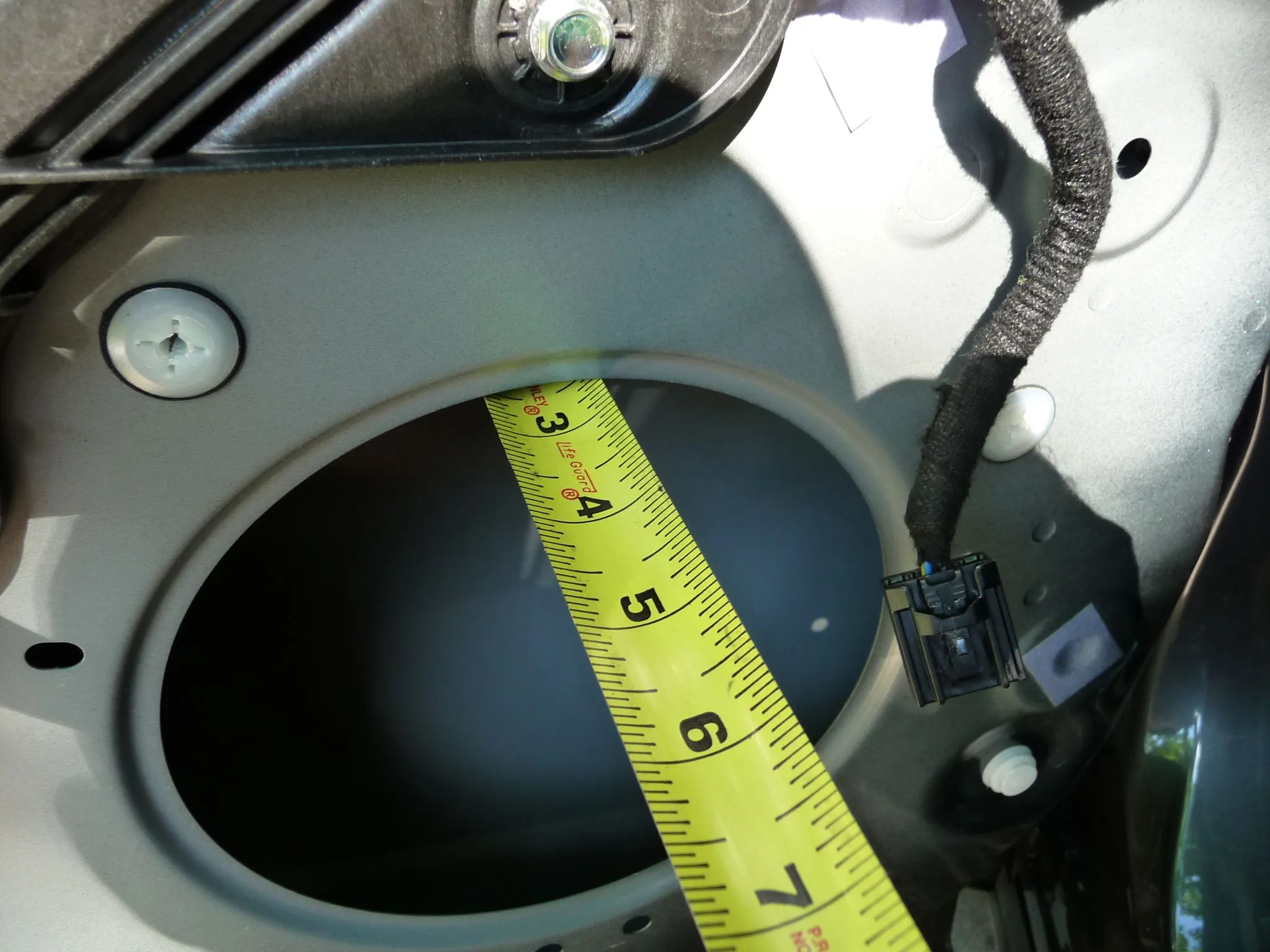

You can see from the tape measure you have about 2 and 3/4" depth. The mdf is almost 3/4", so your speaker can have about a maximum 3 and 1/4" depth. This is measured with the window down.
Use 3/4" high density mdf and use the speaker frame to draw your outline.
You'll use your new speaker templates to draw the inner circle. I used a jigsaw to do the cutting. Sorry I have no more pictures.
Once you cut out the mdf, you'll screw it to the door using some good size sheetmetal screws in the stock locations. Put caulking between the mdf and the door panel to seal it. Then use whatever screws come with your new speakers to screw them to the mdf. If the screws are longer than 3/4", you'll have to buy shorter ones. I also caulked the speaker to mdf to seal it well.

Planning on putting some 8" mid-bass speakers in the front doors, and I would like to figure the maximum "width" of MDF I can use for the speaker mount to be able to pull the speaker away from the window, but not so far that it hits the door panel. I would like to thank the O.P. for the pics.(2thumbs)
Upon researching the available 8" mid-bass speakers (in my budget....), I'm seeing top mount depths range from 2.6" to close to 4". I was wondering if anyone still had their old factory speakers to measure the distance noted in the pic below. (and if this distance is uniform all around the speaker, or is it shallower at one side with the speaker sitting "tilted". If it is tilted, what is the minimum measurement?) If we're at 2 3/4" between the metal door frame and the window + say 1 1/2 of speaker mount, I'd feel comfortable with a speaker approaching 4" deep, but w/o knowing the depth of the factory speaker mount, I don't want to order speakers that are too deep.
I haven't had my door panel off yet, or I could measure it myself, but I'd rather not take the panel off and on any more times than necessary, especially since it's below freezing here in MI already...
