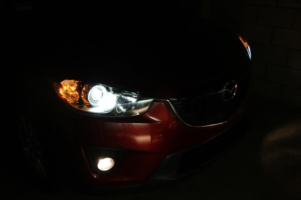

The result looks very OEM from outside, light output was definitely improved. Color is a bit more white than the OEM halogen, still a bit yellowish with no tint of blue at all. Light intensity on the road is far better, I can see the signs more clear than before. Beam cutoff were the same, no way compare to OEM HID projectors. I checked the glare which is about the same as original, according to other forums, if glare is your problem, u can try to bend the metal pieces inside the housing to minimize the glare issue, or do a retrofit to get the best beam cutoff pattern and light output. Personally, glare is very minimal in our CX-5 projector and definitely not as big issue as those people driving with their high beam on without noticing themselves.(boom02)

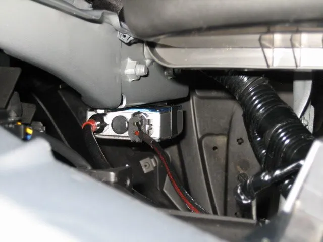

Can you post some pics of where you install the ballast?
quick note
I used the original H11 gasket instead of the one came with the kit bulb, fits much better, no trimming needed
mounting, passenger side is tight so I mounted next to the windshield washer bottle using one of the unused welded nut, M6
the one on driver side, I've mounted way down low, there is an unused M8 welded nut.
I hope this helps.easy mod.

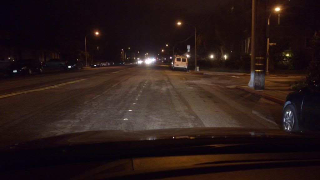

Sorry for poor picture quality, and finally it rained last weekend. Although it was not raining while I took the picture, but the floor is a bit wet, hope this help, or I will try another time when it rains badly.
Have you driven in the rain with these yet? I am curious if they improve your visibility or make them worse by bouncing a lot of light off the wet pavement.
Do you have any other pictures or video?
I used to have 120W PIAA Fog light system on my subaru which is way brighter than any HID system, it does reflect the white light on the wet floor. I personally think that when it comes to rain, seeing more doesn't mean it's better. my 2 cents.
