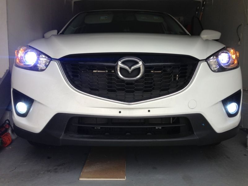

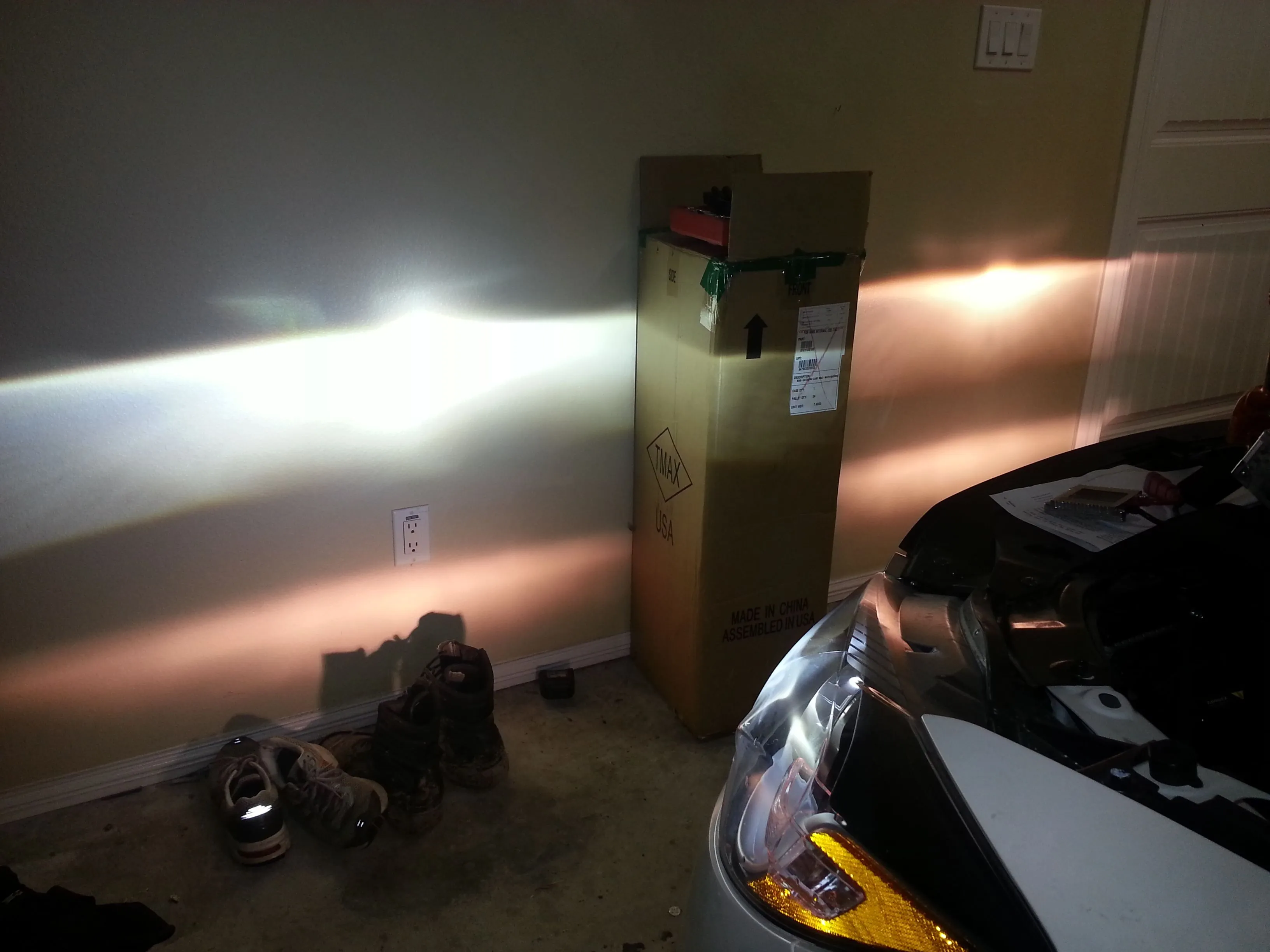

Well after much research I purchased this rather inexpensive HID conversion kit:
https://www.amazon.com/dp/ (commissions earned)
The reviews were mostly positive, but I always assume I'm the one that's going to have the nightmare experience but I can honestly say that I am very pleased with how they've turned out. I decided to replace my headlights as opposed to replacing the daylight running lights (DRL's) only because I always have my headlights and fog lights on.

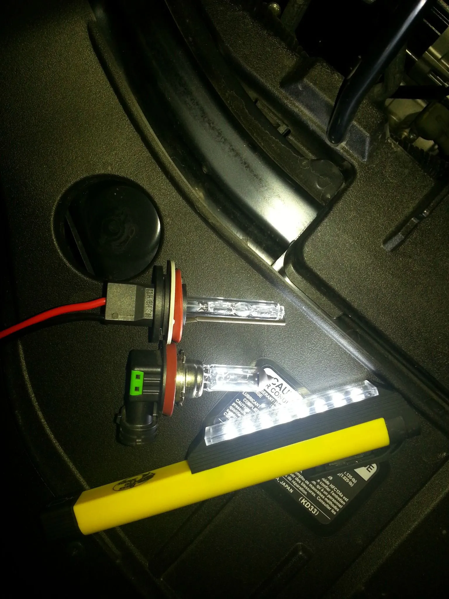

Installation would've been a breeze had I known that the replacement lights had an extra rubber washer (the white one) that I needed to take off. Also I should've been familiar with removing the connection from the bulb (stupid easy). So the first light took me about 35 mins but the second one only took about 8-10 mins tops.
Next I'm going to replace my fog lights.
Anyways enough of me yapping on, here are the pics:

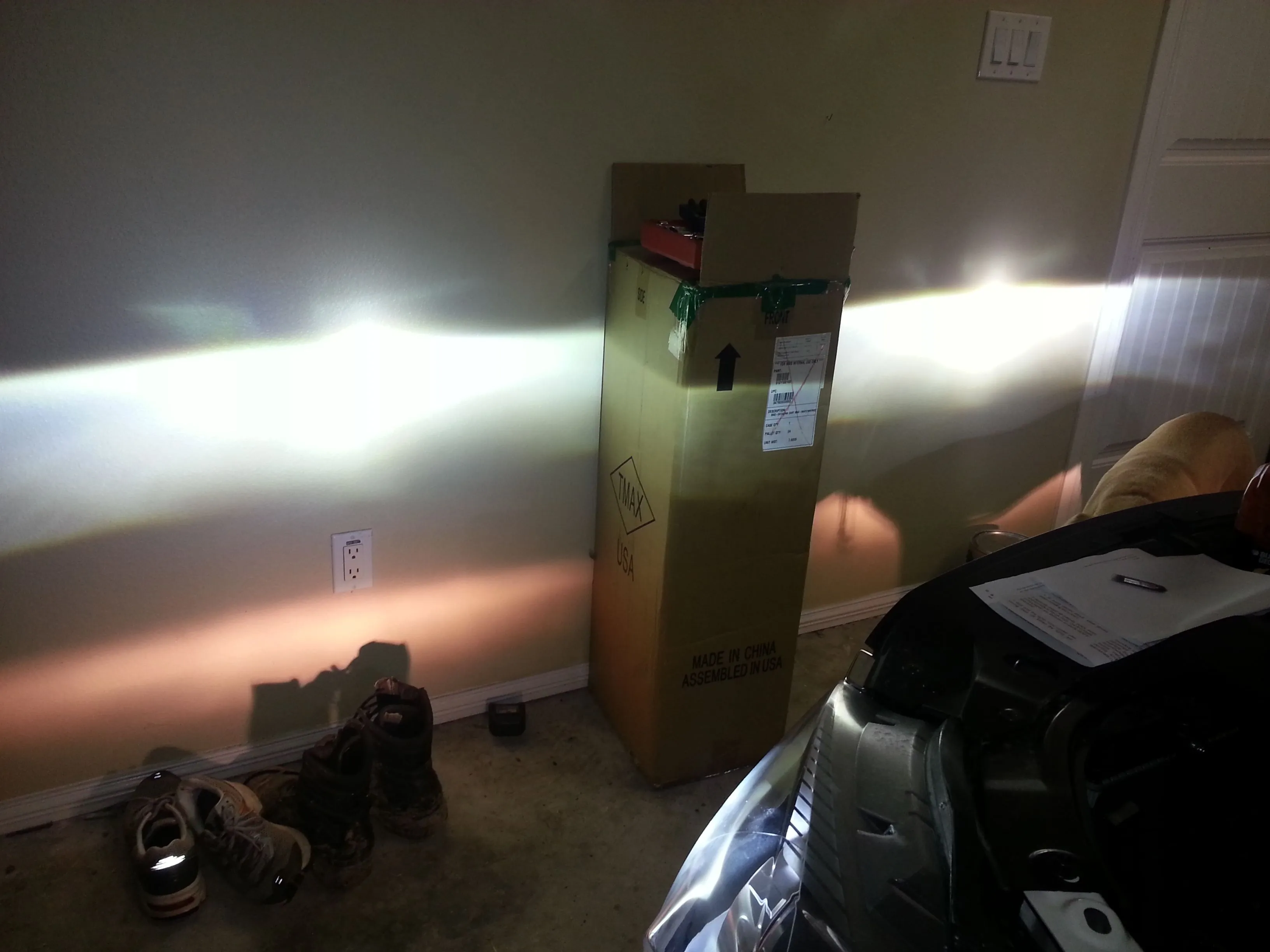

Have any pictures of before and after from the front? All the HID conversions I've seen glare a noticeable amount more than the stock lights. And while I love more light in front of me at night I'm not willing to become the guy killing the oncoming traffics ability to see.
I believe glare is mostly a problem associated with reflector style headlight housings. The CX-5s have projector style housings that have a pretty clean cutoff.
the really, really bad glare is from the non-projector ones but I see a lot of ones with projector headlights that glare noticeably and distract.
http://youtu.be/B19G2RvoKuY at about the 3 second mark you can see a fair amount of light even with the camera at a very high, close angle. All the before/after pictures I find online that are looking towards the car from a standing position you can tell in the before shots that the lights are on but in the after there is that bright glow around them that will wash out oncoming drivers night vision.
I agree, I see far too many headlight setups that are non-conforming in terms of glare. I drive a lot of miles on dark, rainy, twisty highways and it's a real safety issue, not just for the oncoming cars but also the offenders because when a driver has trouble with visibility they might drift too wide and hook a tire on a soft shoulder (sometimes with a small abrupt edge). The resulting steering correction can cause the vehicle to suddenly swerve into the oncoming lane and cause the most deadly type of accident (head-on collision). Sadly, glare doesn't even improve the vision for the offending driver (glare is wasted light going where it is not needed).
For the same reason I cannot understand the drivers that leave their fog lights on in the rain when there is no fog. Fog lights cause a bright spot on wet pavement immediately in front of the vehicle which does nothing to improve the offenders visibility down the road (although it can offer the ILLUSION of better sight). This bright spot on the pavement produces a lot of extra glare for oncoming drivers and the glare is additive to any glare produced by the headlights. Even conforming headlights cause some glare - it's unavoidable, the goal is to minimize it to increase everyone's chances of arriving at their destination safely and rested.
With the huge population bubble of baby boomers reaching retirement age and beyond, we will see a spike in glare related deaths. As the eyes age the cornea becomes less clear and glare is more problematic. Motorists can do their part by resisting the temptation to modify DOT approved designs to everyone's detriment. That's what standards are for.

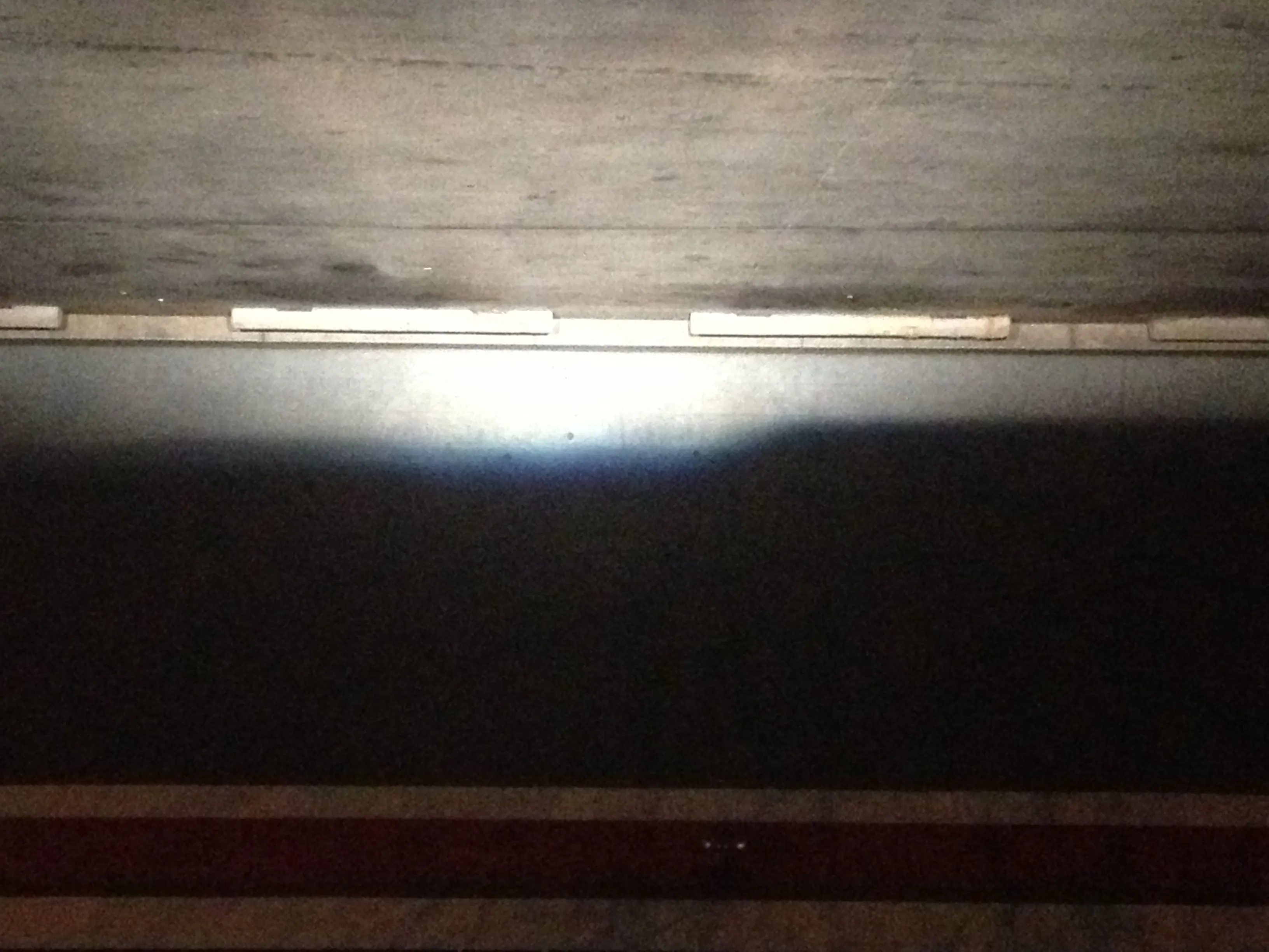

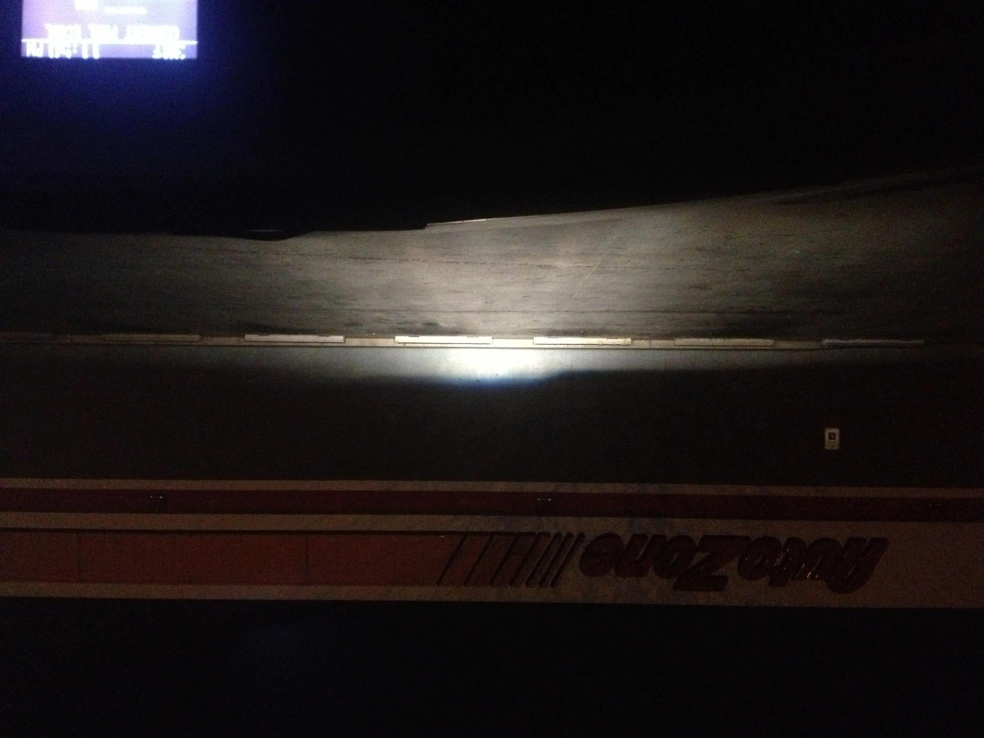

There is still glare. You can see there's still noticeable bleed off above the cutoff that's not associated with the squirrel finders. The cutoff on these Koitos are okay but I would not call it clean by any means. A clear lens would make it clean vs the stock fresnal lens. I have Black Series clears lenses from TheRetrofitSource.com and I blocked my squirrel finders. I believe these are the same Koito projectors that the 3 uses which are okay but even modded they don't compare to a true HID projector.

I have the DDM Tuning slim HID 35 watt with 4300k bulb. It is bright and white as can be. Complete day and night difference between the oem halogen and this kit. The upgrade is well worth it and if I had to give it a number i would say the light output feels like it tripled.

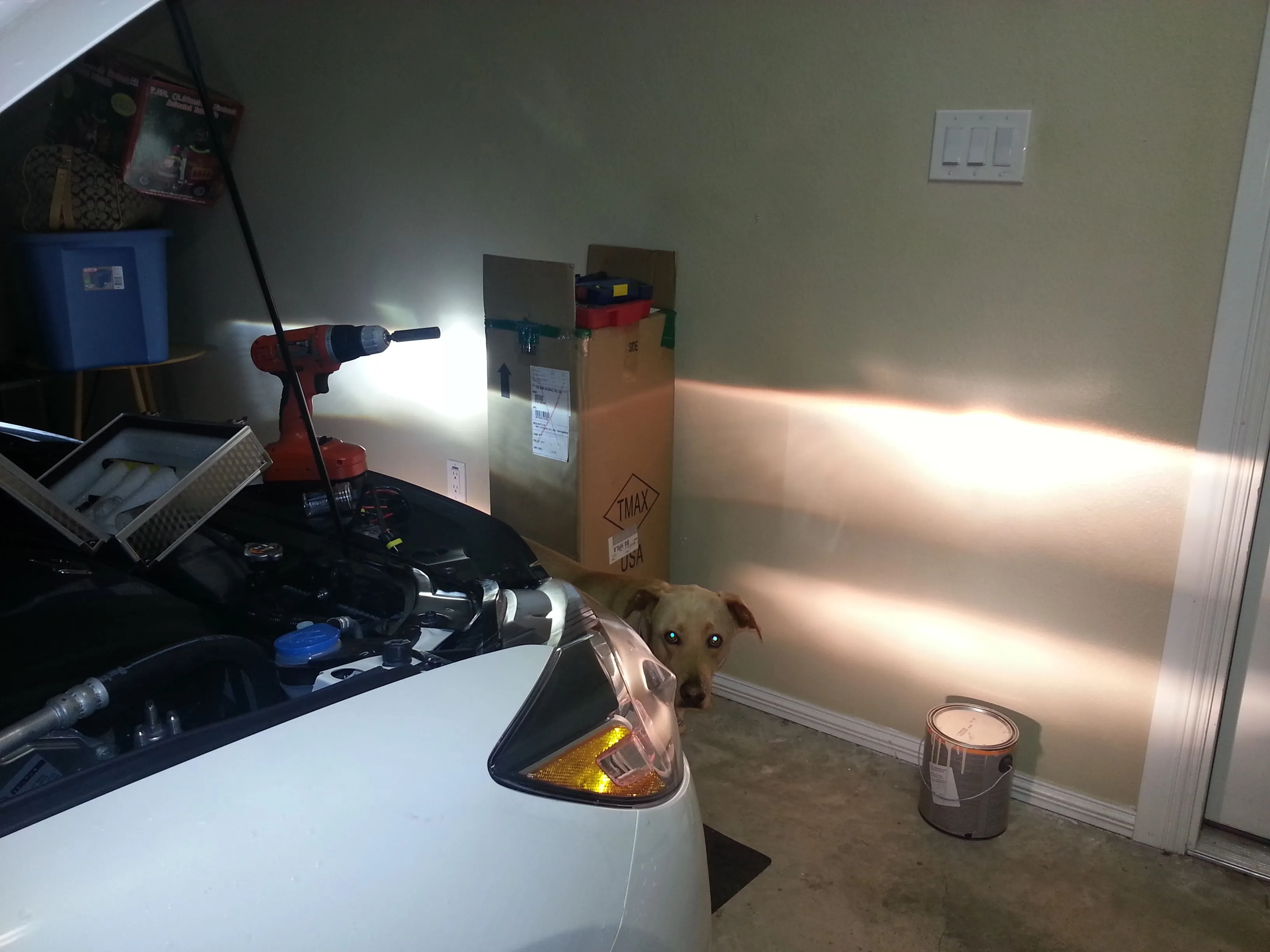

What I do recommend is double checking the light heights after the install. On my car both lights were a bit high especially the driver side was even more. I adjusted them both slightly lower than spec and they are now road friendly while providing way more light output.
Also, some of those in garage pics capturing that “glare” light above the hot spot/light beam line. Well I found that that it is at such a steep angle that it does not affect oncoming traffic or cars ahead. I already tested what my car’s lights look like from the distances.
