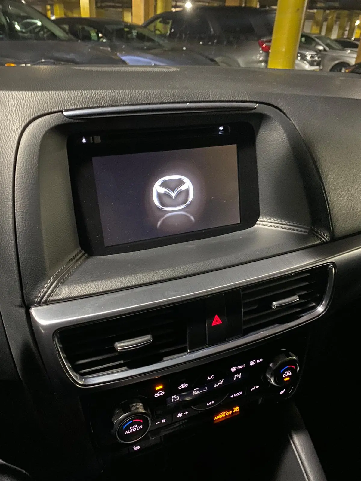

Hey guys,
I own a 2016 Mazda CX-5 GT, driven around 48k miles. So I am out of warranty and my infotainment screen just went off and wont switch on. When I try to do the reset using Nav+Back+Mute, sometimes I see the Mazda logo come on for a few seconds and it goes off again. If I keep trying this occasionally I see the reverse camera come on but again the screen goes off after 10-12 seconds.
I took it to the dealer, and he said the CMU unit has gone bust and needs to be replaced and it costs upward of $1300 before I pay so much, I wanted to check if anybody has faced similar issues and if anyone did indeed replace the CMU, does it really cost so much?
Any suggestions is greatly appreciated.
Cheers,
Vinay

I'm sure a big chunk of that $1300 is the shop labour involved with taking the dash apart, replacing the CMU, then putting everything together again. If it were me, I'd try sourcing a used CMU on ebay or from a junked CX-5, then visiting an audio install shop to see if they can replace it for you. Of course, this assumes that there is no special procedure the dealership has to do to sync the new CMU to the car.
Just some suggestions...
1) Do you have NAV SD card ? eject it and see if the head unit reboots without the SD card
2) Check the fuse for the headunit (I don't know where it is right now, but I'll try to find it for you later), it may be a fuse that is broken already but still touching when cold so it may work for a few seconds then heats up and the circuit breaks and you get a black screen.
either way try to find the fuse and replace it and see if that works
i actually did think of doing this. i have the exact same doubt. will it need a seperate sync to the new CMU for which i will have to go back to the dealer?
I found this online... https://visser.io/2017/04/how-to-soft-reset-the-mazda-connect-infotainment-system/
his description sounds like your symptoms.... looks like need to reflash the CMU ?

Michael Vissersays:
June 5, 2018 at 1:00 pm
Hi Danial, you*re stuck in a boot loop. Unfortunately only re-flashing the CMU unit will resolve this so you*re either in the deep-end of the pool doing this yourself via terminal or require a visit to your dealership.
