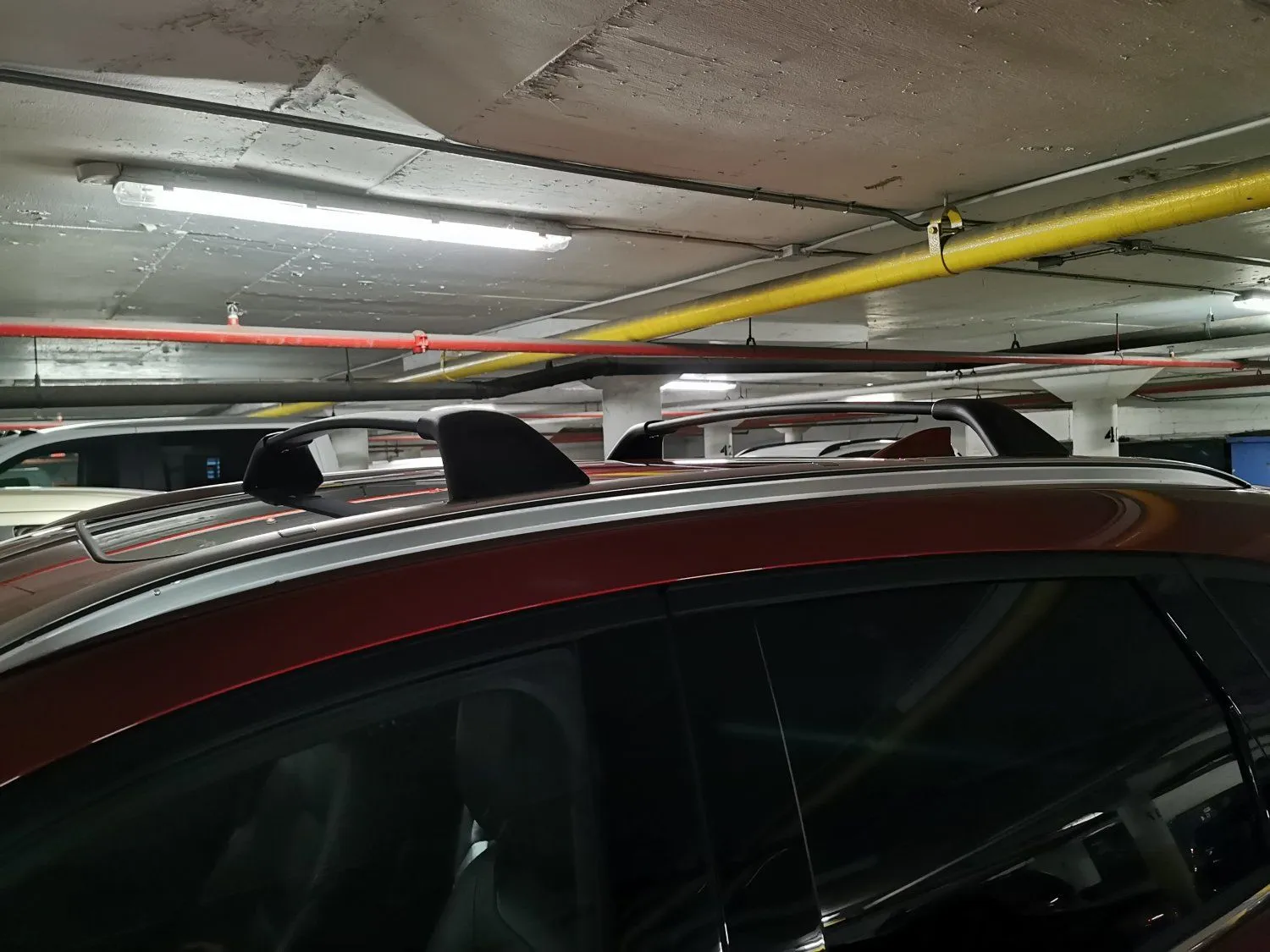

The fit and finish is great install was super easy with the help of the YouTube videos.
That said is it just me or it looks like the crossbar is backwards? Followed the instructions down to the T...
Here is a picture of them on my car.
Do you hear any noticeable wind noise?
For sure, but it's not overly loud and barely noticeable when the sunroof cover is closed.
Thanks hal2 for confirming, just looked a bit odd, but I did see another CX5 and it was the same way.
