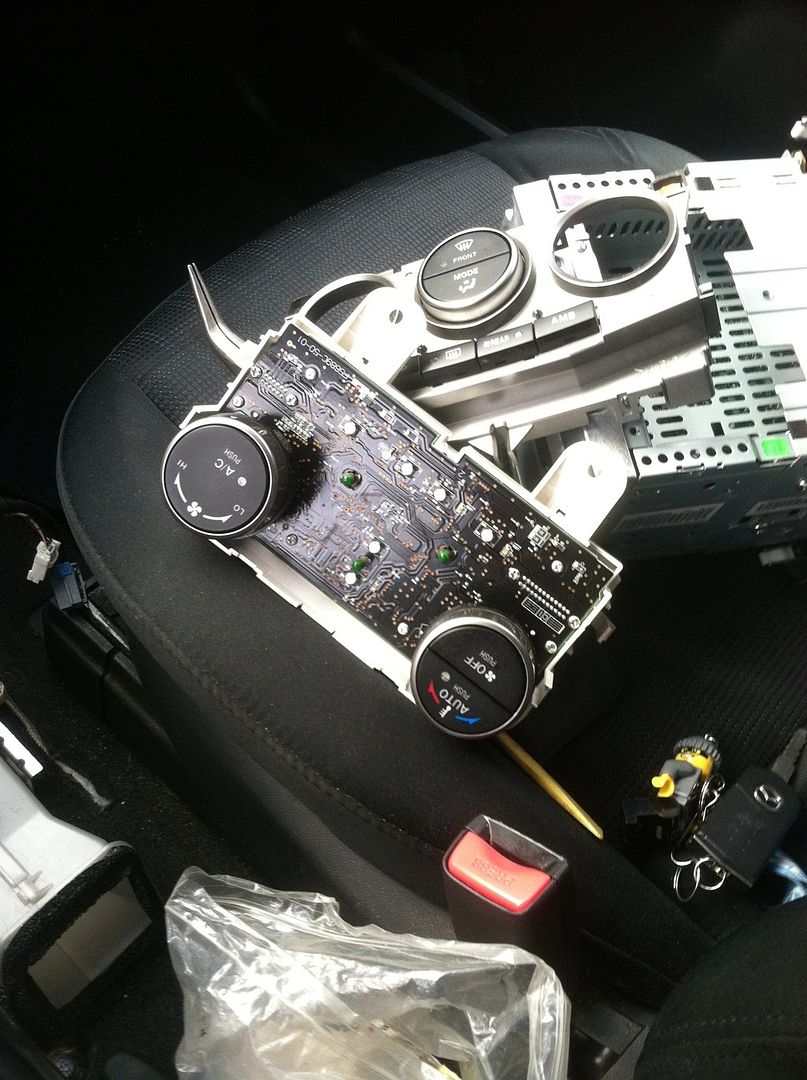

I noticed this morning that the fan control knob's AC light comes on if the AC is on, but the knob itself doesn't illuminate ...unlike the temp control knob or the center mode knob:
Is this normal? If it's not....how would one go about fixing this? I'd assume that a bulb has burned out...?
The same thing happened to me just a few weeks ago. In my case it was really easy to fix, took about 20 minutes. All I needed was a Phillips screwdriver and sharp nails to remove the faceplate. Once I removed the radio control panel I noticed that one of the green LEDs (I do not think they are "bulbs", although I may be wrong) had fallen off its socket. If yours is burned out, I think the stealer (dealer) was quoting me for some CAD $7, although you can get aftermarket LEDs (the colour of your choice) for something like $10 for all of them. I think I had noticed about 5 LEDs of two different socket sizes, possibly 4 and 5 millimeters.

Stealership is asking about $7.oo US dollars for these tiny incadecent bulbs. Mazda part# is CC5161C95 But they do seem to last along time.
They are a T3 Socket 10MM di base. on a long stalk maybe 25MM tall. Green 12v incandecent bulb not a LED. One might be able to get a 12v LED to work Ive ordered some for a buck and I will post if it works out.

Just installed the three of them. First one worked so well I replaced the two that weren't burned out.
Just is case you try this make sure you have illumination before reassembly, as getting them seated in the sockets is a bit of a pain. The short length doesn't seem to effect how they work which is great!

Cool. So are there a total of 5 bulbs on that HVAC control?
I changed my from green to white leds the swap was easy you can order t5 led bulbs from ebay and swap them into the mazda5 sockets
The far right one is not as bright due to the led
You can also use the same type of bulb (t5) for the shift pattern the buttons below the ac knobs and the ignition light if any you attempt this i will upload so pics on how to get it done
^Hmm.. on this pic it appears the HVAC leds are brighter than the other back lit buttons. What kind of LEDs did you swap it with? Just curious cuz I believe there are LEDs that are designed particularly for instrumentation purposes..
