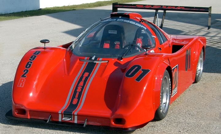

The D962R comes standard with the new RX-8 based Renesis engine, which puts out 254 hp (in stock form), and 178 ft./lb. of torque. This engine is brand new- a 'crate' engine. This engine is fuel injected and is controlled by a Microtech ECU, which is fully programmable.

"After over 200 runs on the DynoTime chassis dyno in West Palm Beach, and a ton of hours of development, we have now nailed the production numbers, mapping of the ecu, and intake manifold configuration.
Almost a year ago, we ran the Mazda Renesis engine on Daryl Drummond's engine dyno, and were able to get 254 hp at the crank.
Today, on the chassis dyno, we are consistently pulling 218 hp at the wheels at 9000 rpm. That is in-line with a loss of 15% with the Hewland transaxle.
5 of the engines are being fitting with the dry sumps and should be back tomorrow, and the remaining 5 will be done early next week. At that time, the engines will be placed in the chassis, and the transaxle/bellhousing assembly can be fitted to the engine. We are getting very close to delivery!"
254 crank HP in the D962R vs about 220 in the RX8
218 wheel HP in the D962R vs about 180 in the RX8
The D962R is a RACE CAR, it doesnt give a lot of specs on the motor....but I would guess its running race gas, that would allow you to advance the timing much more, just the timining advance alone could yeild up to 10hp. It also appears that it has a custom intake manifold, as well as a custom header/exhaust systems....
with just an exhaust and the right tuning, that could be another 10hp on the top end. Who knows that they have changed with the intake system.
I am also willing to bet the car has a better drive train, so that would also let it get higher whp.
The stock rx8 will put on average 180 wheel HP. This car has almost 40 more than that, but the combo of the custom intake manifold, exhaust system, and race gas is a huge part of that....along with the ECU.

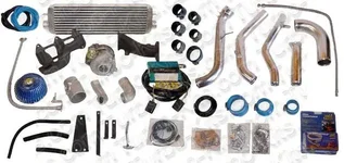

To get around 200whp NA, you would spend about double what a quality turbo system would run (like the greddy kit with all the fixes and an x-interceptor) and the turbo system would give you double the stock hp and almost 50% more TQ
