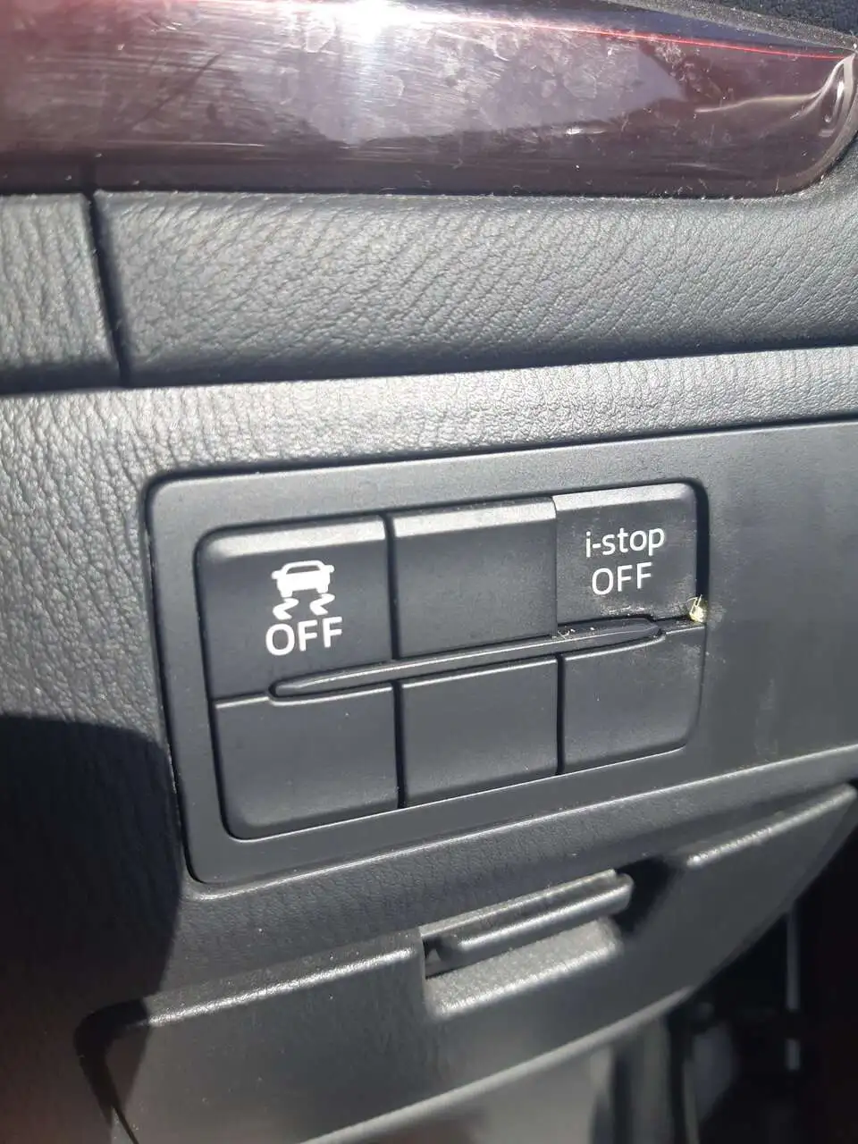

It looks like it is tricking the istop button to always stay disengaged, not a bad work around.
Not sure if it will work your car but it did on my 2014 6 and 2020 cx5, but havnt tried on the wife's 2022 cx30. Fix was to jam a toothpick in the button and i-stop turns off when you start the car. You could test by holding the button in while you start the car.
