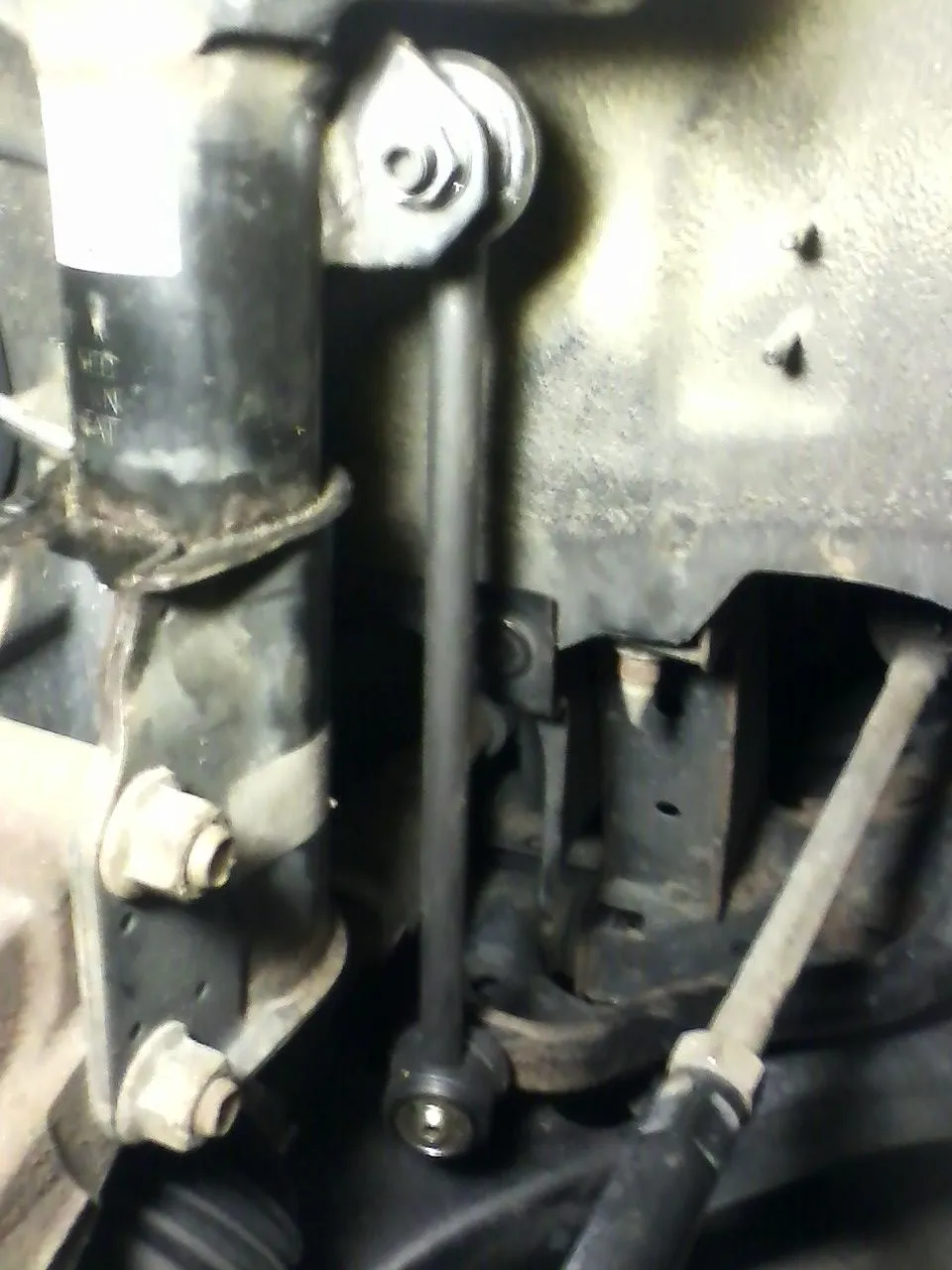

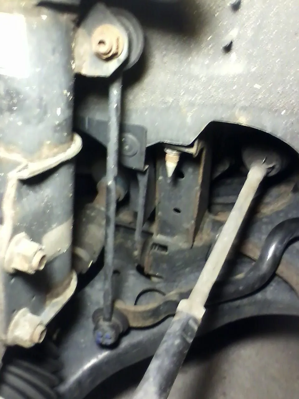

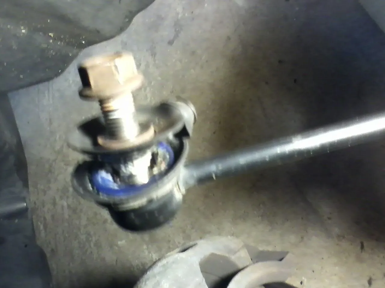

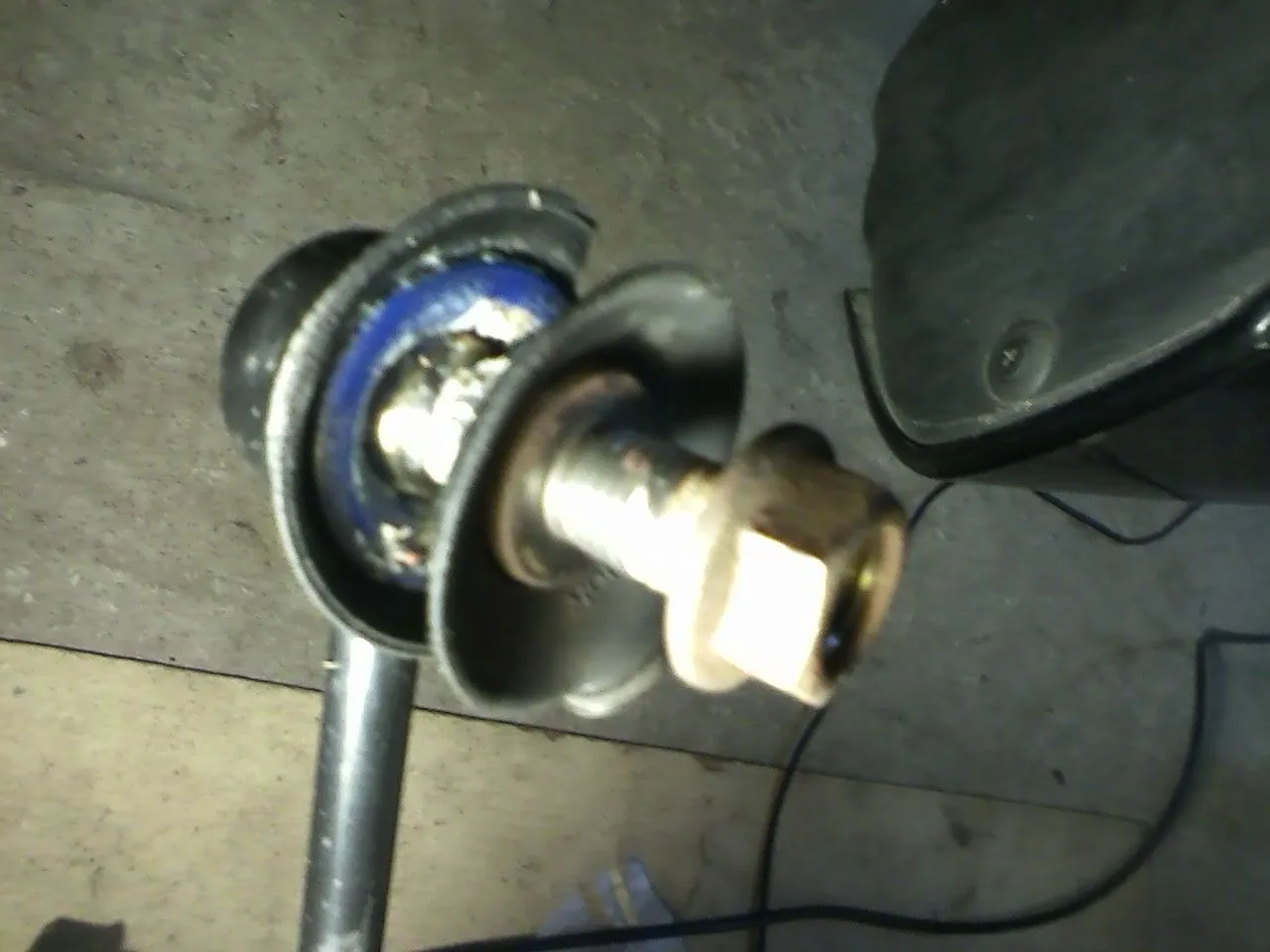

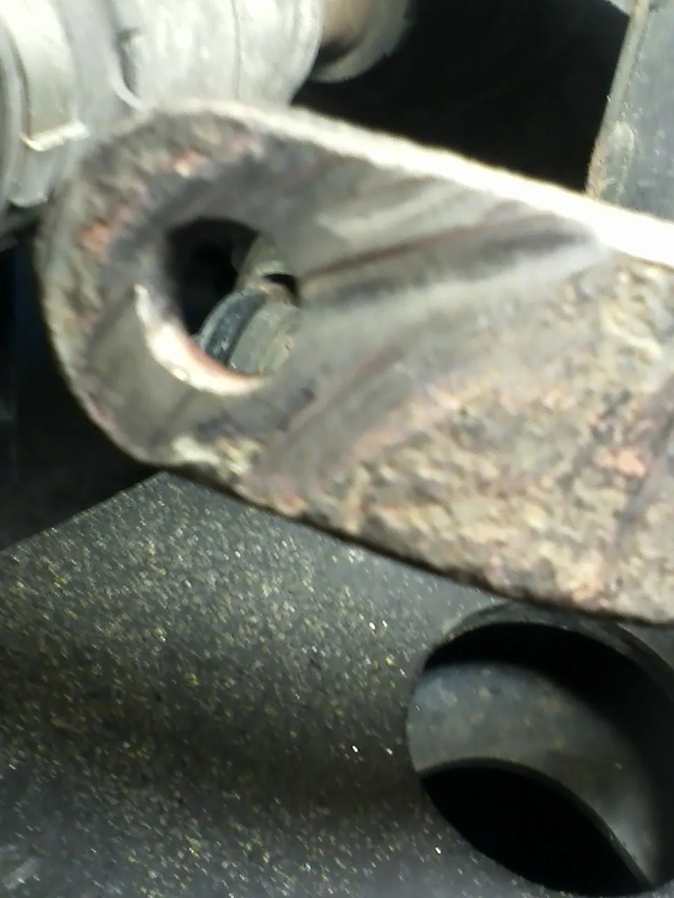

Hey every one i just wanted to share the good News ! I replaced my End links with MOOG end Links ! There 10 x better because there thicker and more reliable and there pretty good! The Job took me like 6 hours(deadhorse though because the Alen Bolt was so Rusted it ended up Stripping so i had to cut it off with a Wheel Grinder ! The only aggravating part about using the Wheel Grinder was i grinned into the Sway Bar trying to Remove the 14 MM Bolt but it's ok it didn't go that deep Regardless im Upgrading to an AWR racing Sway Bar soon TBA! But the other side came off just fine i didn't have to cut it off at all! Thank GOD!! Just look at the Pictures of the old End Links there totally trashed . Here's some pics of the Job right underneath check it out and let me know what you think!(drinks)

I would say so because i went and replaced my EndLinks and right after i replaced them My Clunking noises went away! Problem solved!

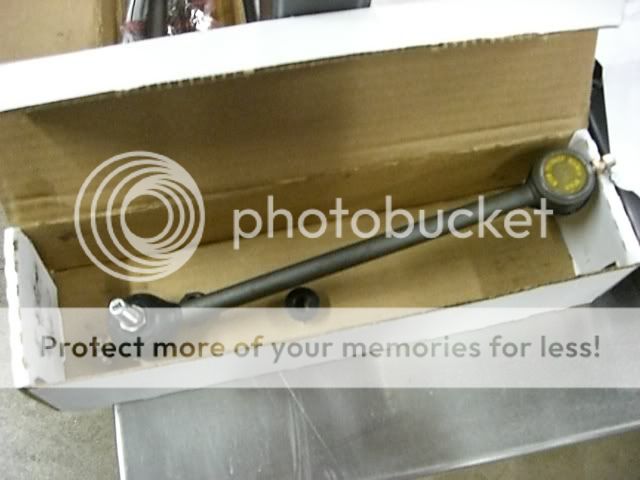

bought some moog endlinks (escape) today at O'reillys auto parts..20 bucks a piece and they came with the fittings for grease.
I can confirm this, the ford escape endlinks do come with the fittings. And holy crap what a difference. turned my car from a rattling mess to a car again.

ehhhhh i wanna say 180886 or somthing like that. i called autozone and asked for the mazda protege ones and they had ones that were 8.5 inches long and ones that were 7.25 inches and got the shorter ones part number and went to my loocal part store and got moog ones.
Would you guys know if these end links will fit an early 2000 Protege ES if I installed the Racing Beat front sway bar that came standard on the Mazdaspeed Proteges?
Just took a trip to my local Autozone to check out these front end links, Part No. 18348. The good news is that they and are actually made by Moog under the Duralast brand. Measuring 10" center to center, these will fit late the 2000-2003 Proteges. The bad news is that they will NOT fit Proteges manufactured prior to October 2000, which is when Mazda changed the length of the front end links from 8" to 10" in order to suit the manufacturer of the strut housings.
