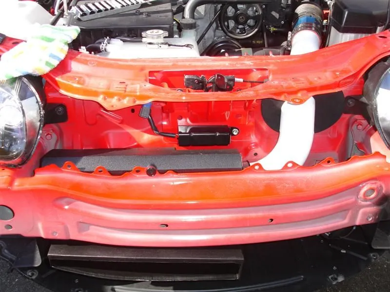

Took off the bumper, not too bad, some ways easier than the P5.
1st pic is the bumper off. Lots of empty space behind the bumper.

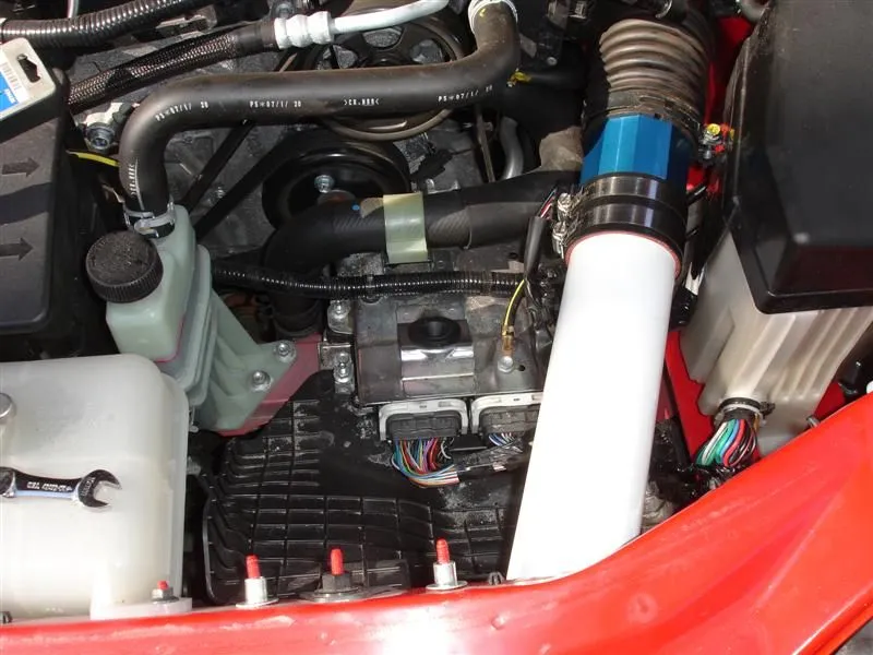

2nd and 3rd pics are the intake installed. Big empty area in the engine bay now.

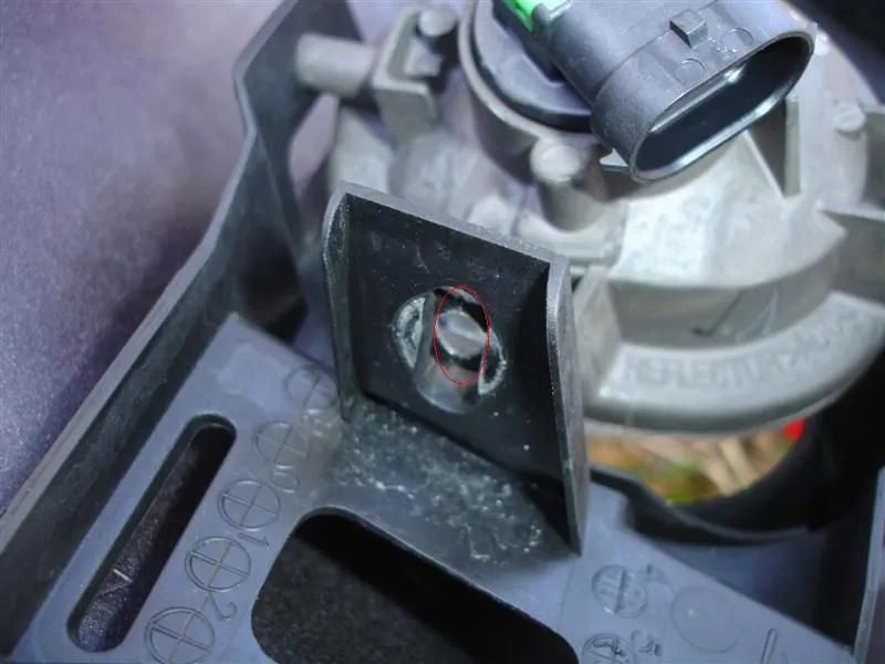

While I had it off, I wanted to adjust the foglights, the fogs had bolt in a slider to adjust the height. But when I loosened the bolt it would not move in the slot. When I took the bolt out there was a little plastic ring (red circle) preventing the bolt from moving. I trimmed it out and could adjust the fog.

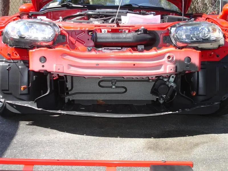

Will the bumper fit on the P5??

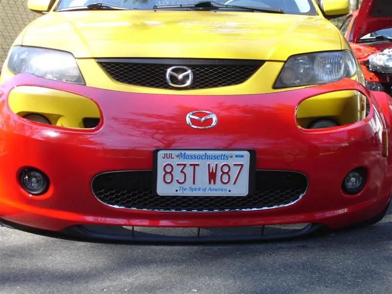

Autographed the inside of the bumper.

Similar to the stock 8 intake. Now what to do with all that open space? What color are the tubes? Looks great! Can't wait to see/hear it.

The tube is white, the MAF holder is a bright blue and the airbox is black.
