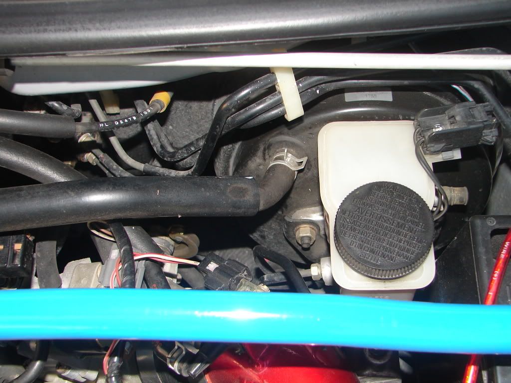

Im gonna give this a try tomorrow, not that I think my engine is dirty or anything but it cant hurt right? I was thinking putting alittle in through the brake booster and then the rest in the gas.
yea thats al i've ever done. i just changed my oil like less than 100 miles ago so i am thinkin about puttin it through the brake booster and gas this weekend b/c i forgot to do it b4 i changed my oil. then b4 i change my oil next time i'll stick some in the crankcase.

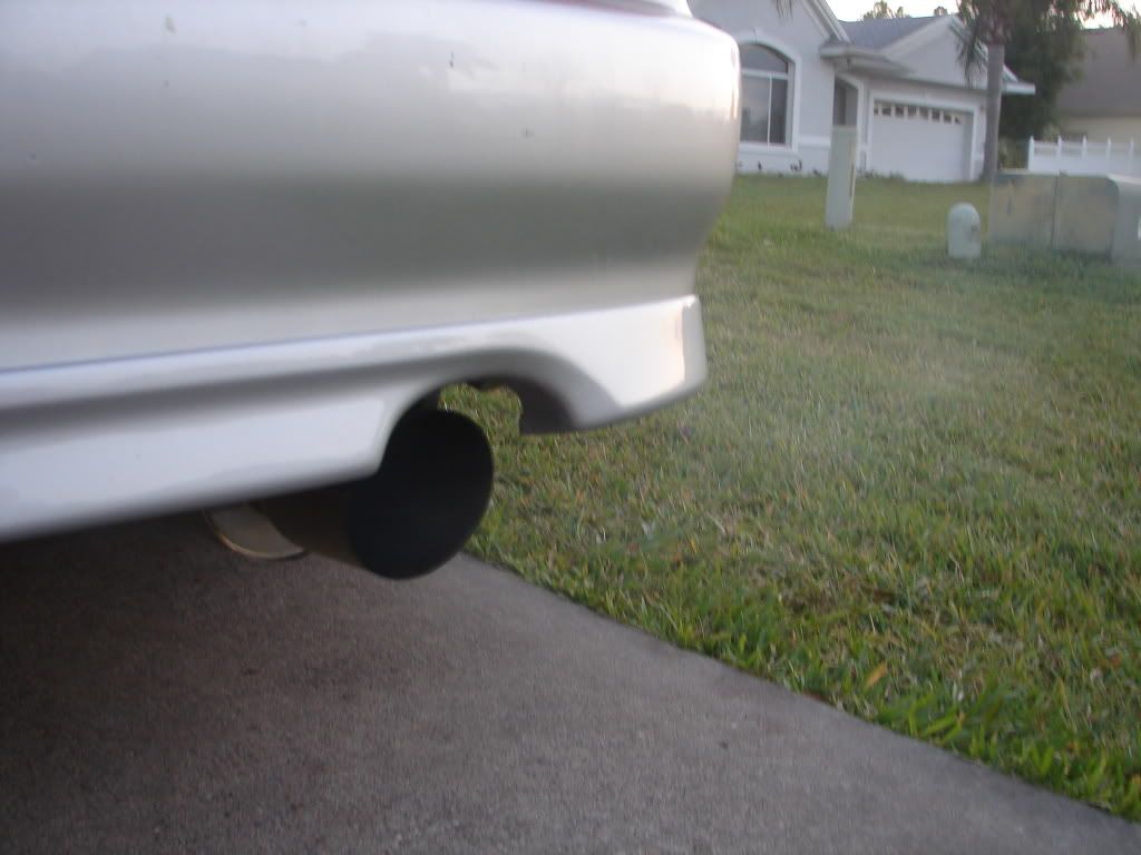

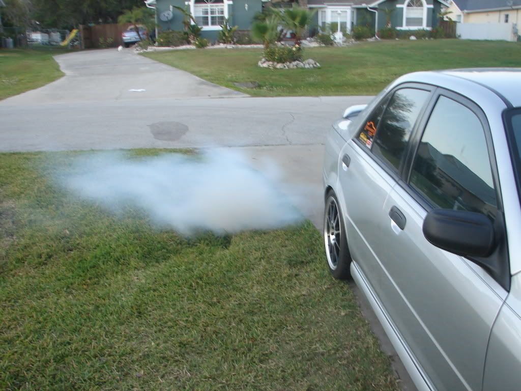

Well thats what that sam1 said he did, I dont think im up to that though. I keep my oil changed too often as it is. I acually just did the seafom treatment through the brake booster and the rest in the fuel. To be honest thats the first time ive ever had a CEL, its in the garage resetting right now:) I have some pics tho, I wanted my bro to record me trying to start the car up, and it backfired a bit, and after 3 tries it started, but he only seemed to want to get a pic of the stuff comming out of the tail pipe so thats what I got lol. He jacked what left over seafoam I had and tried to put it into his turbo disel truck, thing was, what he thought was a brake booser was a brake fluid line lol, he wasnt happy. Ive typed long enough now that my pics are uploaded, enjoy:)

Its definatley worth trying on a older car that isnt running right, but it cant hurt to help clean out any carbon deposits either. Not to mention its so cool to see your car "smoke" like hell for a few mins and knowing its doing good and not bad.

Jeg you just want to be able to call yoru car the silver smoke bomb! lol
I'm doing this along with many other things to my car on Saturday.. 1/3 of the bottle in the brake booster line, and the rest in the gas tank sound right?

For those of you with the MSP, I noticed that we aren't supposed to do this through the Brakebooster line. How have you done this process, and any other tips suggestions? I would like to do this this tomorrow as part of a 35K oil change, spark plug/wires change and general post winter system clean out...
