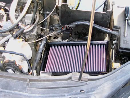

Also, as is obvious from the pictures, I have chosen to use the K&N replacement panel filter (around $40) which I had already installed before doing this mod. Using the stock filter should give you almost the same results, though the K&N does breath a bit easier.

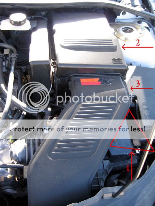

Remove the airbox cover.
To do this remove the three "Fisher-Price" screws and clips holding the little plastic triangle thingy (#1) connecting the battery box snorkel to the front apron. (Mine is permanently removed, but is represented by the outline marked #1 in the picture.) Remove the battery box cover (#2) and finally the snorkel (#3.)

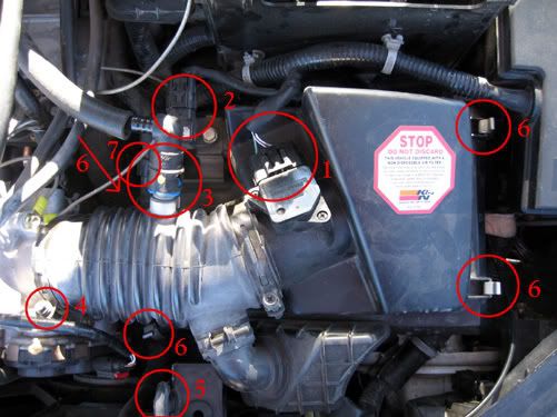

Next, disconnect the PCV hose (#3) by squeezing in the tabs on the blue collar to release and pull the hose off.

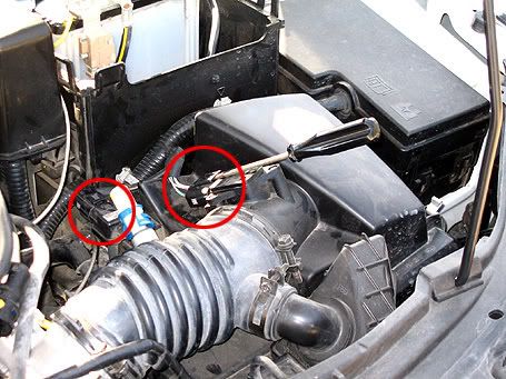

Disconnect the sensors (#1 & #2.) Using your flat bladed screwdriver helps to release and hold the clips.
Using the Phillips head screwdriver, unscrew the clamp (#4) @ the throttle body.
Release the four clips (#6) holding the top of the airbox to the bottom.
Release the small coolant recovery hose from the clip (#7) on the lower left side of the upper airbox, the throttle body hose (#4) and take out the upper airbox cover.

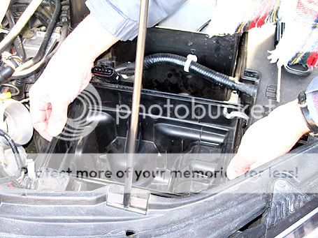

Remove the stock air filter from the airbox bottom.
Remove the bottom part of the airbox.
Pull off the rubber pull ring (#5) that holds the front of the box down.
Now that everything is disconnected, grab the bottom part with both hands and pull straight up. It will pop out of the two rubber bushings near the back of the box that hold it to the frame and away from the inlet duct.

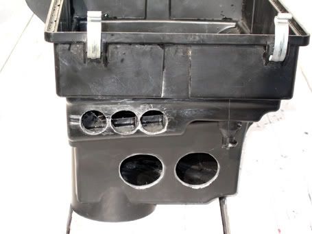

I was trying to drill my holes w/o compromising the integrity of the support structure of the box so three 7/8" holes on the far right (fender) side in between the reinforcements are about all you can do, unless you wanted to elongate them vertically.
Next come the two 1-1/2" holes on the right near the inlet duct. To maintain integrity, I decided not to connect these.

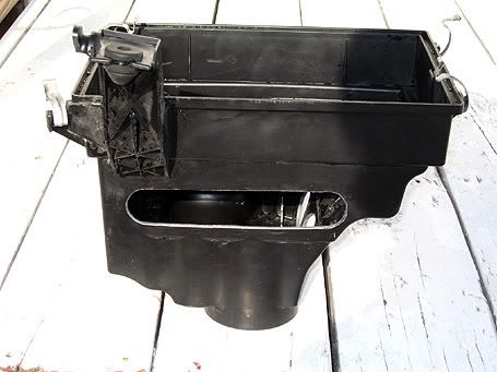

Originally, I drilled four 1-1/4" holes in the front then decided why not connect them and turn them into a long slot instead, so I used my trusty tin snips to cut out the excess.
If you're not lucky enough to have a decent set of hole saws on hand you might drill some pilot/access holes (3/8-1/2") and use your various blades here instead of the snips.
