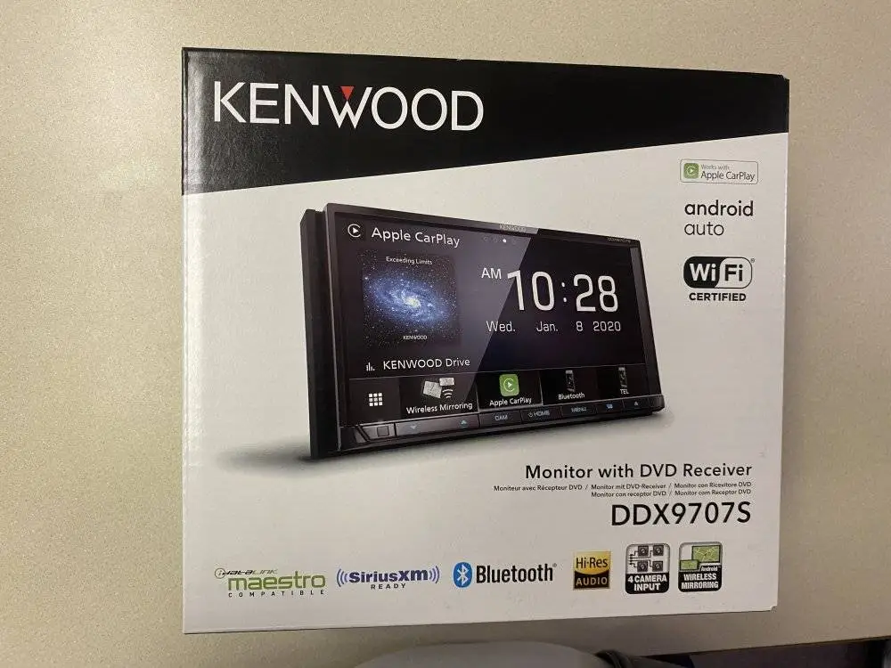

Now... anybody know how to put apple carplay into the same car? lol

I just started compiling the parts for my "navigation upgrade"; this is how I will be getting Apple Car Play (and a several other cool features).....
