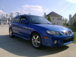

I noticed a few weeks ago that the headlights on my 2002 Protege5 were begining to get the dreaded haze that really makes a car show its age. The passenger side was not too bad, but the driver's side was extremely noticable. Another terrible thing about the haze is how quickly it spreads! Just within a few weeks it had spread to the whole top quarter of the lens. Ive tried Meguiars lens restorer product in the past on my work truck and sisters car and was very disappointed with the results.
I wasnt about to be driving around in a hazed up car, no way, so I decided to be a little more drastic this time. I decided to totally wet-sand and polish the oxidized portion of the headlight. This takes a little time, but not that much, and it is better than the alternatives, paying $300+ for replacements or an expensive kit if you can find one. I saw one online for like $50, ripoff.
I originally wasnt planning to write up a how-to, but I liked the results so much I decided to go for it. Because I wasnt planning on writing it up I do not have any before pics of the Pro5 I do however have an after pic here: http://www.msprotege.com/members/qualityrockola/headlights/PICT1868.JPG
It came out really well so I did it again on my '89 Ford F-SuperDuty work truck and took pics along the way. The work truck is a most extreme example of hazed nasty headlights. Its had almost 20 years to build up, sitting in the sun the whole time. This should work on any car you might have with plasic headlights. I think it will even work on tail lights or turn signals.
