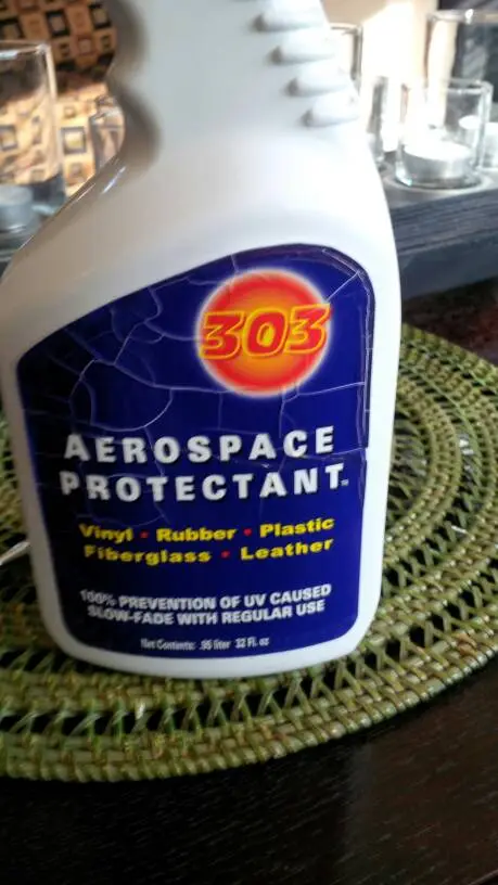

Another method would be to use a concentrated all purpose cleaner that you can dilute and place in a spray bottle such as Meguiars D103. 4:1 for heavy stains is used with a trim brush to scrub, a rag to wipe off excess, and a microfiber to wipe any incidental spray to the nearby painted surface. After it's clean then you can use another conditioning and/or protecting type product. I might use 303 Aerospace going this route for its UV protection, but any other similar product would do.

I've been using 303 Protectant, works great on the black trim. Seems to remove the white wax residue very well, plus gets all the water spots off the trim too.
