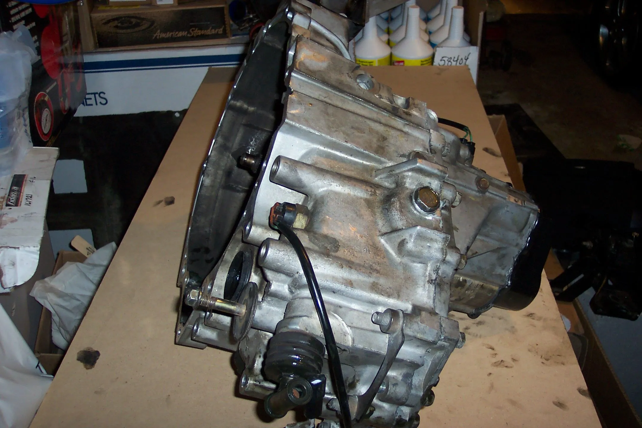

tranny is out!

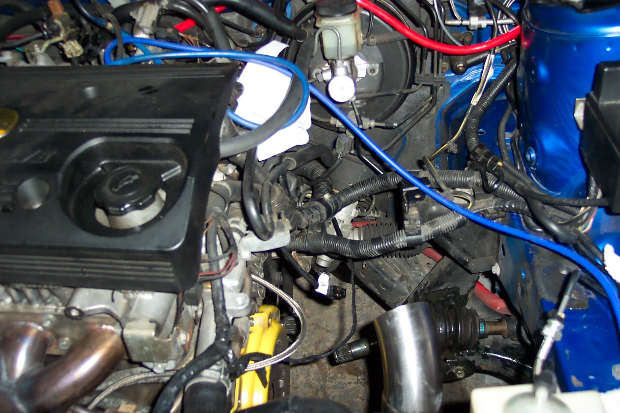

Here's a picture of my tranny out and you can see the clutch assembly (it's yellow) on the driver's side of my engine.
http://www.msprotege.com/forum/attachment.php?attachmentid=23087
