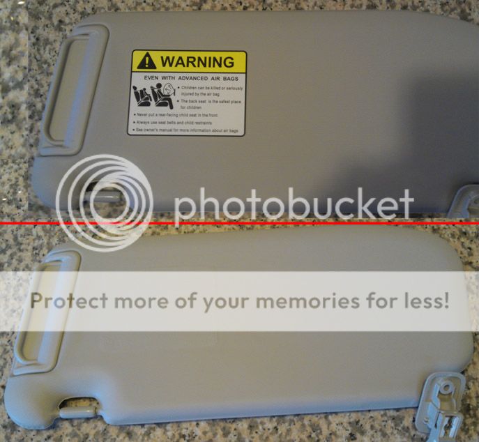

Also, this isn't a perfect, can't even tell they were there removal, but it was a significant improvement for me (see pics).
All you need is some mineral spirits (paint thinner) and paper towels.
You can still tell it was there, but it continues to flatten out, especially after baking in the Vegas heat for a while.

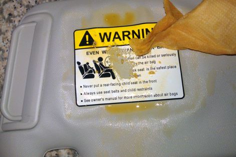

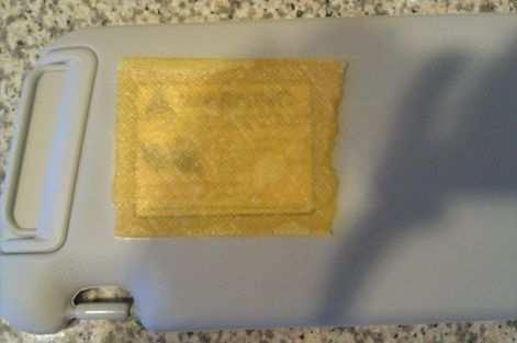

To start, place a paper towel over the warning and soak it in mineral spirits for a while (I did around an hour)
During removal, you can use your fingernail to scratch a little bit to get it going, then vigorously rub the soaked paper towel on the decal.
It should remove fairly easy, if not, try soaking it longer and as needed during removal.

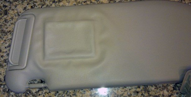

Note:The vinyl will get kind of floppy at this point when it's saturated, try to support it when your removing the decal so you don't stretch it out.

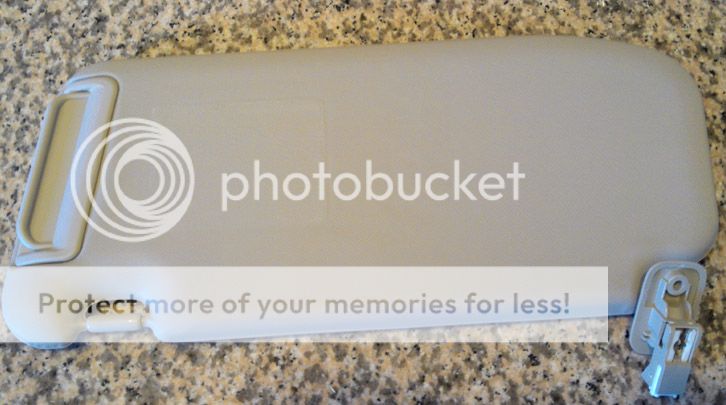

When you remove it all, it may seem like the visor is ruined, but fear not, it will tighten back up after drying out and baking in the heat for a while.
I stuck it outside in the sun under a towel (so it wouldn't fade) for a couple of hours:
I did my driver side a week ago and it has continued to get less noticeable to the point where I have to put a flashlight on it to tell there was something there.

going to try using Goo Off Professional strength.
A bit less chance of messing your visor finish

Tried it today with Goo Off, you can get more details just searching google for "Goo Off sticker visor"
Steps I took:
- remove visor
- pour Goo Off on paper towel, completely soaked the sticker
- stay for 5 min or about when the sticker is noticeable almost bubbling.
- take a sheet rock / box cutter and lightly lift up the edges
- should peel right off or in large sections
- if any edges left, lightly rubb off with paper towel and Goo Off
Took about 20-25mins for both sides. Yes, the visor may look stretched out like your picture where it appears ruined, but no fear it will slowly shrink. Within another 30 minutes it was almost back to original shape.
I will take some pics of final outcome shortly. GL
