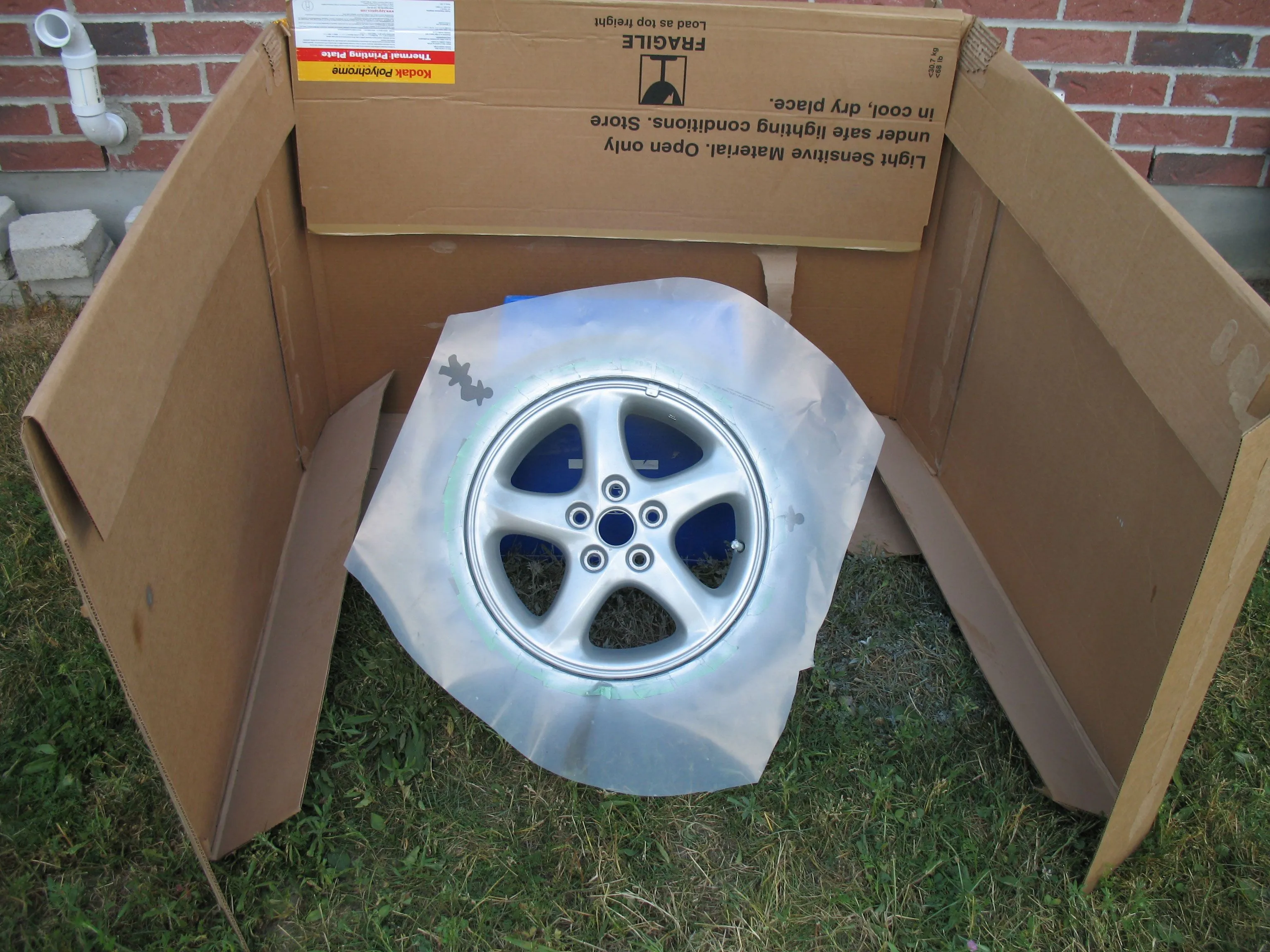

Thanks to all the great advice, the job went well. (canada)
Later on today I will post some tips of my own.
Prop the wheel up against something so that you are spraying with the can in an upright position. Otherwise the can tends to spit out globs of paint. :(
Start sanding the rust and loose paint with a coarse sandpaper first, then do an overall sanding with 220 wet dry.
You're finger tips may get sore during sanding if you fold the sandpaper over. Keep the paper side toward the hand and fingers.
Playing cards didn't work for me, I used painters tape and some plastic.
If I think of anything else I will keep adding. (thought)

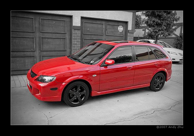

i just did mine the past week end and i just sanded it with 200 g then put 3 -4 coats of paint then a coat or two of clear coat. took me about 3 hours. the hardest part was sanding but even that was easy. here is a pic or two
damn that looks nice...
liljae8 said:
thanks!!! thats proly the first comment i ever gotten in this forum! thanks again!
hey no prob. man, i didnt know the stock rims had so much potential
dude that looks awesome...especially with the white car and black lip. do you plan on removing your roof rack and the window guards?
