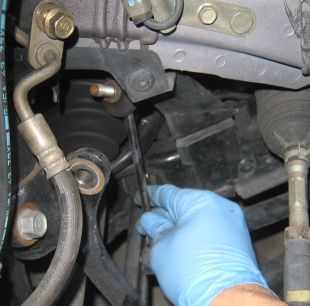

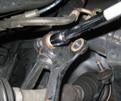

1. Unbolt the rear sway bar link from the lower control arm. The rear sway bar link protrudes through the lower control arm approx midway on the arm. Do this to both sides. This detaches the sway bar from the lower control arms. Look for pics of this in sway bar threads.
Tool: 14mm
Note: Earlier version of this How To showed photos below show the end link unbolted from the swaybar. This is not recommended because the endlinks can cause problems. It's better to unbolt the lower bolt (attached to the control arm).

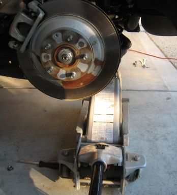

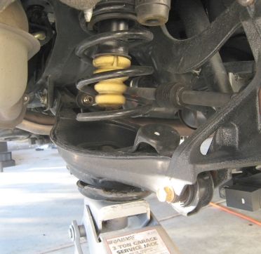

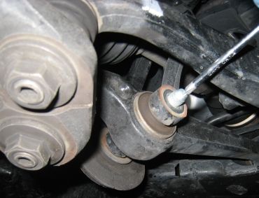

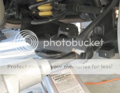

2. Place a floor jack under the large cup (actually the lower spring seat) in the lower control arm.
Tip: I found that positioning the jack perpendicular to the car (90 degrees to the driveshaft) seemed to make it easier to remove and reinstall the bolt in step 4.
3. Jack up the lower control arm a bit. This will compress the spring and takes some of the loading off the bolt holding the lower control arm to the hub carrier. The amount it should be compressed is somewhat subjective. See further below.

6. Lower the jack so that the lower control arm drops free of the hub carrier (the hub carrier is still held on by the upper control arm).
7. The spring will probably catch in it's lower perch (spring seat) so give the free end of the control arm a good kick down and inwards to force it to swing lower and release the spring. Also, twisting the spring back and forth (about it's long axis) seemed to work well for loosening things up at the top and bottom.
Tip: Make sure the endlink bolts are completely clear of the sway bar before trying to force to the lower control arm. I forgot to do this and damaged the threads on one of my endlinks.
Note: The rubber piece in the spring cup and helical groove with stop for the last coil of the spring. During re-installation, you will need align the spring to this stop.
8. Remove the stock spring by pulling down on it (the upper spring seat tends to grab it a bit). Again, twisting seems to help here a lot.

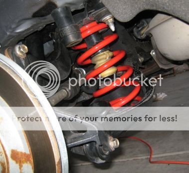

-----------------Reassembly-----------------------
Installation is reverse but things to watch out for:

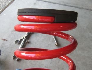

1. Spring has small and large end. Small end goes up (top as shown in photo).
2. Attach the upper spring seat (if it came out) to the new spring. It's obvious how it should go together. Be sure end of last coil is against the stop on the seat.
3. Rotate the new spring so that the lower free end (large end) sits properly in the lower spring seat. You can't judge this too well until you swing the control arm back up, jiggle the spring to get it over the cup and then start compressing it with the floor jack. Lower the jack and reposition the spring if necessary. You want to be sure the spring is properly seated. This is what people refer to as "clocking".
4. Eyeball the holes to try to best align them for the long bolt holding the lower control arm to the hub carrier. Jack the arm up and down as required, using the floor jack, to get the best alignment. You may have to help the bolt in with a few blows from a hammer.
5. Do both springs for both sides before reattaching sway bar end links.
Note: Earlier version of this How To showed the end link detached from swaybar (this is not recommended). If you did this, see tip below:
Tip: If endlink nut will not torque down, then you can use an allen wrench and box wrench. Notice the end link bolt is keyed for an allen wrench. This happened to me on one side and I found the nut was finger loose after a couple of months (not good at all). I had all sorts of strange creaking noises a low speeds (parking lots, stoplights etc) which sounded like they were coming from the front end. After tightening the offending nut, the creaking went away.
WRONG WAY to Detach End Link
6. Photo shows spring after installation.

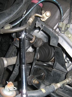

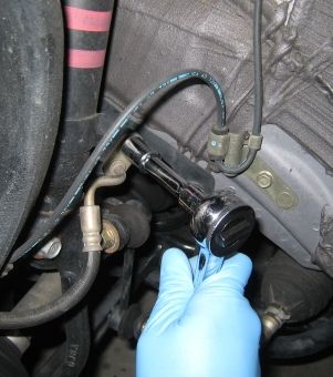

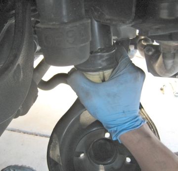

1. Remove bolt securing front brake hose bracket to curved suspension upright.
Tool: 12mm

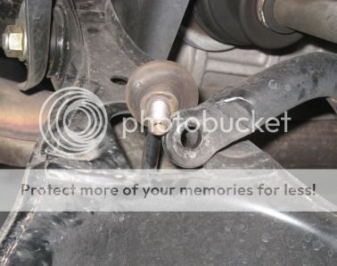

2. Remove the nut securing the sway bar link to the shock/spring assembly. Do both sides.
Tool: 14mm, wrench or socket

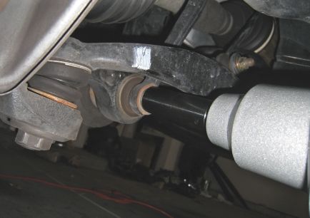

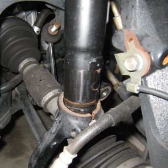

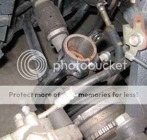

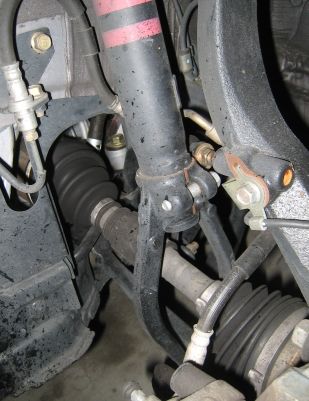

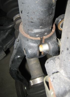

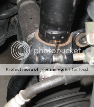

3. Study the lower part of the shock/spring assembly. Notice that it's a separate piece, with a cup shape on top and a fork below as it wraps around the lower control arm.
------------Steps #4-#7 (start)--------------
Below are two options for the next few steps (4-7). The difference is the sequence to remove the shock/spring assembly. Option 1 was from Super Car's original instructions and Option 2 was an alternative that I experimented with. Each has its pros and cons and roughly equal in difficulty but I found option 2 slightly easier.
Option 1
4. Remove the bolt holding the fork ends to the lower control arm. There is also some kind of damper assembly connected to this.
Tool: 17mm (impact wrench recommended)
Tip: This nut is very tightly torqued plus probably corroded. Impact wrench makes things MUCH easier. Also, it may be necessary to tap out the bolt to remove it.
5. Loosen or completely remove the upper bolt that cinches down the cup assembly. Notice that the end of the shock body has a ridge to fit into the slot in the cup.
Tool: 14mm, ratchet with long extension helpful here
Tip: Twist and pull down on the fork until the fork is pretty loose and nearly ready to come off.

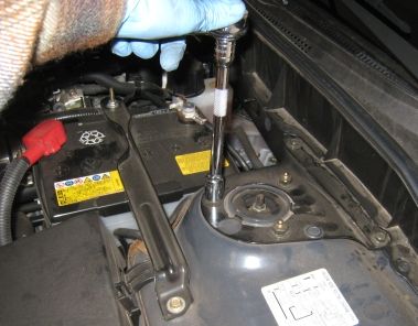

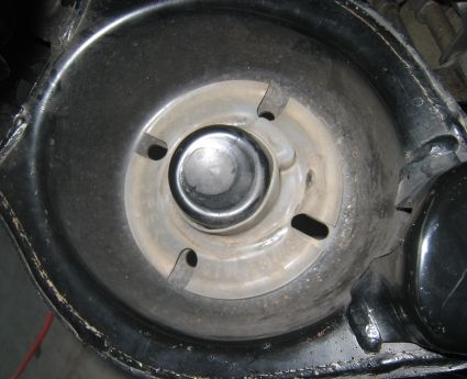

6. Remove the 3 nuts securing the upper part of the strut. These are located inside the engine compartment. Have somebody hold on to the strut assembly from below so that it doesn't just fall down (you can hold the strut with one hand while using a ratchet with the other).
7. The whole assembly will drop down a bit now, as the lower fork can slip further past the lower control arm. Wiggle the end of the shock body out of the cup.

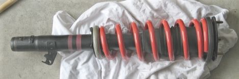

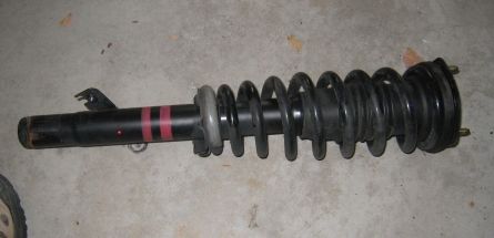

8. Remove the spring and shock assembly from the car.
9. Make a note of the position of the studs on the upper plate to the shock body. One of the studs has to align with the ridge at the bottom of the shock assembly when reinstalling, otherwise things won't line up.(Also, I noticed on mine that there was a hole in the upper spring plate that seemed to match up with a hole in the body of the car. Make a note of this to try to reinstall the same way. Not sure what this is for but might as well re-install it the same way.)

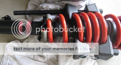

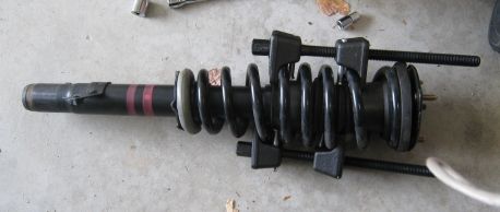

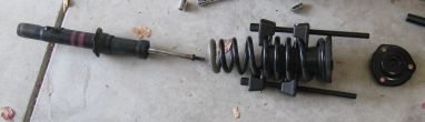

10. Use spring compressors to compress the spring. Do this enough to take force off the upper spring seat/perch/bearing.
Tip: Make sure the spring compressors are exactly opposite each other; otherwise, spring will get cocked as you compress it (this is more important when installing the new springs). Also, if you want to avoid marring the powder coating of the springs, you can put something between the hooks on the compressors and the spring. I used some thin rubber strips that I laying around the garage. The marks are small and don't impact functionality but if you care, then it's easy to prevent.

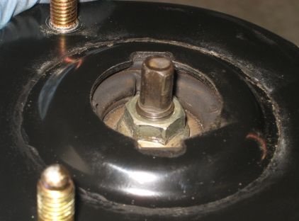

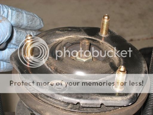

11. Study the nut on the end of the shock shaft on top. Notice how many threads are sticking past the nut. Ensure shaft protrudes same amount when reinstalling. This nut appears to set the pre-load on the bearing assembly.
Tip: I found it helpful to take a high resolution digital photo of each side as I went along (check it by zooming in to make sure it's clear). I did this because my short term memory sucks and because it will be awhile before you get back to this step again during re-installation.
12. Remove the top nut securing the end of the shock strut to the spring seat. This is usually almost impossible to take off with a wrench or ratchet, as the shock shaft will just spin if steady torque is applied. Two options here (1) Impact wrench and (2) two wrenches – For me, Option 1 only worked on one side so I had to use option 2 for the other. I would probably recommend option 2 especially during reassembly.
Tool: 14mm for nut
* Option 1 – Impact wrench: The usual method is to use an impact wrench, as the sudden impacts break the nut loose before the shaft can spin. .
* Option 2 – Crescent wrench and open end wrench: There are two flat spots on the end of the shaft that you can lock onto with the crescent. You will need to angle the open end wrench. Turn the crescent while holding the open end wrench stationary. Also, you can use needle nose vise grips instead of a crescent but it can leave marks on the shaft.

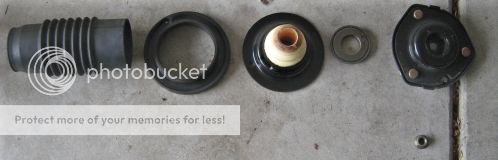

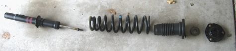

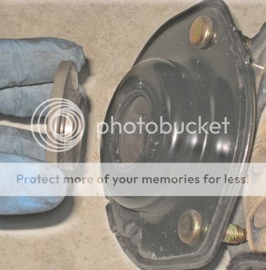

13. Remove the top plate/spring seat/strut bearing assembly.
Note how everything assembles. There's a bunch of parts that you can lose track of if you're not being attentive. In the next two steps, there are a few photos at various stages of disassembyl for your reference.
A. Shock, compressed springs and mounting plate.
B. Bearing assembly removed from mounting plate
C. Note how bearing assembles to the mounting plate (boss of bearing is male and hole of plate is female).
14. Remove the spring and release the spring compressors.
A. Exploded view of entire shock/spring assembly after releasing compressors
B. Shock boot separated from bump stop assembly and rubber spring seat
15. Shorten your bump stops if you're going to do so. A hack saw worked pretty well for me.
16. If you want, remove the gray piece of plastic/rubber on the small end of the spring for use with the new spring. It prevents metal on metal contact between spring and bottom spring seat (on shock). It's attached with some rubber adhesive but comes off fairly easily. Just be careful not to tear it.

2. Make sure spring is compressed enough to allow upper top plate/spring seat/strut bearing assembly to seat all the way down fully.
Tip: Be sure to attach spring compressors on exactly opposite sides of the spring. Misalignment here will make it harder to attach mounting plate.

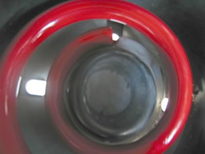

3. Make sure end of coil sits properly in lower spring seat. This is the smaller end of the spring.

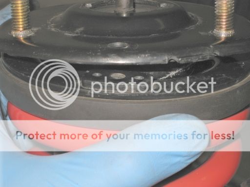

4. When reassembling the upper spring seat, you'll notice that the top end of the OEM spring was ground flat; whereas, RPM springs are not. When reassembling things, you'll have to decide whether to re-use the indent created by the OEM spring or not. I have no idea which is better but I chose a virgin spot on the rubber because the original indent looked a bit stressed with small cracks. I think this could be an factor of the differing reports of "settling" after a spring install. For example, someone using a virgin spot like I did might see more settling over time as the rubber got deformed than someone who the original indent which is already fully deformed. This is just speculation so take it for what it's worth.
5. Align the mounting plate to the plate attached to the bump stop before tightening the top nut. Ensure shock shaft protrudes from top nut the same amount as original (step 11 above) when reinstalling. Use either an impact wrench (option 1) or two wrenches (option 2) method for securing this nut. I found Option 2 allows for easy fine tuning of the final position of the nut but plenty of members have reported using the impact wrench only. You choose. Refer back to the photo you took in step 11 if you have it.
5. Check alignment of top plate (hole in plate, stud to ridge on shock body, as noted in 9 above) before releasing spring compressor. If you don't do this you will have to recompress the spring to free up the upper plate, as it's impossible to turn once there is pressure from the spring.
