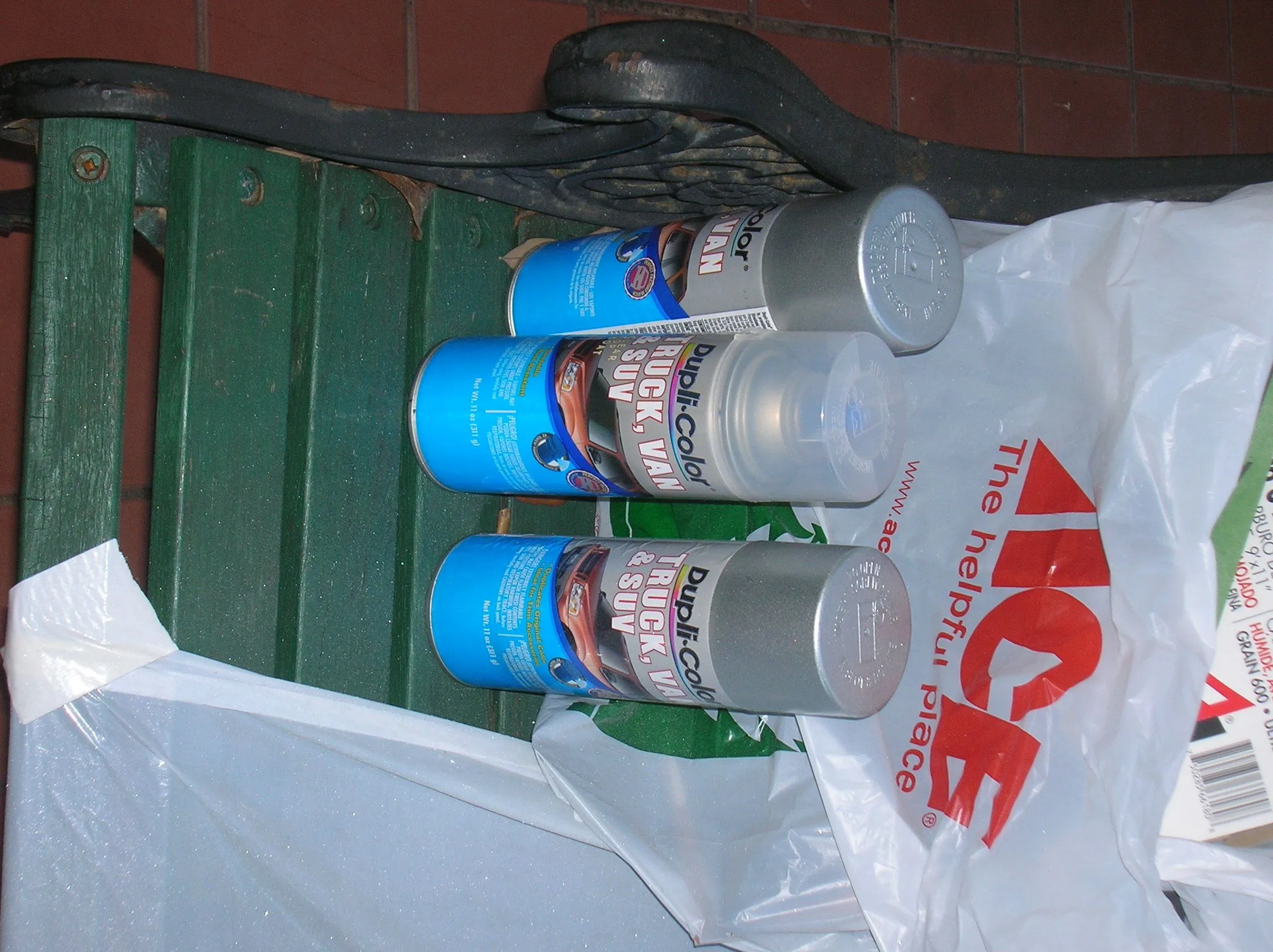

here u go

I just did the primer and basecoats last night at work, and I am letting them set to do clearcoat later today. My question is, should I sand the base (color) coat any before clearcoating? I am afraid I will screw it up and it will look bad, but it feels rough to the touch now and you can see some rough spots (if you tilt it and look in certain light). I'm a total noob at painting, and I'm afraid I will take off too much base and will have to go back to repainting that. I have 320 and 600 grit sandpaper. What should I do?
You could try the 600 grit but i have a feeling you'll need to get some sort of sandable primer to than sand that to get it nice and smooth. You might as well try the sand paper on what you have now and hope for the best.
I tried sanding the basecoat and it didn't turn out well, requiring more base to be layed down. Oh well, it doesn't look that bad, and I am hoping that once I get enough clear on it will look better.
