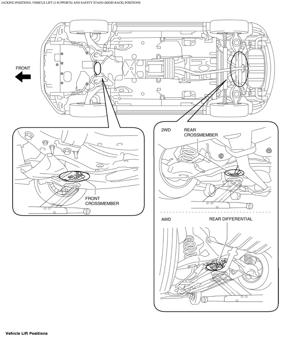

I read through the thread, and also checked my under-body yesterday, and read the workshop manual. Still need help on where to lift on the rear.

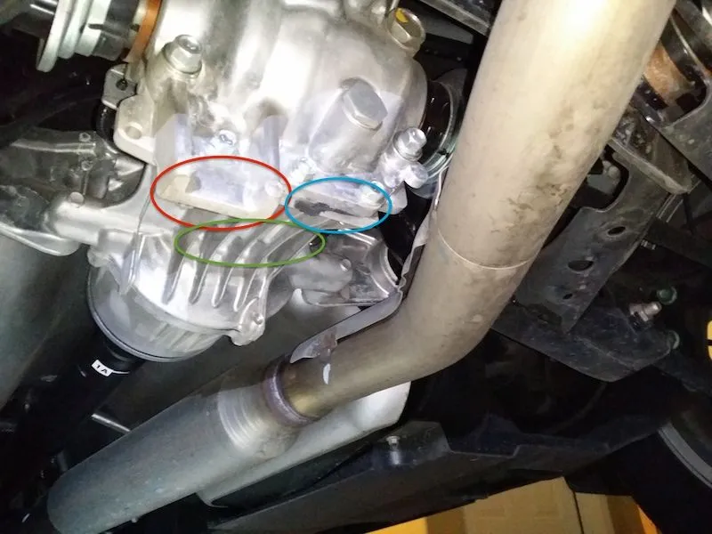

So, here's an actual photo from my rear (AWD). Which place do you use to jack up?
Red or green or blue? I think it's the red part as it looks most thick, or at least it has some flat area. And seems like it fits the description of a "pinch-weld". (had to look up google picture for that type of weld)

Good god man, isn't that the rear diff? If you try to jack your car up there it could be a VERY expensive mistake.
Seriously, the manual CLEARLY shows on page 7-9 that the jack point is at the OUTSIDE of the car near the rear tire, NOT in the middle.
[EDIT] It looks like there is a household door in the background of your photo? The proper jack point looks like it is way out where the car outline meets that door.
I would use the factory jack point when using the supplied jack should a roadside tire change ever be necessary. In my shop I use a floor jack on the protruding piece pictured in the photo (red circle I believe). I can change both rear wheels with one jack procedure. The rear differential is plenty well supported for this.
What are you talking about? That's what the workshop manual says, to jack up the rear differential. I just didn't know for sure which exact area it is because it's not flat when I creeped under.
See attached.
I have a low profile floor jack, so I was thinking of lifting the center, then placing two jack stands (a little bit front of the rear tires) on the two sides for support. Then lift the front center on the area specified in the workshop manual, and put two jack stands on front sides.
So I'll probably have to make some kind of an adapter or something for the red circled area. Or do I? Should I just use my floor jack to jack that up? It's so shiny, it looks like scratching it won't do any harm related to rust.
