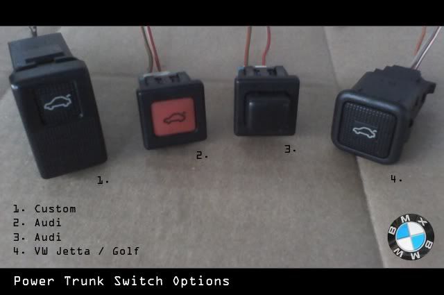

Momentary Switch - switch that's on only when held down

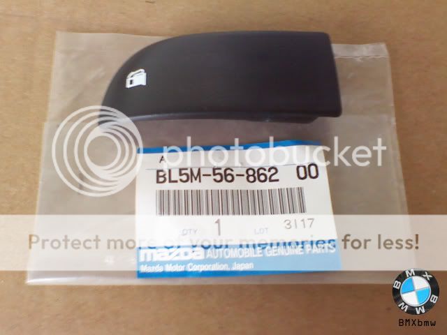

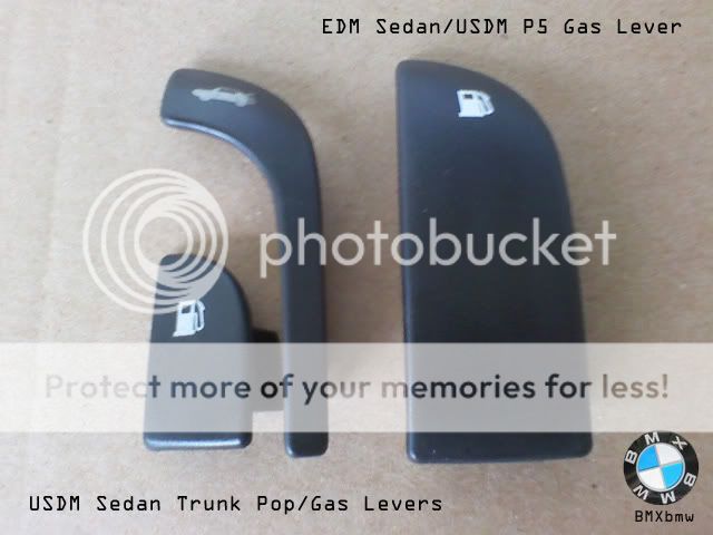

P5 Gas Lever

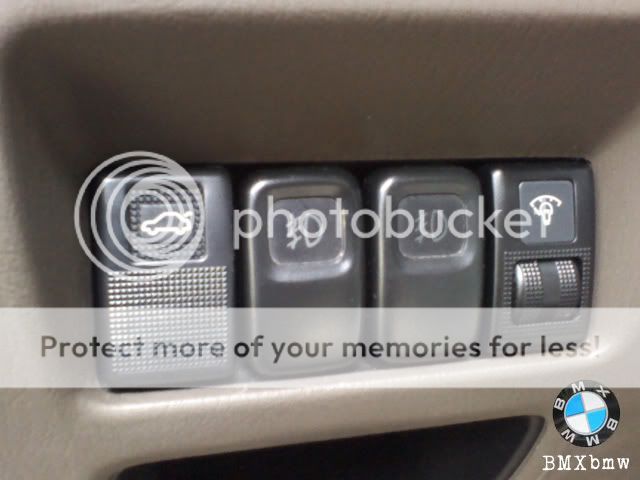

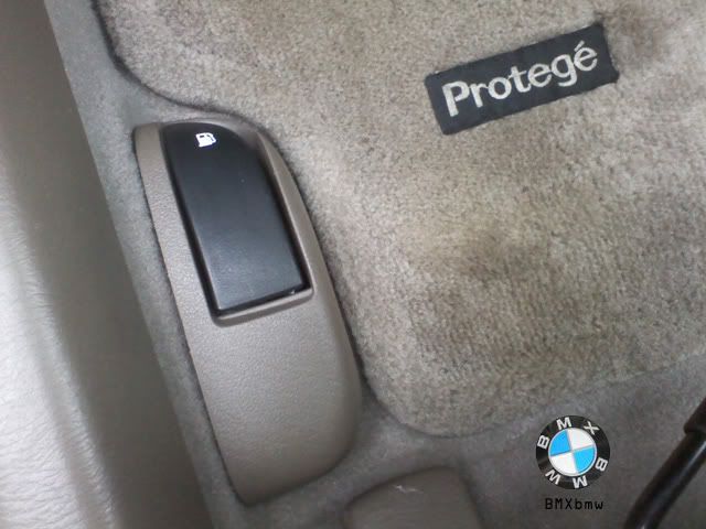

First, you're going to need a power trunk. Youll need to find a spot to mount a switch. The switch blanks are a good spot. If you have fog lights, to prevent accidental popping of your trunk I recommend mounting the switch away from the fog light switch.

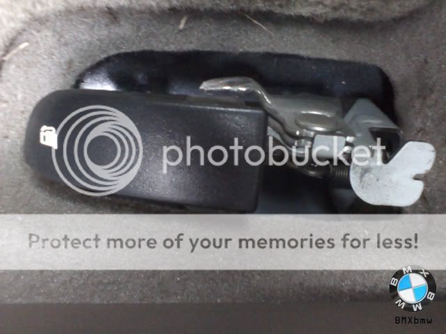

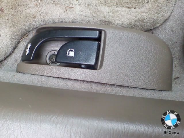

One end of the rod should be a small 90 degree bend and the other end should be a hook. Where the glow in the dark pull tab attaches to the latch is a nice spot to attach the rod. Remove the pull tab. Now youll have a location for the rod to connect to. Connect the 90 degree end of the rod to where the pull tab used to be connected. Get a feel for where the actuator needs to be to fully pull the latch. Watch the latch while you pull the rod. Pick a suitable location to mount the actuator where the rod pulls the latch all the way.
Connect the hook end of the rod into the actuator and connect the 90 degree bend end into where the pull tab was. Hold the actuator and give the rod a few pulls when youre picking a location to mount it. Verify you have it in a good location before you start drilling.
