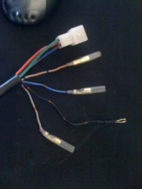

So since there are not a lot of pic's i don't know where exactly too hook everything to and which wires go where someone please help =]
from memory the three wires with the white plastic are the main ones, accessory, constant, and 12v. i clipped of the harness and used the wires per the write up. i think the brown one with the terminal end is the ebrake sensing wire.
The brown one should be for e brake the extra blue for speed sensor the black ground and the other one - thats new to me.
