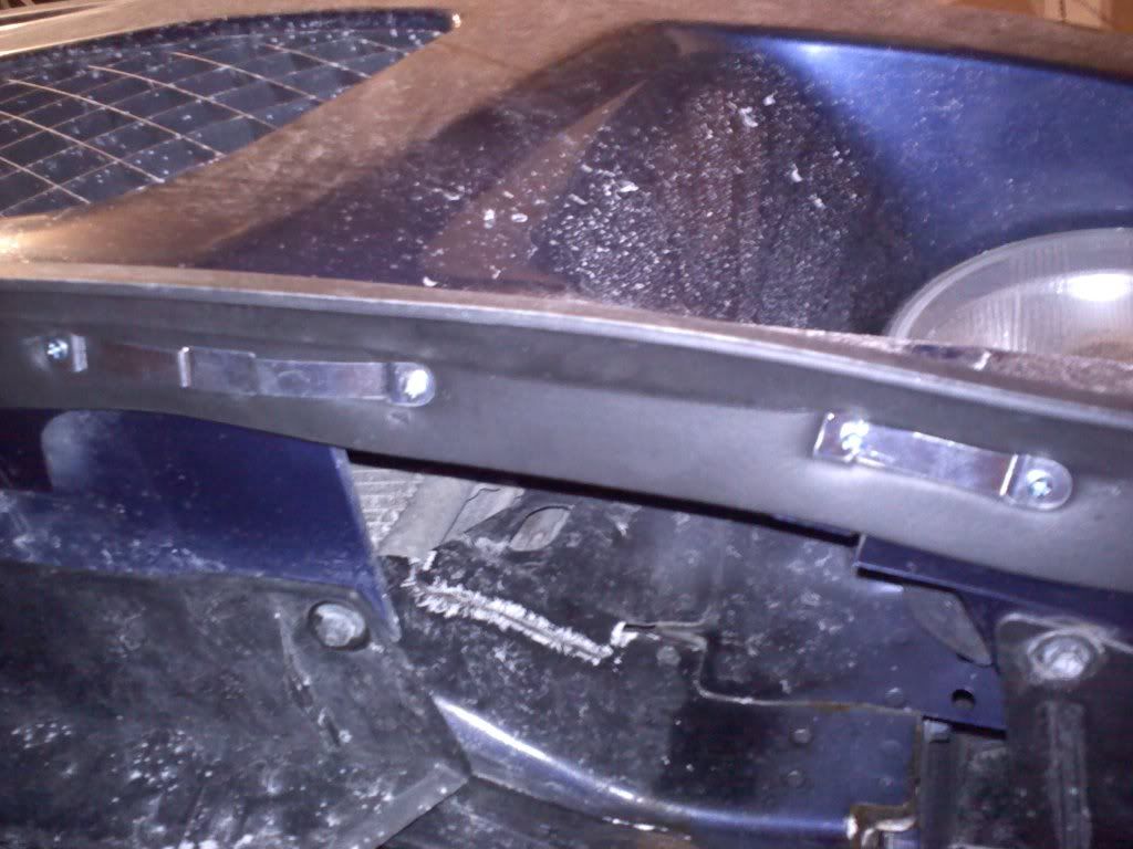

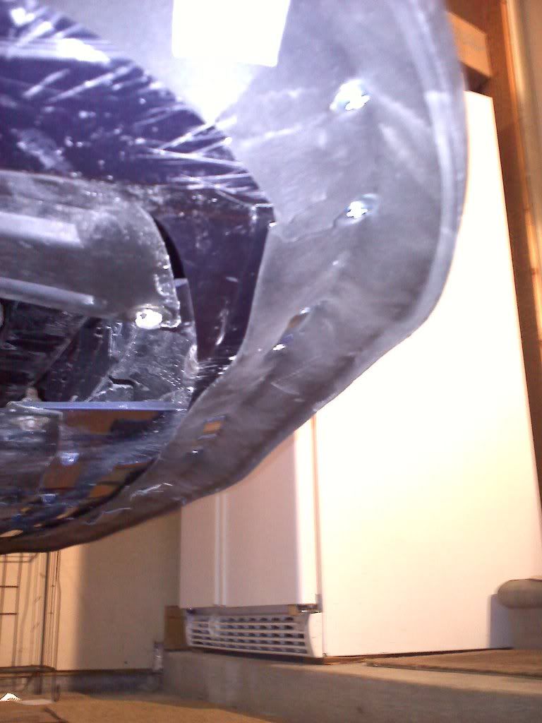

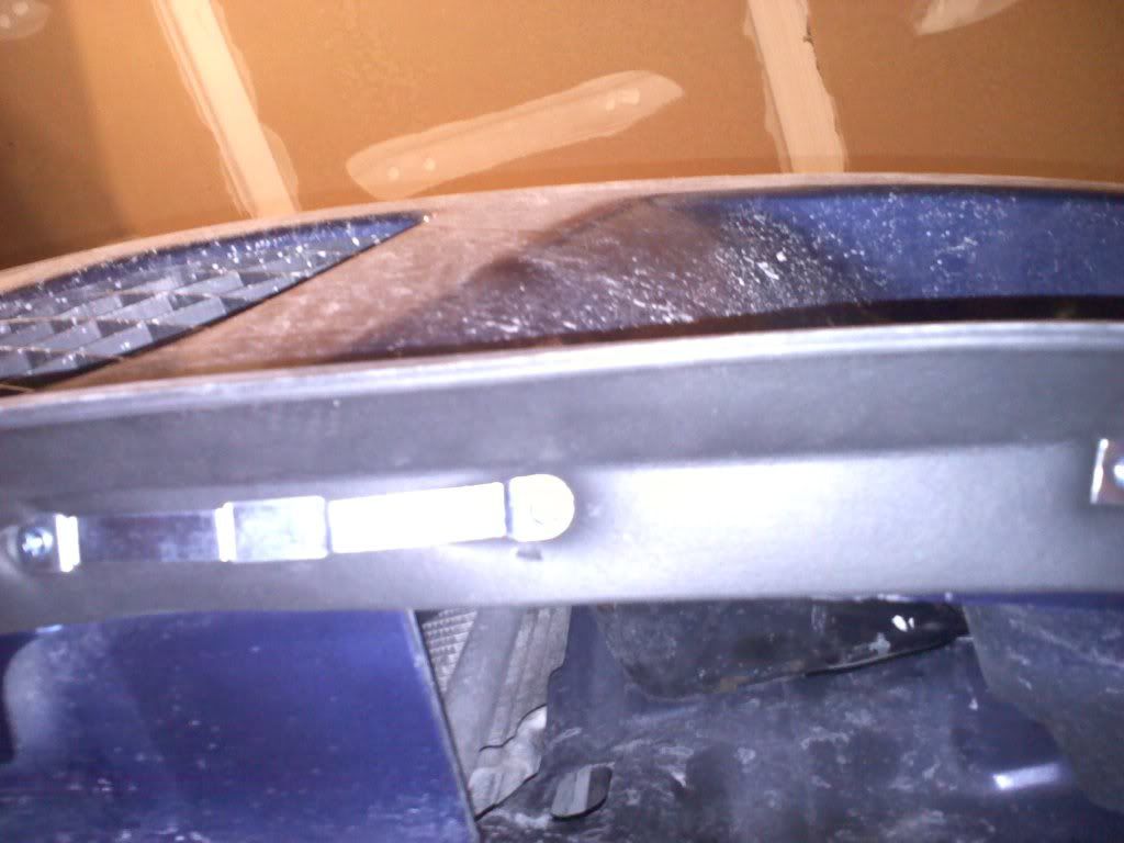

Ok, I just finished installing my own HD Lip
(sorry the car is extremely salty, I'd have to wash it every day to keep it clean - hate Michigan winters, it always make s working on cars a pain)

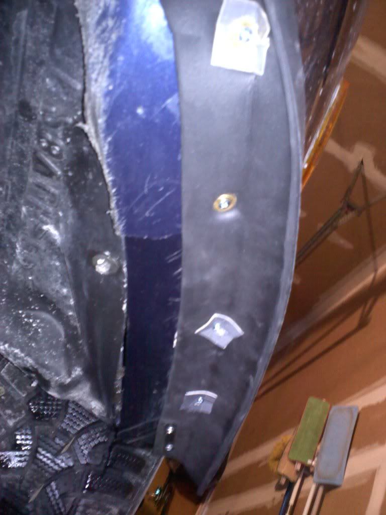

So i used just screws and some things i could find around the house to hold them very steadily in place

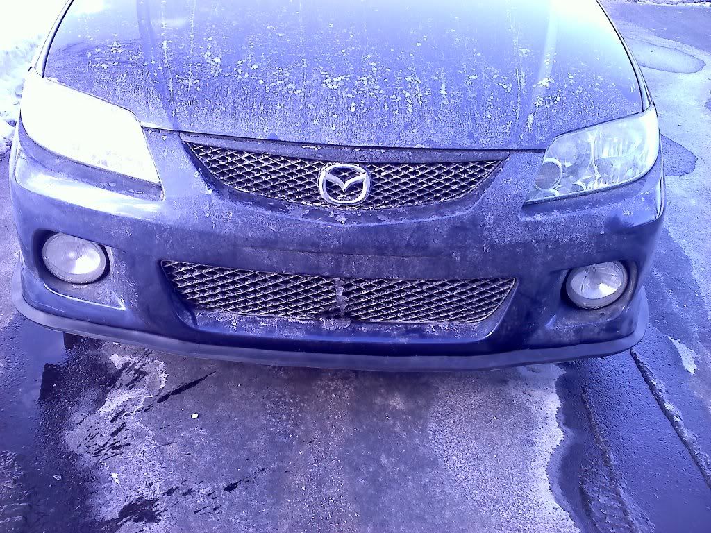

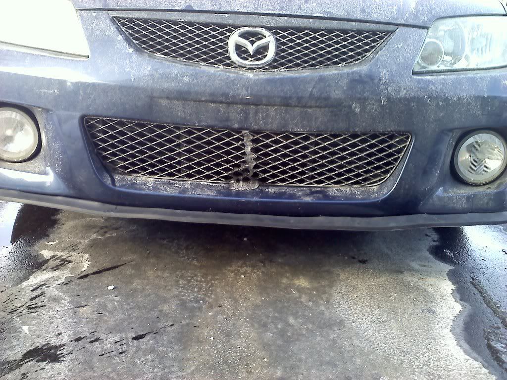

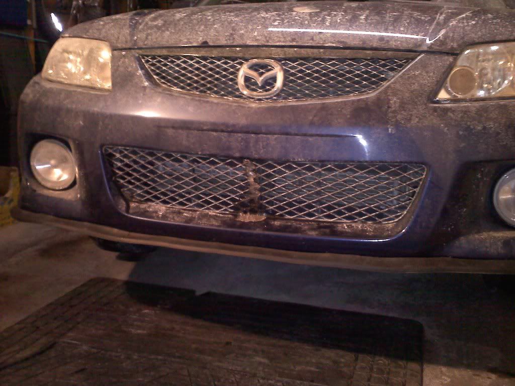

And pics of it from a distance
I like it... (might need some touching up, but I already skipped doing some school work for this,
so thats enough for one day...took me over 1.5 hrs to do it with the car on jacks)

Just remember that whenever you try to stick TAPE to something, you have to make sure that you are applying it to a clean, dry surface. It will stick to some surfaces better than others, but it should stick to plastic pretty well. As far as the curves of our cars, you just have to work it into a curve. The tape is pretty stretchy - for lack of a better word. Just keep trying to work with it. The hardest part - that I encountered - was trying to put the self tapping screws in once the tape and door skirt was on. It got frustrating as all hell, but well worth it in the end. IMO.

yea, dont bother trying, you wont be able to get it to stick. wasted my money on the rolls of that tape and ended up balling/throwing both of them. just buy a good 25 or 30 self tapping screws and washer that fit inside the screw to hold up the lip better. my screws were about a inch tall.
