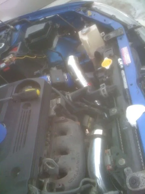

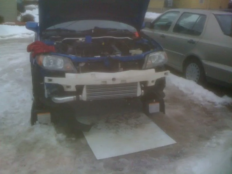

I think I'm going to do this in the summer. How much cutting did you have to do Wagon? Just what is shown in the pictures (the black plastic "shielding" on the under side)?
that and the little tab that was in the way of the cold pipe under the headlight.
but as I said in the OP, I don't recommend my hot pipe routing.

I believe you'd have to cut a chunk out of the crash bar. thats what stopped me from copying that cold pipe routing (I even had a turbolife cold pipe)
the fogs are probably half your battle, I know dub cut a good chunk of his fog buckets, but its hidden by his lip. I didn't trim anything, but it all barely sneaks on and isn't exactly all properly aligned. My cheater hot pipe routing probably helps there too. lol

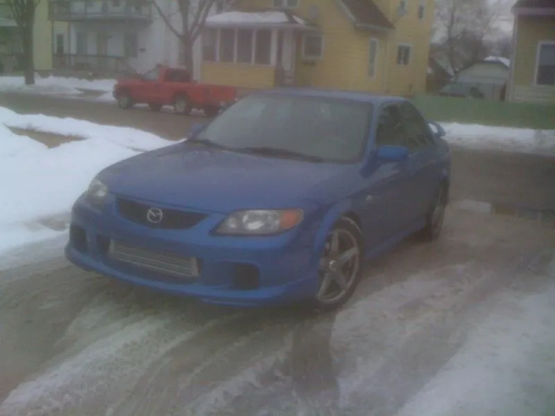

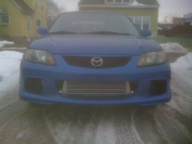

I just can't wait for summer so i just did this. I WILL TAKE SOME MORE PICTURES LATER
