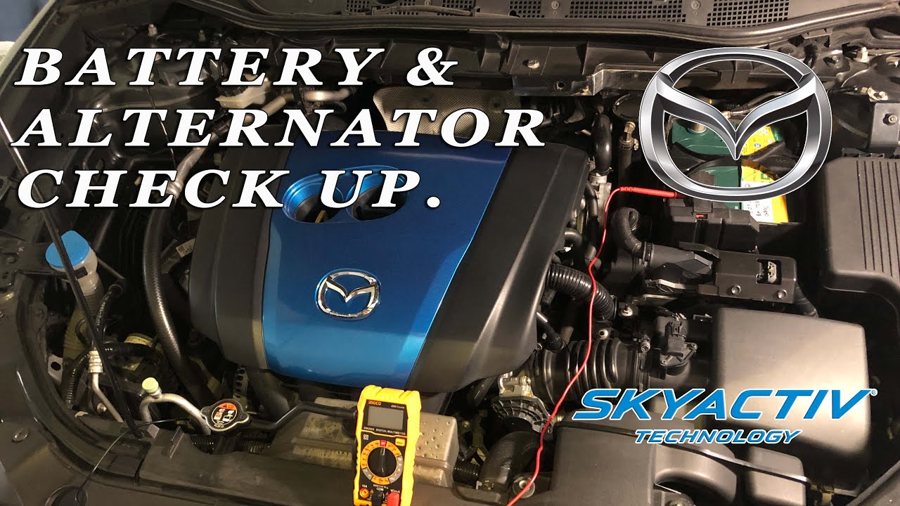

2013~2016 How to check battery health and the alternator on your CX-5
Hi guys, been awhile since I have not posted video. I'd like to share with you basic tip that anybody can do to their car or Mazda CX-5.
How to check the health of your car battery and alternator using a multimeter. Basic and quick.
And i have added a Quick video on how to measure the Alternator voltage drop test.
