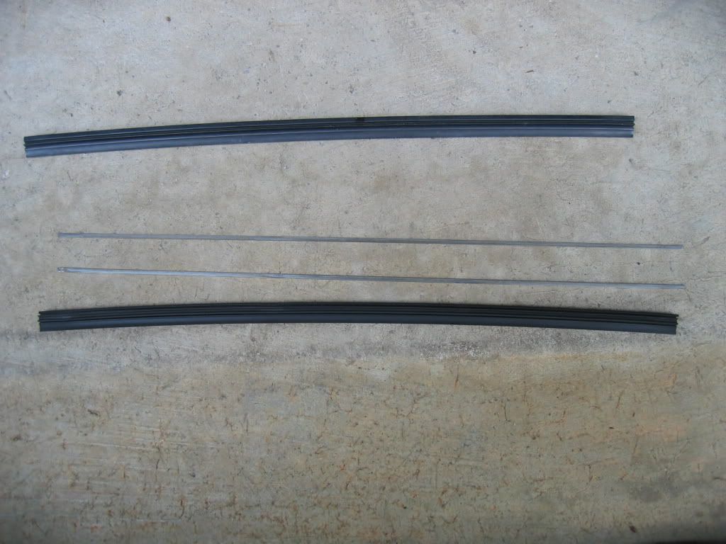

So I went to my local Discount Auto and purchased two rubber blades (for around $5 or so) that you can cut down to size. Make sure they have the two metal strips since you cannot use the metal strip from the OEM rubber blade. You may be able to find a rubber blade at your local auto parts place that looks like the stock one, but I couldn't.

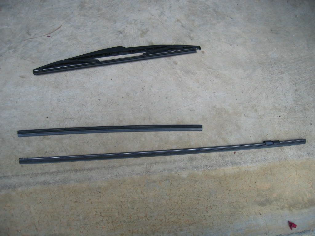

Picture of the stock rear wiper blade:
Picture of the rear wiper blade and the one I purchased:
Cut down the new blade and the metal strips to match the stock one:
Seat the metal strips to the new rubber blade (the metal strips can be finicky to keep the slots/grooves, so be patient):

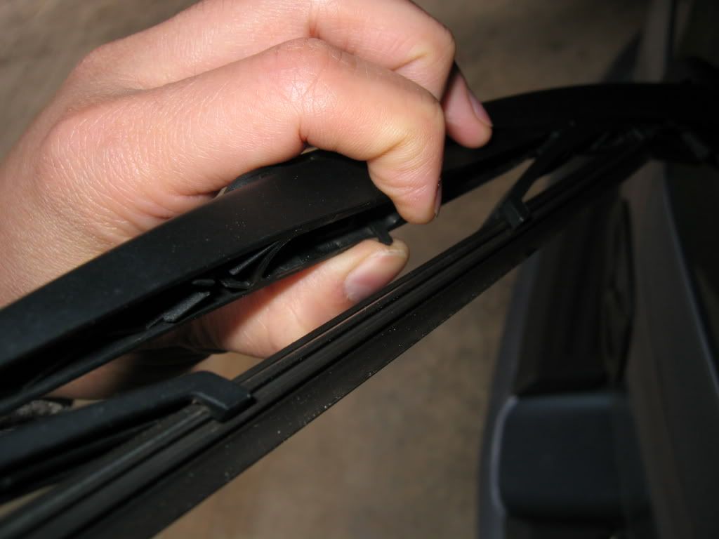

Next, slide the blade into the wiper slot (start from the 2nd slot on one side and work your way to the other end - leave the very end slot open for now):
In this pic, I am working the blade from right to left:
Leaving the last slot open - then you bend the blade and the metal strips a little to fit it in:
