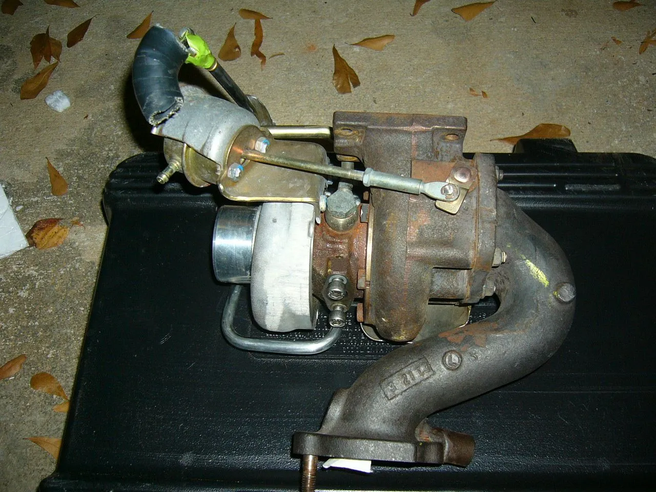

A manual boost controller can't do anything to lower the boost.. at all. It can make the turbo spool slower, making it feel more laggy, but that's about it. The wastegate actuator sets the minimum. If you want to go lower than what the stock MSP has, you'll need to source a different wastegate actuator. ATP Turbo sells a couple for the MSP turbo but I think they are higher PSI than stock. If your wastegate has an adjustable rod on it you can also adjust it so that there is less preload on it, which might reduce the amount of boost made but can also have the effect of making it a little laggier.
is that an adjustable one?

And yes that is adjustable. You can fiddle around with loosening it to see how that performs, though I don't know how accessible the adjustment will be once it is mounted on your car.
Kansei said:
At least you never have to worry about bending rods on your auto.. I'd rather blow a tranny than an engine any day of the week.
Pardon my dumbness, but would loosening or tightening it lower the boost? or shall I say making it longer or shorter lower the boost?
I believe shortening it will lower bost sense the actuator will have less travel and be more responsive...
