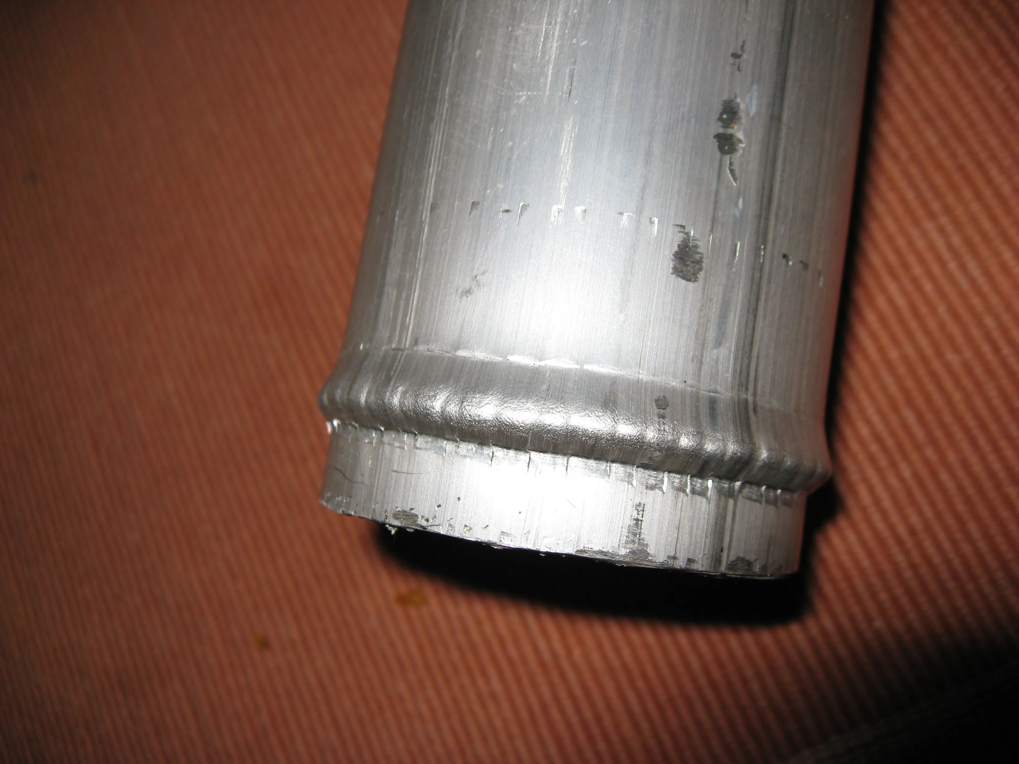

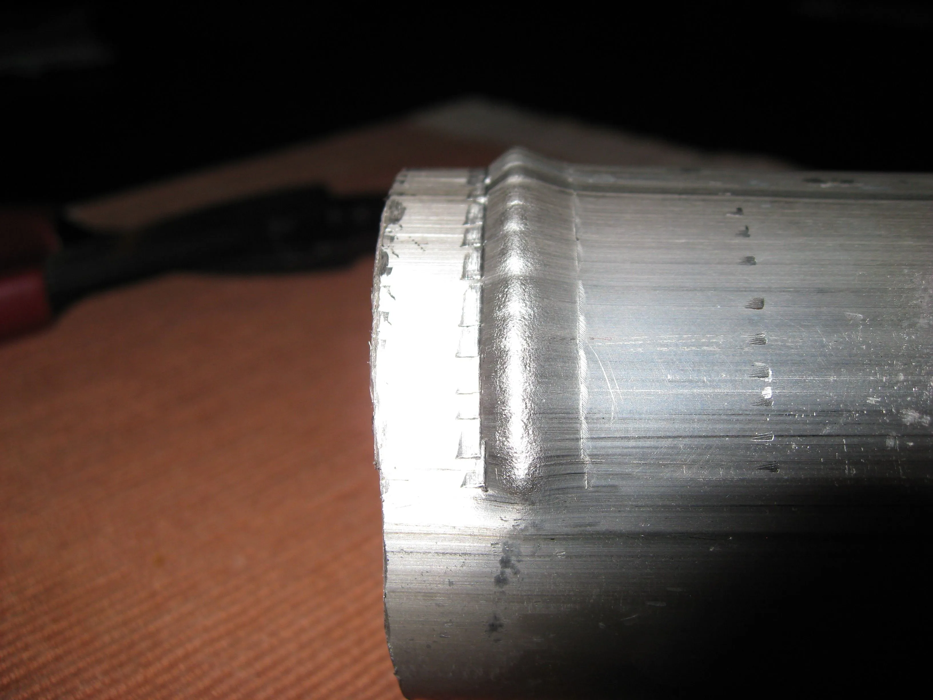

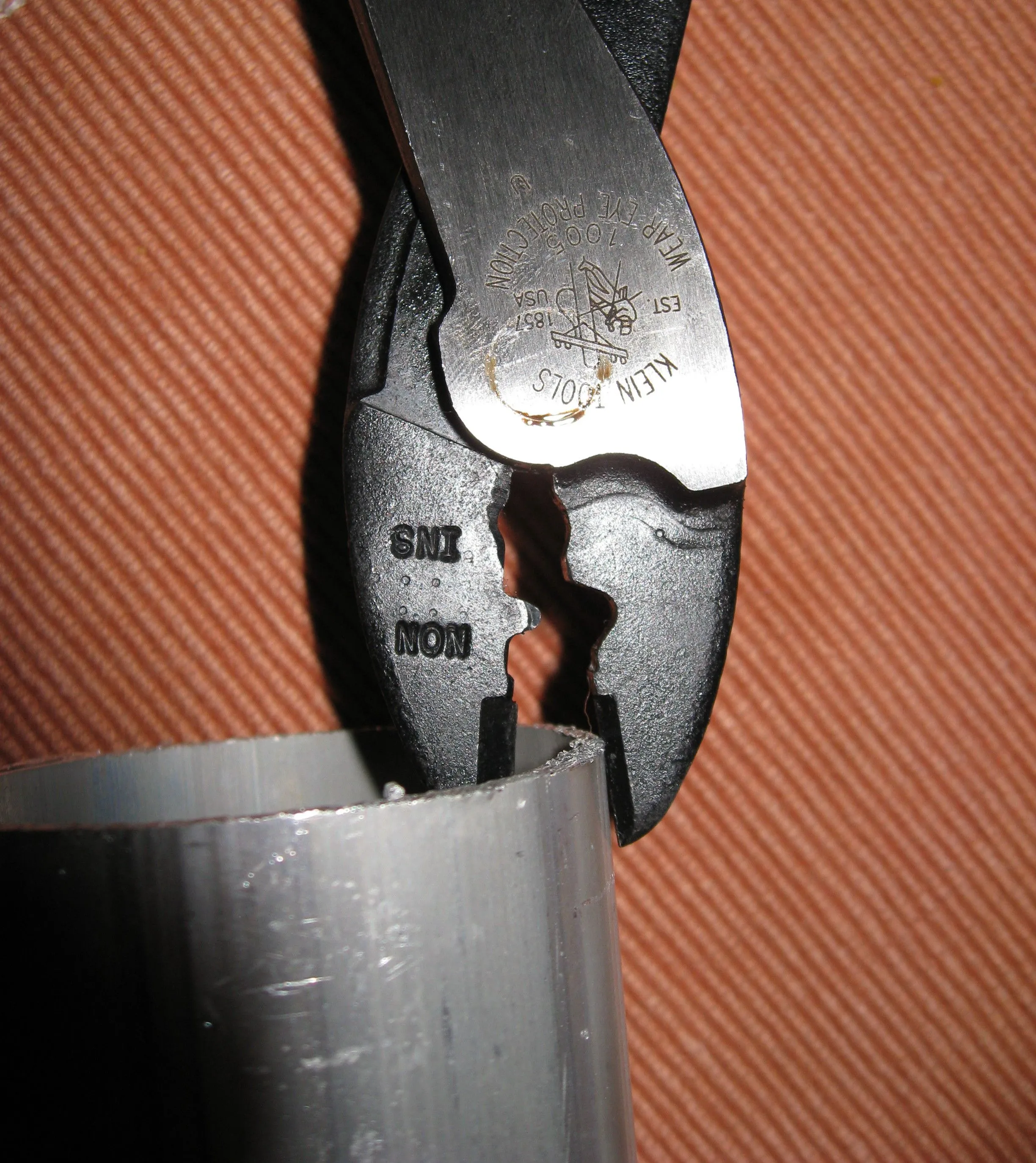

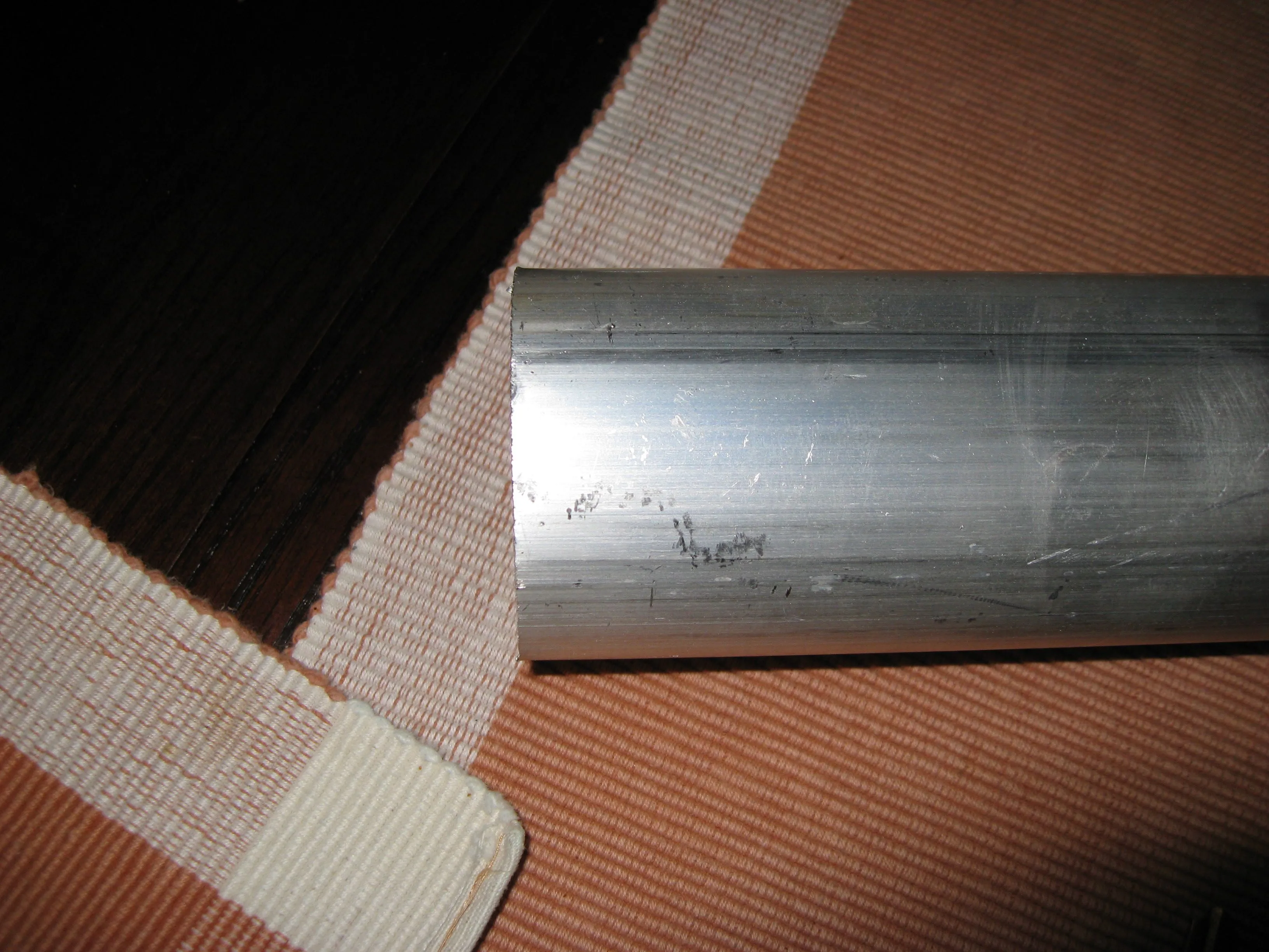

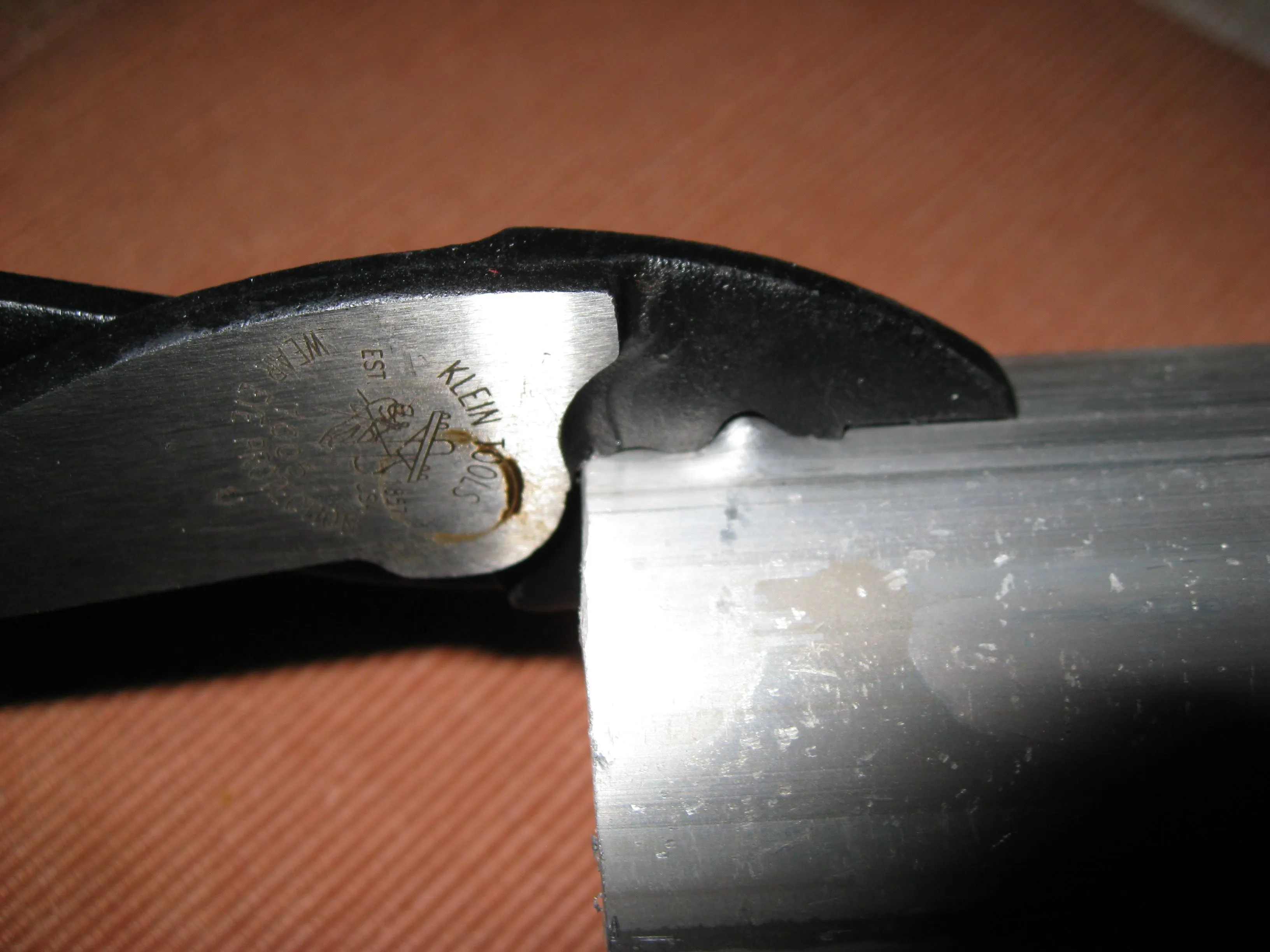

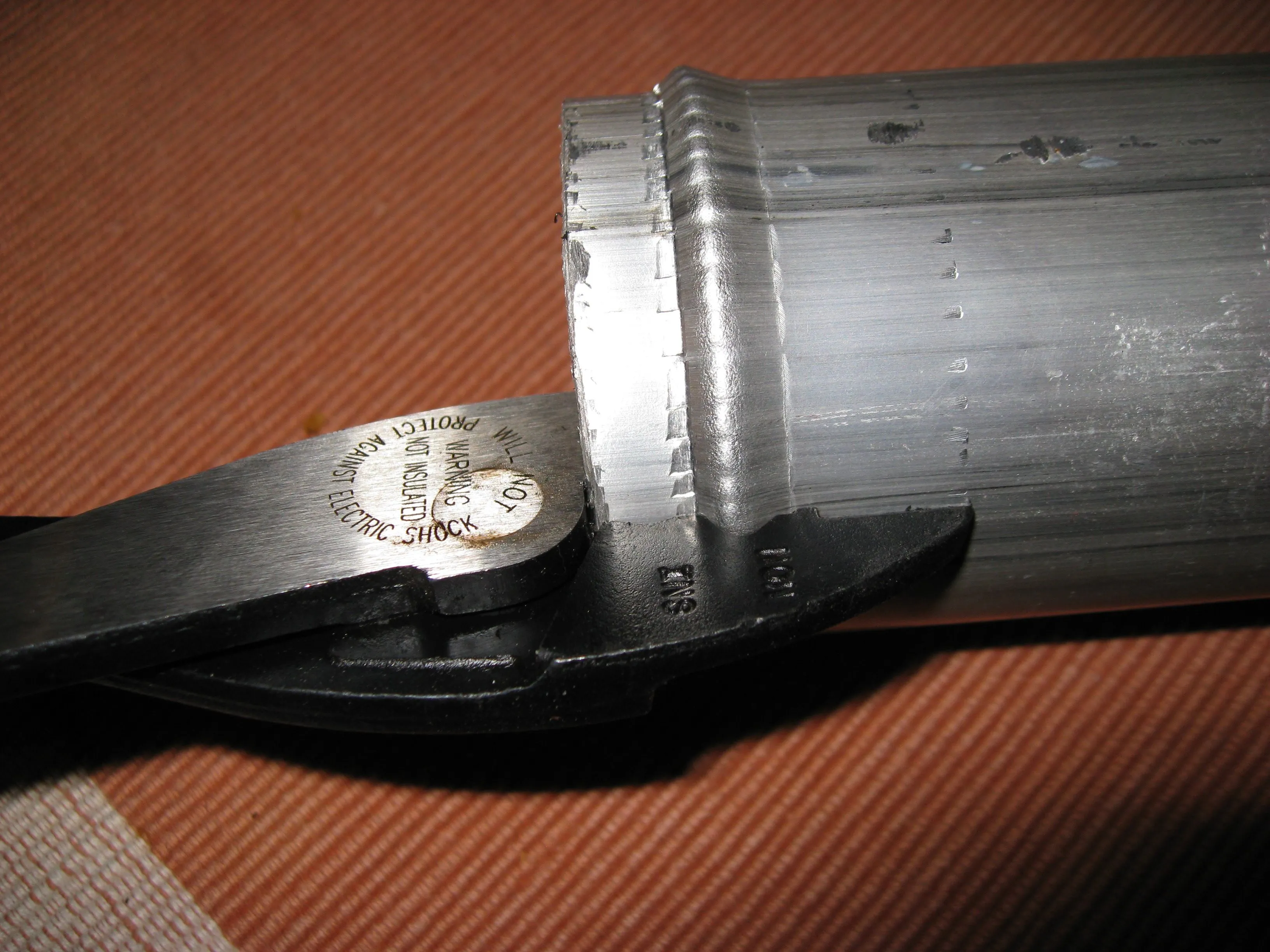

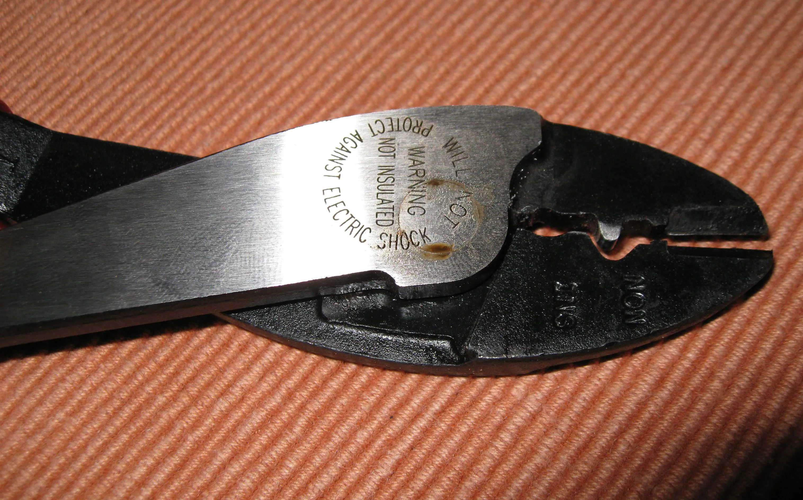

i couldnt believe how easy this really was... first i got a decent pair of crimpers IMG_0778.webp and a piece of 16ga. 2.25" aluminum piping IMG_0779.webp place pipe in the crimpers until pipe hits back of crimpers them press firmly till completely compressed and repeat all the way around pipe. IMG_0781.webpIMG_0783.webpIMG_0782.webp

Whats worse....Is that I own about 5 pairs of those....Since I do wiring and building automation for a living......DOH! (beer)

Great info Dr. d! Normally I do any beading I have to on a Pexto rolling machine, but most people don't have access to a full sheetmetal fabrication shop. The only thing I could think to add is to press the bead in about 3 passes applying a little more pressure each time until you get the full bead. It stretches the metal a little more evenly (important if you end up using thinner pipe), but that's just my sheetmetal background being a little anal. Still a great how-to for the community though and should provide nice results either way.
definitely anal, but from a metal worker's standpoint I see where you're coming from.
i hear ya i just smashed it all the way down in one shot b/c the alluminum was real easily to bend but thanks for the input.
