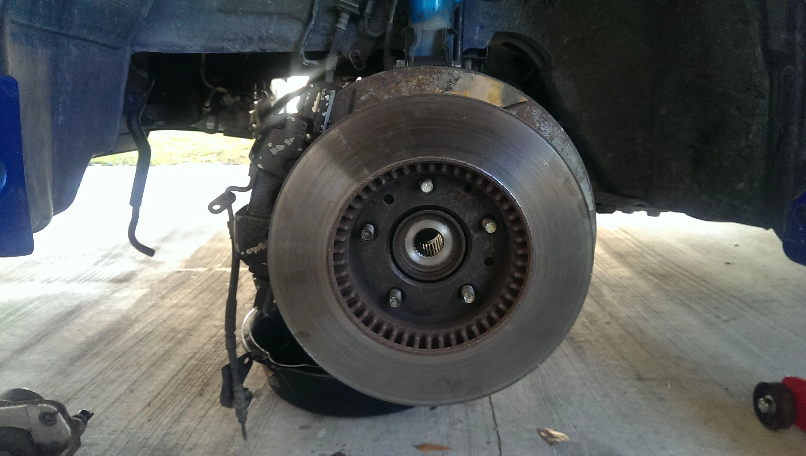

Remove your old calipers and rotors. Wait to remove caliper from brake line until you test the wheel clearance.
Now that everything is out of the way you will need to file off about .5mm of material from the lower caliper hole on the knuckle.
Test fit your caliper, Stare at the awesomeness.
Remove Caliper
Place 2mm Spacer BEHIND (before installing) the rotor. The rotor needs to be pushed out so it lines up correctly inside the caliper.If no spacer is used the rotor will drag on the caliper.
Install rotor. Place wheel nuts to hold the rotor back, this will make installing the caliper easier.
Install caliper. Check wheel clearance. Torque caliper bolts to 80 ft-lb +-7ft-lb. Do not over tighten or risk damaging the caliper.

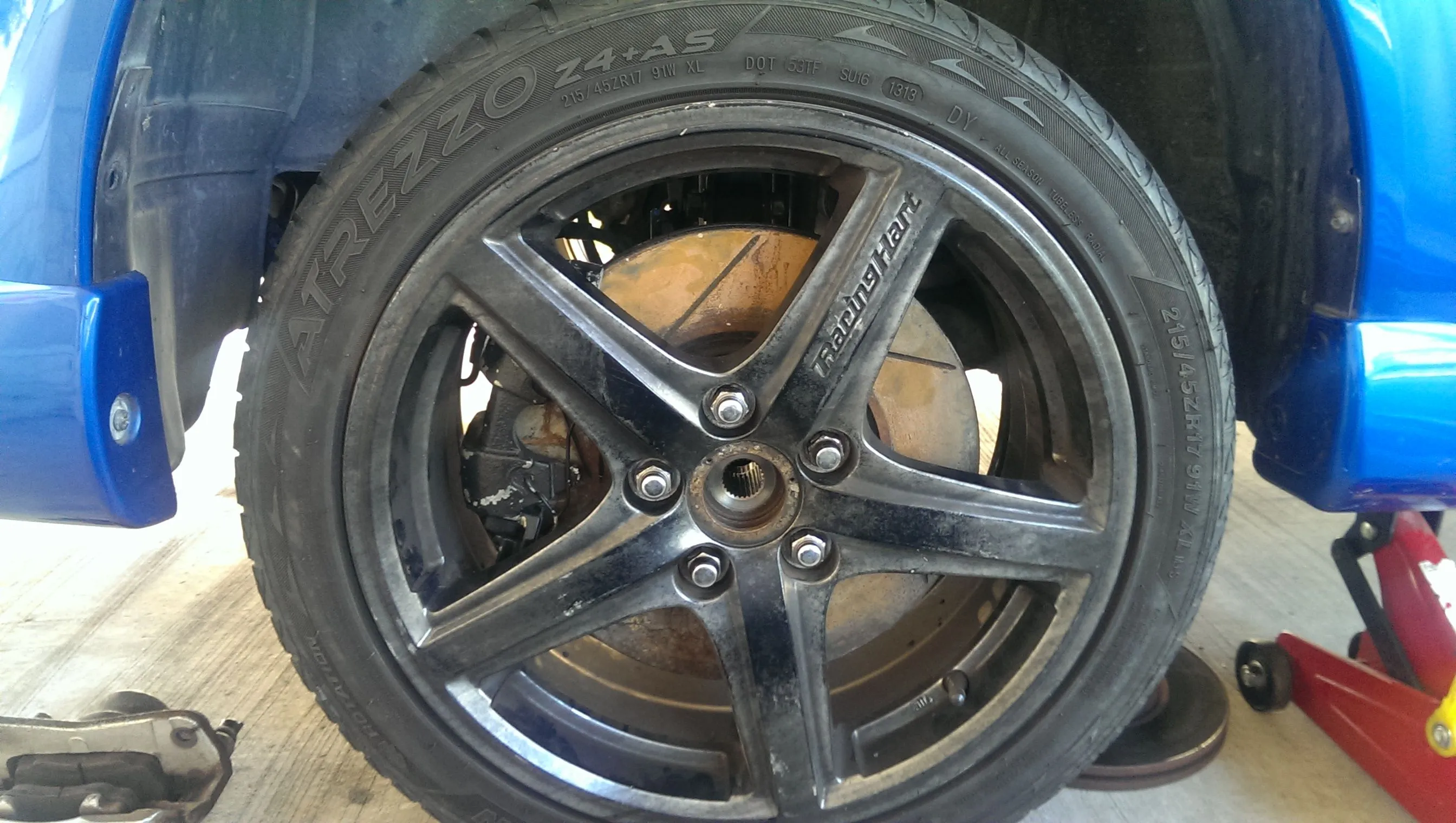

What size tire are you running? Are you rubbing ( with a +35 offset ), did you roll your fenders?
Great info. Thanks for the write-up.
i am running 245 45 17 tires, and they took alot of rolling, pulling, and swearing to get them to fit. Also i had to set my ride height close to stock, slightly lower. I do rub a bit on really big bumps.
