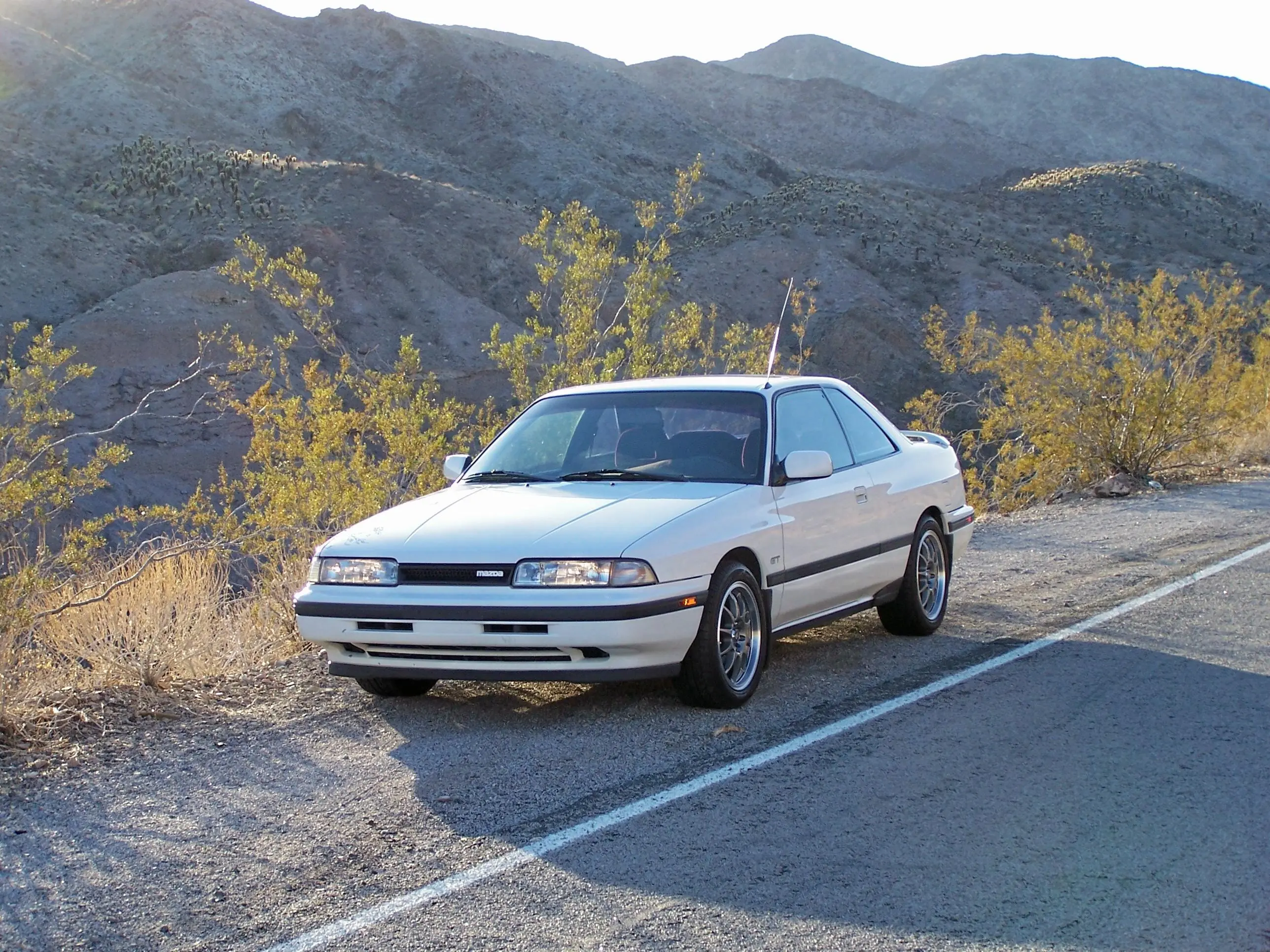

This generation of MX6 (88-91, I believe) also had 4-wheel steering as an option. My car didn't have that but some of the car magazines during that time ranked the MX6 GT as among the best handling coupes.At one point I bought a modified ECU box (deleted the boost limiter), made a boost controller, and set the boost to about 10 psi instead of the factory's 6 psi. It made a significant difference. I think each psi increase raised HP by 10. I then added a triple gauge pillar pod with boost pressure, oil pressure and temperature gauges. Eibach springs and shortened bump stops gave it a nice stance that made the car stand out.
Eventually, gasket leaks that were costly to repair, and drivability issues forced me to sell the car in 2014 after 17 years of ownership. Not having airbags was also a concern.

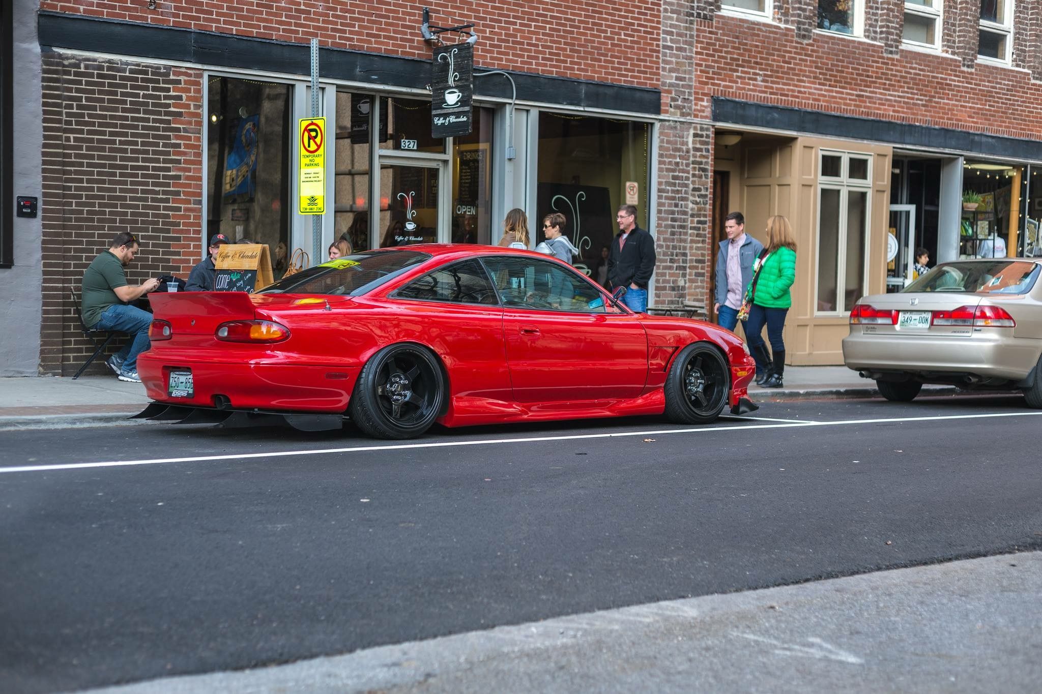

Oh ok that makes sense, you did say turbo gt. I was thinking of the next gen probe/mx6 variant. That's pretty neato.
Yes, I did know either. I used to have a 94 MX6-LS.
That's the version I was thinking aabout. I forgot the previous gen had the 2.2? Turbo
All of my car's generation had turbos from the factory, as did the Ford Probe equivalent.1989 Mazda MX6 GT.webp
This looks almost exactly like the one I had.
