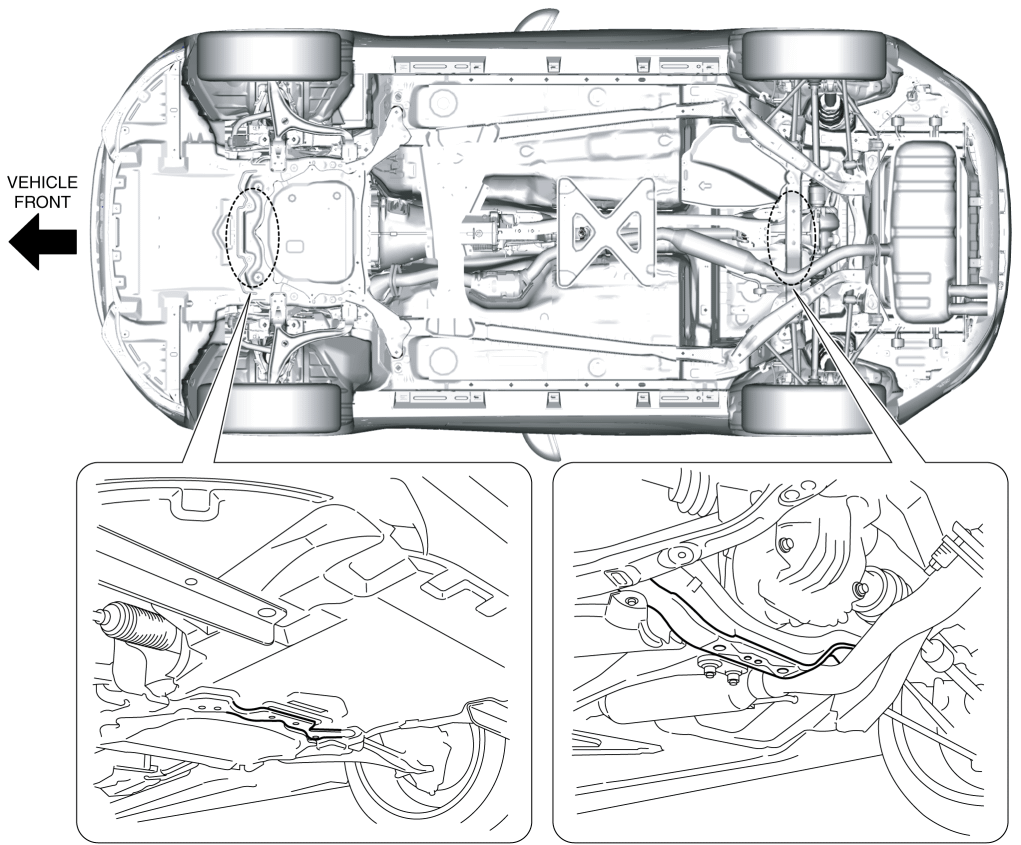

It's looking like jack the car up from the front, put stands to the sides, then pull the jack out and do the oil change.

It turns out my low profile jack has no problem getting under the car without the ramps. The ramps just make it a little easier to get my head under there to see what I'm doing and mate up the jack pad with the cross member.
I put the rear up on stands as well to get the car level. I decided this was the best way to do the oil change because the drain plug is on the side of the middle of the pan. If the front of the car is raised, oil will run to the back of the pan and not be drained. The CX-5 does not have this problem because the drain is on the back of the pan.
