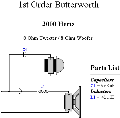

The speaker is a coil, not a resistor, so its impedance varies with frequency. A single cap is a commonly used 6db crossover. The gradual crossover is deliberate. Remember that the system designers have to account for all possible seating positions that a driver could take. Short, tall, it moves the ears through a wide range of location. By using a gentler slope, there is more of an overlap between tweeter and midbass driver, so it is harder to localize the speaker. This is fine in factory systems, but audiophiles don't like the inherent muddiness of the sound that results, so they end up replacing the speakers with sets that have a crisper slope and can be aimed for their preferred seating position.
Yes, I don't like the muddier sound. And I know what a speaker is, but for circuit consideration (atleast that I have done) they are looked at as resistors. Atleast thats all I have done, I am sorry I don't claim to understand the creation and such of speakers but I don't think I am wrong in saying that capacitor as a x-over is a pretty simple and cheap way to do it, when a much better crossover can be made using multiple circuit elements. if you wanted to know, back when I worked with Cable Tech. (we made wiring harness and circuit boards), we bought a roll of capacitors for practically nothing. each capacitor was a few pennies (I realize we used small ones, which were slightly cheaper). It wouldn't be difficult to make a decent crossover with it.
Considering this is a car, I understand where you are coming from, I notice my sub sounds different depending on were I position my head and were I sit in my car, This is not the case in a room with good acoustics, which were more of my experience is based on. But I will say that I enjoyed this alot, I learned a few new things i didnt know!! I hope the thread creator understands it will be able to get his s*** worked out.

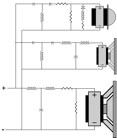

X-over circuits are usually really really simple circuits in general. They're all just caps, inductors and resistors connected a certain way to acheive whatever filter. It's really neat stuff if you research it. Just trying to say 1 cap isn't necessarily the cheap way to do it, it's just all that's needed. I have a couple schematics attached. The first one is real simple. The second one is a lil more complex and includes a notch filter (Passes just a certain range). Neat stuff.
Edit: A thought just came to me from my old electronics courses. The teacher always pushed the idea of K.I.S.S (Keep it simple stupid) Hehe, no pun intended.
