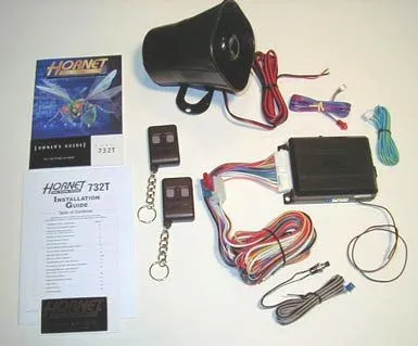

I did some research on my keyless entry with alarm and found out I had a Hornet 732T alarm system that also does door locks as an auxiliary feature. If you have the remote with 2 buttons (one with "I" and the other "II" - see attachment) you at least have the same brand made by DEI.
For this setup you just push button "II" before you push "I" and it silences the chirp for that lock/unlock event. There's also a "Valet Mode" which disables the alarm and operates the doorlocks only. This is silent as well, but every time you lock/unlock until you change back out of valet mode. To get into valet mode:
1. Open any door and leave open
2. Push the "I" button (this will lock the doors)
3. Push the "II" button (this will do nothing)
4. Push the "I" button again (this will unlock the doors AND turn the red security LED on continuous mode so you know you're in valet)
After that you can lock and unlock with a push of the "I" button like normal, but without the chirp and without arming the alarm. To get out of valet mode, repeat the whole process.
I'm guessing that you probably just have keyless entry without the alarm. This probably won't help you, but maybe some others will find it useful. The Hornet 732T user's manual can be downloaded here. That site also has some info on the DEI keyless entry products, which might be what you have.

That's very useful info, but I have a keyfob that has the lock, unlock, and panic buttons.
