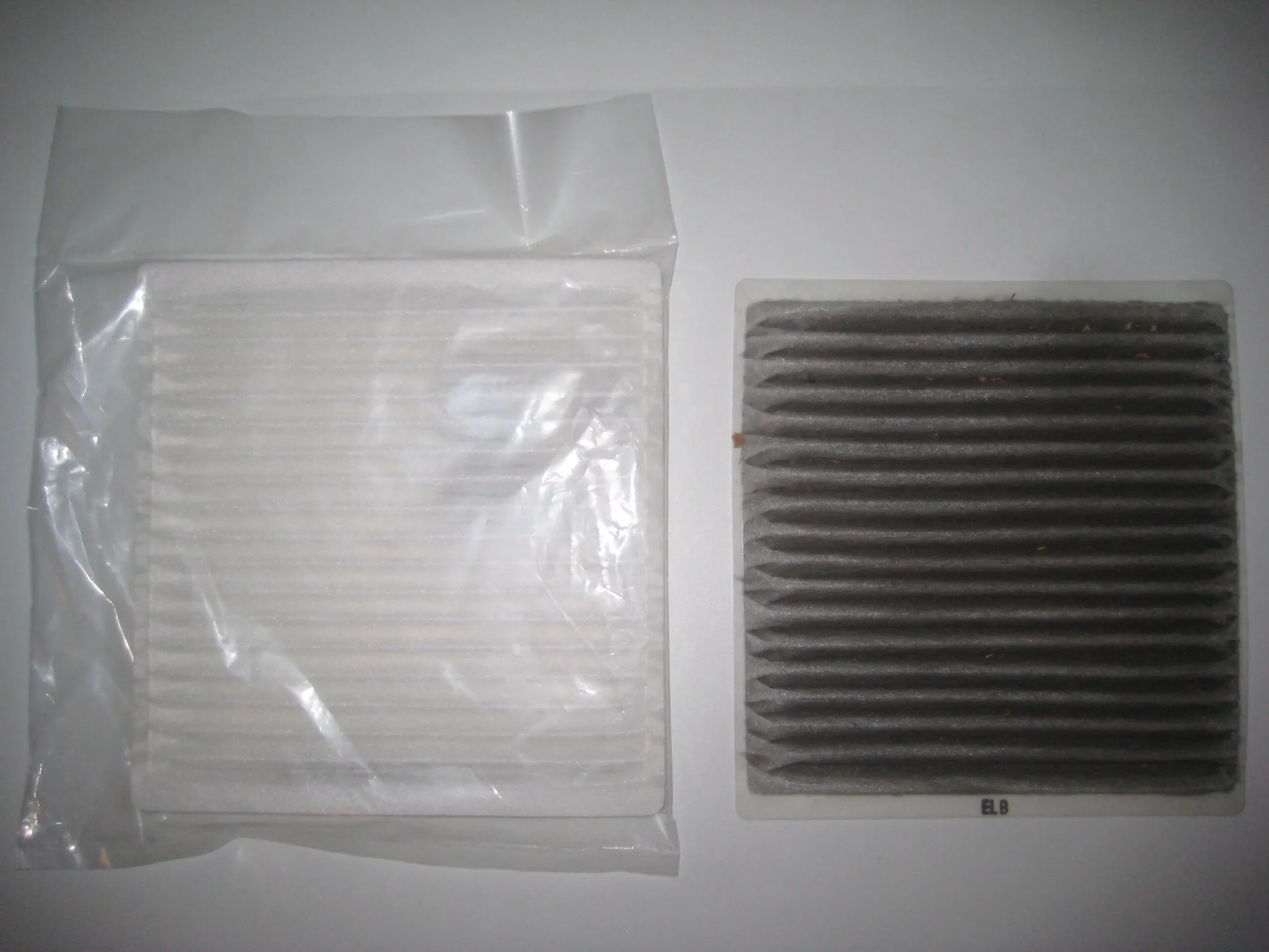

For $4 and a minute of your time (literally), this is a no brainer. This was at 16K, so I'll be replacing every 10K from now on. I bought 4 so I'm good for another 40K.
Picture attached...

A coupe of observations:
1. Although the dimensions of the replacement filter match the oem Mazda filter very closely, these are of much flimsier construction than the original (obviously, expected at this price). The original Mazda filter I removed is more rigid; i.e., it does not bend when holding from one corner. When the filter is installed in the air box, it appears to only be supported along the perimeter edge, which leads me to believe that these replacements will sag down over time and allow air to pass through along the edges unfiltered. Has anyone here found this to be true after prolonged use?
2. I broke the retaining tab off of the filter door - the white plastic tab is brittle, and I must have first pushed in the wrong direction (to the left) when trying to release the door and it flew off into the housing compartment never to be seen again! If a rattle develops in the near future, I will naturally blame the replacement filter!
