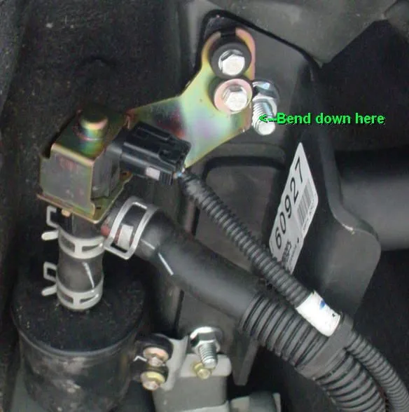

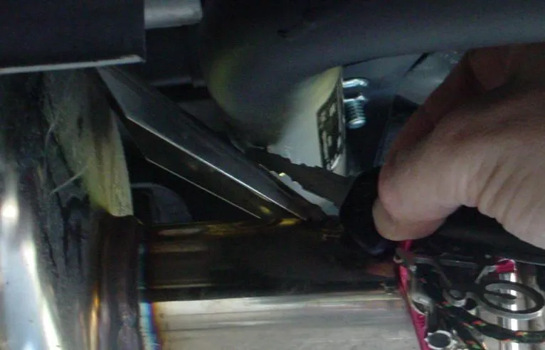

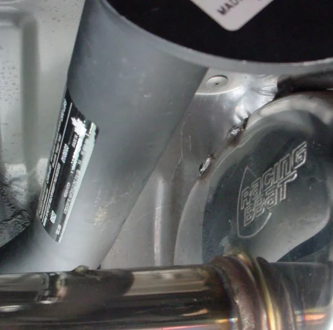

Only problems with a standard Hidden Hitch are:
1) Clearance on the diagonal brace on the Racing Beat muffler - had to Dremel the thing off so when the exhaust gets hot and grows it doesn't bang the hitch.
2) Clearance on the fuel pump - had to bend a pump bracket slightly to make it fit.

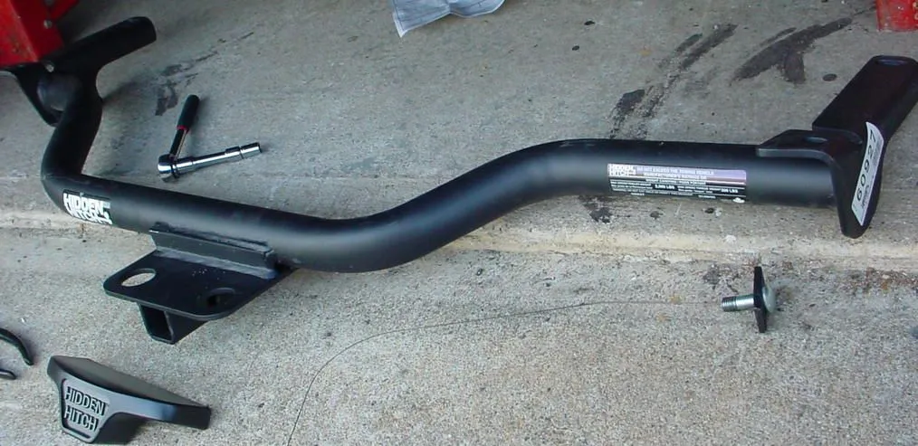

Good things:
1) VERY sturdy - have used it to raise the whole back end of the car no problem

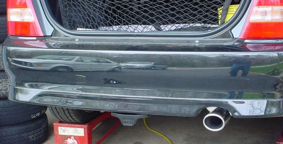

2) Unobtrusive: The crossbar is totally hidden and the mount/receiver hole cover is subtle
3) Easy install - all tools/bolts included and a decent ball mount comes with it.
Even with that it was maybe an hour install, would highly recommend removing the muffler to improve clearance while installing and to allow better Dremeling if it's necessary.(15 minute job, 2 bolts and silicone-spray the hangers and it pops right off).

I have more pics of the install and more details if you need 'em but it was pretty easy - if you can change oil you can do this no problem. I have NOT wired up the lights yet as I use the hitch for a bike rack - but that's on the list as I have a small utility trailer I want to be able to tow.
mine came with everything but the ball and wiring. I will post pics when I get back from the lake. It is definitely a clean look. Instead of cutting on the factory muffler I just had a pipe custom made to go from the d/p and dump over the rear axle attached to the first hanger. It took the second hanger completely out of the equation. I didn't have to ben the fuel pump braket because I bolted it back on after I tightened and torqued the hitch bolt. It snugged down right on top of the nut with no clearance problems. So far I am pleased, I will know more after this weekend.
