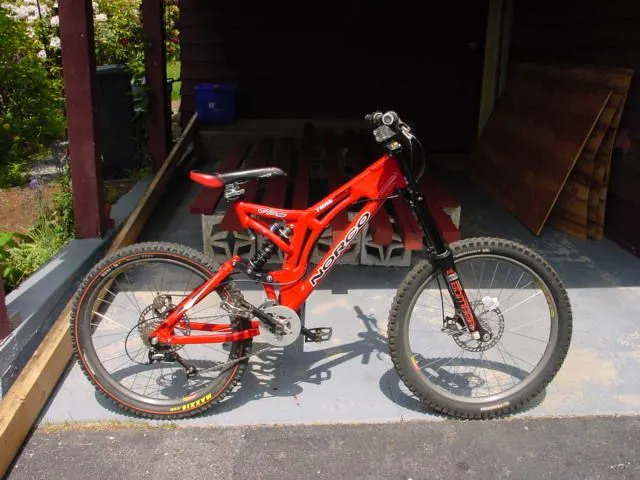

As I'm not too keen on the idea of lifting 50lb DH rigs on and off the roof I was wondering....Does any one have a hitch mounted bike rack on their 5 yet? If so what size reciever hitch and make of rack do you have. A friend of mine has one on his Mazda 3 but it can only hold 2 bikes and I was hoping to hold 3, possibly 4 bikes. Any info would be appreciated...(I'm that much closer to ownig a 5 :) ).

sweet rig man. are the 888 vf2 or rc2x? upgrade those rotors tho... don't want that v-pattern wear on your pads.
but you definately want the 2" reciever hitch. if your gonna be shuttling you and 3 buddies, then you will have just about 200lb worth of bike on the back of you car. all my friends use yakima fullswings (yukon and f350)

ya, their the rc2X. simply unbelievable :). I checked a couple of sites afer my post and most say that the 5 will hold a class 1 hitch. That means only 2 bikes. Which I believe was the issue w/ my buddy's 3. thanks for the info though

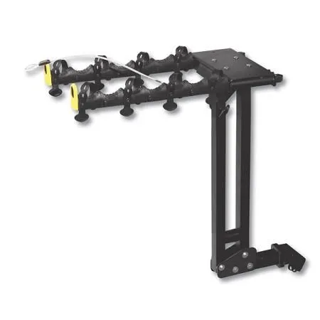

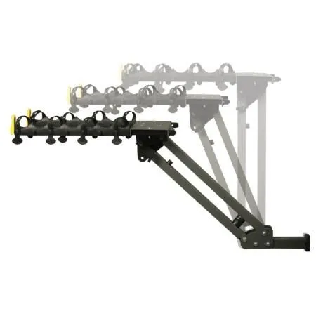

I installed the Hidden Hitch Part # 60948 Class I Trailer Hitches - 1 1/4" Receiver and a Softride Access HD Rack (4 bikes).
I love the rack. It folds down to give you access to the hatch, even with the bikes on it. You can also install a ski rack on it.

how much weight will it carry? remembering that 4x50lbs = 200lbs.
2000 lbs Gross Trailer Weight and 200 lbs Tongue Weight.
