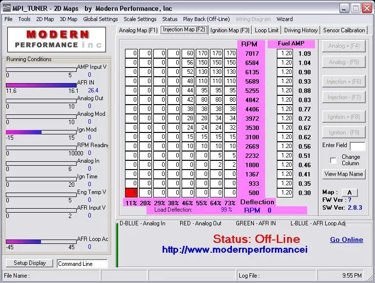

The fuel cal shouldn't matter too much on the injection tab. Do you have all 1's in the 1x16 column of the injection tab? If not then you are not adding the fuel you think you are. How about a snap shot of it, so I can check it out. Here's one of mine, but I am only running 2 xtra injectors B4 the TB and 8psi.

Here is a screenshot of my Injection Map.

Your map is interesting...referring to your 1x16 Fuel AMP column. 1.20's? Tim, what do you think?
Yeah man, there's no way you should be lean. No sure about your fuel pressure issue. Nick is still using the stock pump on deans car and he is running 24psi wit 2 xtra injectors. Have you been running this setup for a while?
Don't know about the 1.20's. I have only ever used 1's and so has nick. You might want to try to make them 1's, but I don't think that would be it. It's worth a shot.
