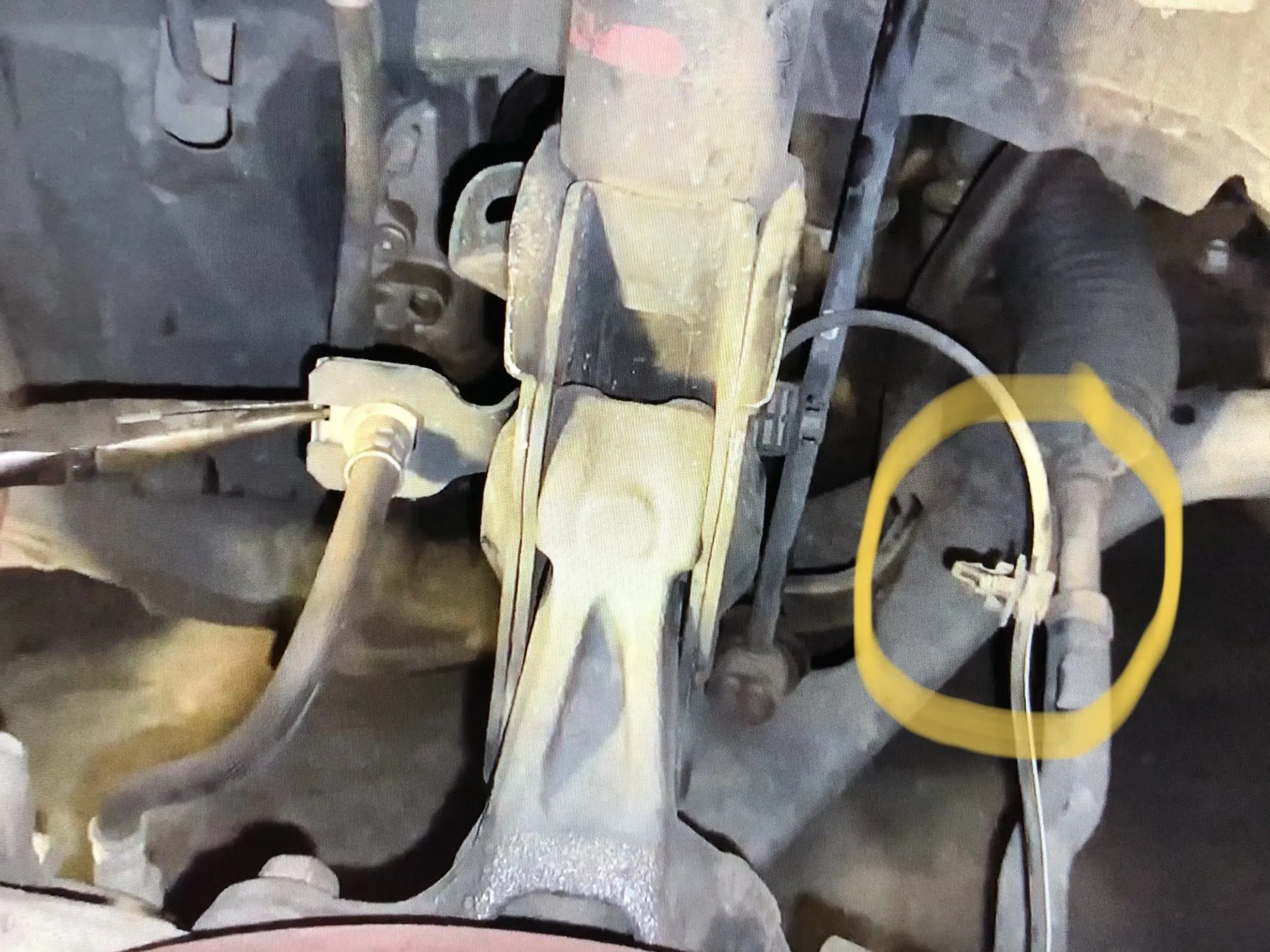

D d1gp : Mazda CX5 AWD Apr 8, 2020 #1 Hello everyone I’m trying to find the part # that’s circle one yellow. I’d search most of the oem part website but no luck. Thanks, -M Attachments FFB8C843-790B-47AC-821B-0EA9732F050D.webp 413.7 KB · Views: 234
rsvinylgraphics 2008.5 MGM MS3 Contributor : 2008.5 MS3 Apr 8, 2020 #2 looks like the abs speed sensor wire, the plastic clip might not be able separately you may have to buy the entire speed sensor harness. MAZDA OEM 13-15 CX-5 ABS Anti-lock Brakes-Front Speed Sensor K0114370X | eBay Part Number: K0114370X. www.ebay.com
RedBaron 2014 & 2019 CX-5 Touring(s), 2023 CX-50 TPP Apr 8, 2020 #4 There must be dozens of equivalent clips available, just visit (well, if you can right now) the Help/Dorman isle your local parts store. If nothing else, use a christmas tree pin and a couple of zip-ties
