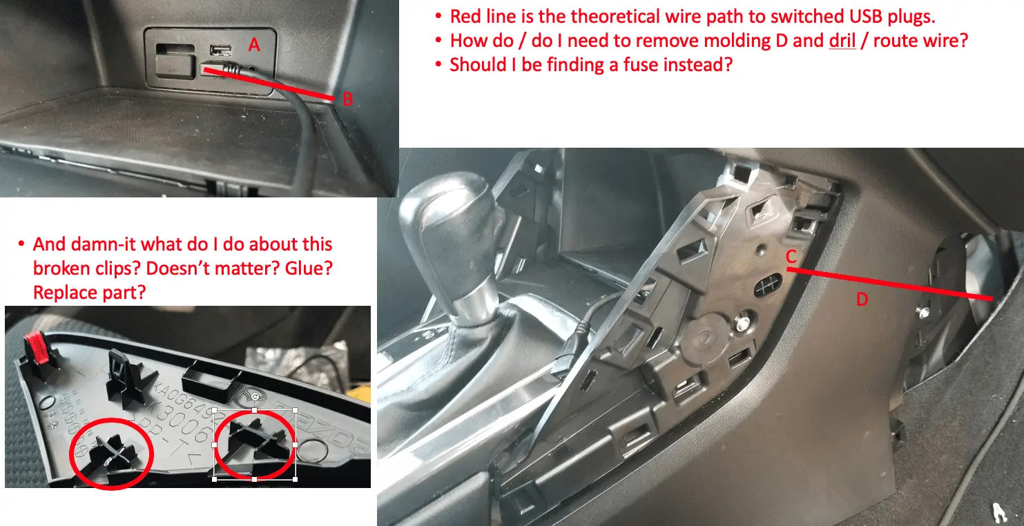

I bought this dash cam: https://www.amazon.com (commissions earned) and am very happy with it. Want to install it to a switched location - the USB ports are switched and the cigarette lighter is always on.
I either need to:
A. Wire this to the fuse box to switched
B. Plug it into the USB
For B, I got a L- USB cable and was going to try to poke it all through some trim and stuff but I'm getting stuck. You can see the photo attached it actually looks pretty easy - Come out A, drill a small 1/2" whole through B, bring it out at the other side C, and then behind that molding D. But removing that molding D to get a clean drill and the behind is kind of important. And nothing I can find here really makes sense => http://www.mcx5.org/front_console_removal_installation-630.html and it seems like a TON of work and I don't know what to do.
Am I on the right track? Should I drill that hole and rout it behind the best I can? Or should I switch to trying to find a fuse - which I also don't really know how to do.
Help!
PS: The other attachment shows a piece with clips I broke - what do I do? Can I get it back on well enough? Do I need to replace it?
I think if you can find the metal parts that fell off they might work good enough by just putting them back.
Why not just have the wire come out the cubbyhole then wedge it back under the underdash trim?

Car: 2016 CX-5 Touring (silver ext, black int)
I either need to:
Help!

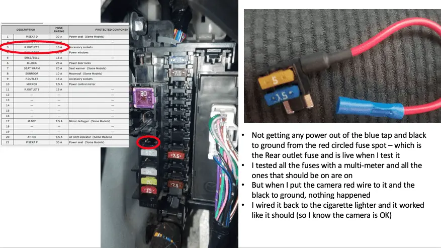

OK guys, I went the fuse route and it's not working.
I bought a fuse tap, wired it up, not working when car is on or off.
- Not getting any power out of the blue tap and black to ground from the red circled fuse spot * which is the Rear outlet fuse and is live when I test it
- I tested all the fuses with a multi-meter and all the ones that should be on are on
- But when I put the camera red wire to it and the black to ground, nothing happens
- I wired it back to the cigarette lighter and it worked like it should (so I know the camera is OK)
Am I using the wrong size fuse for the camera? THe original is 15, the camera should be 5 right? I tried a 10 and it also didn't work.
Is it possible I put the fuse tap in wrong? It only goes one way for example?
So I think I have the right path, but something isn't working properly. Any thoughts?
