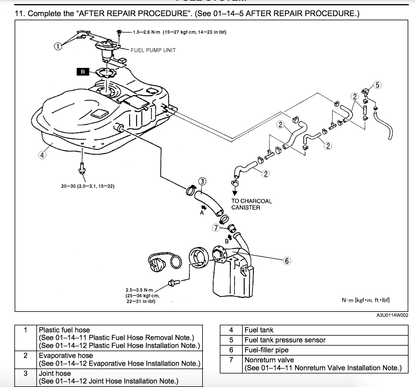

I was wondering if I might be able to siphon directly out of the tank, going in where the joint hose (3) meets the tank?

What do you think? Otherwise, I'll go in through the back seat/gas tank access panel, or the DLC/fuel line route (if it won't harm the lines).

There is a filter sock/screen on the input of the fuel pump that should catch any big chunks of crap and the fuel filter/fuel pump housing will catch anything else.
But you don't want to plug up the filter.
The fine particles of crap that get caught in the fuel filter tend to be stirred in the gas and don't necessarily sink to the bottom.
You don't want to run the fuel pump dry.
That can wreck your fuel pump.
You could disconnect part number 3 to gain access, and you may be able to stuff a small tube right down the filler neck but I'm not sure about that.
Some cars have screens in the filler neck to prevent your fuel from being stolen.
As far as rust goes, I would just wait until the tank springs a fuel leak or a vapor leak before replacing it.
It's kind of a dirty chore to replace but I had rusty bolts that snapped.
I had to drill new bolt holes to bolt the tank back up.
This is a picture of the fuel pump housing and screen/sock.
Replacing the fuel filter is a good idea because it could be close to plugged up and that can burn out your fuel pump.
It would be a good excuse for the effort and you can empty the tank that way and see the crap in the tank.
