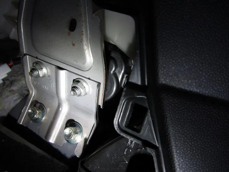

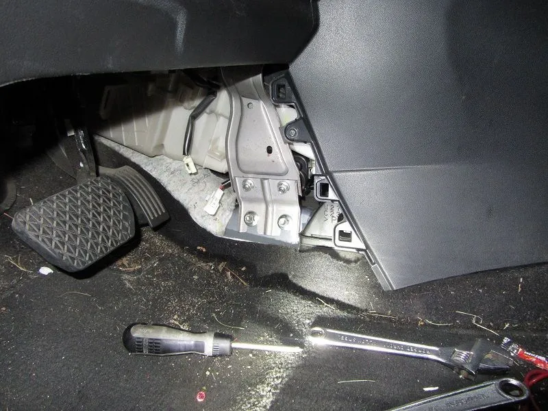

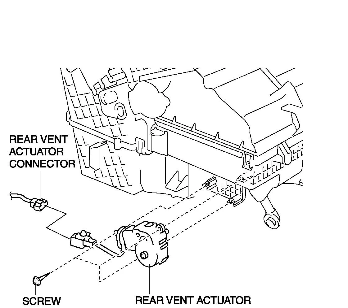

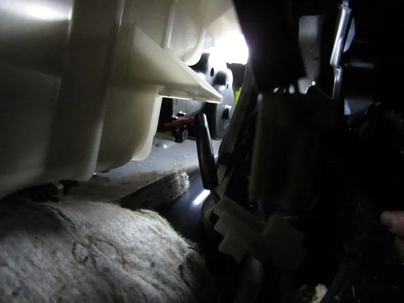

Old thread, but since I just worked on it, here goes. It's the rear vent actuator and it's behind the panel right beside the gas pedal on our '08. There is a small metal brace that has to come off with 2 nuts and 2 bolts (both 12mm) then you can remove 3 phillips head screws and it will slide out with some wiggling. That actuator opens a vent door to allow air to the rear blower.
On ours, the actuator motor is fine, it's just not getting 12vdc to move it either direction. So, what I did was hook up three li-ion batteries in series to get close to 12v and energized it to open the vent door. At least we have rear air for the summer. Unfortunately one of the controllers is probably bad which is $$$. I'd rather the actuator have been bad.
I'm going to do a couple more checks per the troubleshooting guide but am pretty sure I know what's going on.
Pics: You can see the black actuator behind the bracket that needs to be removed but a 12mm socket takes care of that pretty easily.

Thats good info right there! Could you work up a method of opening the damper manually I wonder? Like the outside air/recirculate flap on the main airbox? This tells me that the rear air really isn't any great shakes as all it really does is take air from the main and recirculate it with a fan. Interesting.......
I actually thought about that. You could probably get a string around it and have the panel keep it in position, though the damper is spring-assisted shut.
With it open all the way, it doesn't appear the rear blower does a whole lot. Low speed on the rear doesn't change the airflow at all, high does speed it up some. The front vents still blow great, especially now that I changed the cabin filter which was nasty.
Thank you SuperJETT. I have the same problem on my 2010. Using a meter I could see the 12 volts for about 5 sec, but the motor did not move. I then tried 12 volts to the motor and the door opened. Great! My final set up includes rigging two wires on the motor connector. With a Radio Shack accessory connector with push in wire connections, I open the door with a brief connection to my accessory connector on the dash. That opens the door. To close I reverse the polarity , plug in to accessory, and the door closes. No need to keep it connected to 12 volts so I feel safe. Only two of us, but sometimes I need rear cooling.
