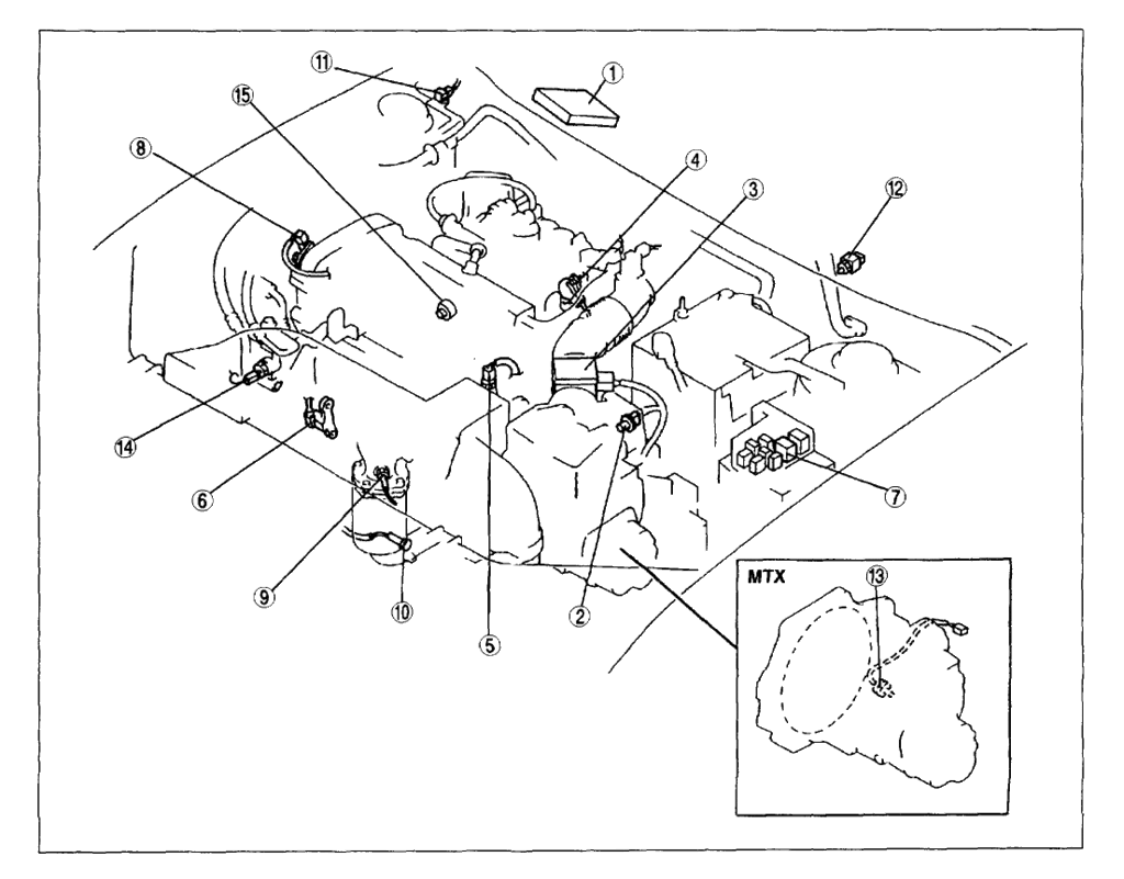

Ok it was a false alarm thank god, I checked the intercooler piping and the boost accuator neither of those I came across a computer and it came up as throttle position sensor, can anyone tell me where that is located ? Thank you
Engine compartment side
1. PCM
2. Intake air temperature (IAT) sensor
3. Mass air flow (MAF) sensor
4. Throttle position (TP) sensor
5. Engine coolant temperature (ECT) sensor
6. Crankshaft position (CKP) sensor
7. main relay
8. Camshaft position (CMP) sensor
9. Heated oxygen sensor (front)
10. Heated oxygen sensor (rear)
11. EGR boost sensor
12. Clutch switch
13. Neutral switch
14. Power steering pressure (PSP) switch
15. Knock sensor
