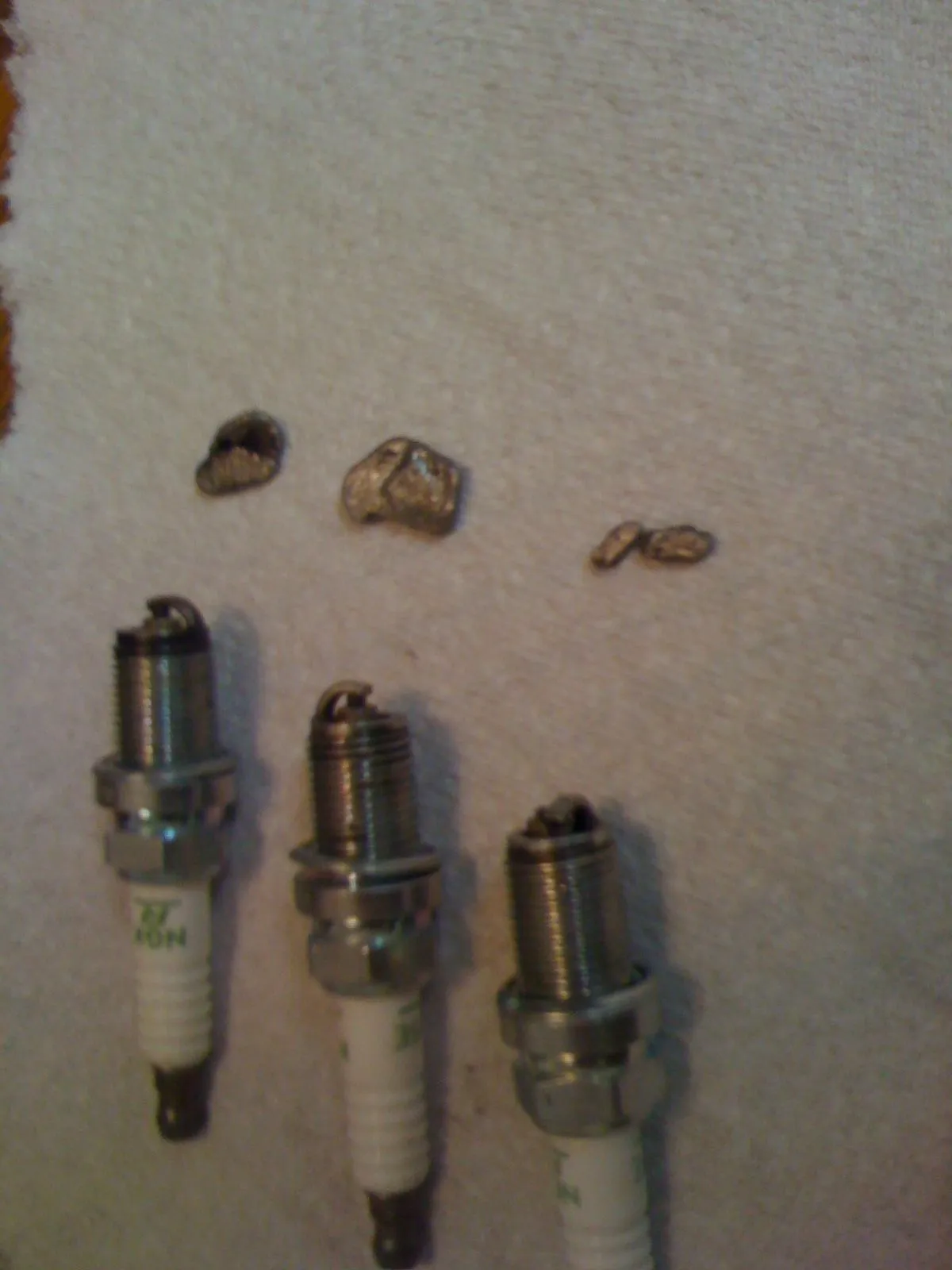

pulled the intake last night all the screws were still in the butterfly valves. From what i have read on that recall it is on cars before my VIN. after i got all the peaces out the car runs pretty well maybe a bit rich but all in all good. But i guess now is good a time as any to learn how to work on a piston driven engine.

PSI should be 199 & 142 is minimum. 135 is starting to get low. Look again at the VICS. They are in the middle of the intake. You have to take it apart to inspect them. The way you say it drives and the number of pieces of metal in your pics says to me you lost 2 of them and they are laying loose in the intake. They are too big to go anywhere else. Does the car sound more rattly than usual at idle? That'd be those butterflys loose in the intake. Check it out before the others come loose and you have pieces in other cylinders.
the motor is toast guys it would not fire this morning when i was leaving for work. had it towed to the stealership they said just from the peaces that it was the butterfly valves and that it is NOT covered under the recall. my car was built less then 1000 after the VIN series for the recall....BS got an email to mazda corp customer service
