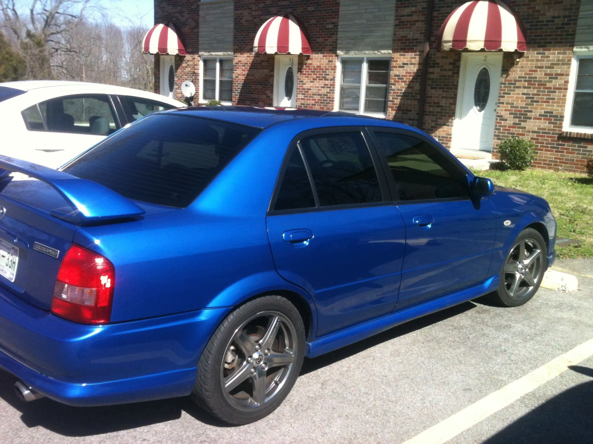

I know this is probably on here, but I have looked and looked and cant find it. I bought a blue msp with 118k on it, the car blew an engine last year and i have receipts from the rebuild from mazda for almost 8k dollars. the new motor/clutch/timingbelt.... (you get the idea) only has 3k miles on it. the interior is perfect and I would say overall the car is 9/10. with that being said...here is the problem. when the car hits 60 MPH it has fairly violent shutter/misfire and after 60 mph runs kind of rough. it will also misfire randomly under strain but without a doubt everytime at 60. the guy I bought it from said they put platinum plugs in the car when they put in the motor, I did some research and found that platinum were too hot and downgraded back to copper NGK plugs today. I also found that the guy has been running regular unleaded in the car since the rebuild ( AND BEFORE ) and he had no clue that the car required premium. I put a bottle of octane boost in and a half tank of premium which mixed in with the regular already in the car. it runs better, but it is still not fixed. I read a car and driver article about the MSP hic upping ( spelling ) during its road test and thats exactly how I would describe this. I read also about a free ECU flash that mazda put out to fix a hesitation problem....Im wondering if this is what they referred to as hesitation. sorry to be so long winded, but I love this car and want to see it run the way its meant to. if anyone has had this problem or has advice on what to do....let me know!
