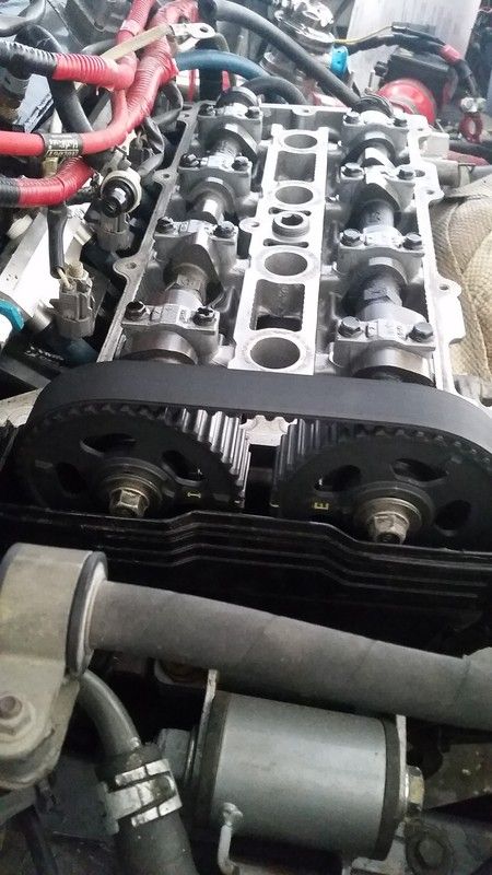

Hope it's not timing being off by a tic, don't see how it could be though.. I did it perfectly! No collisions, only thing was throwing out the transmission..
If the timing belt tensioner failed it's possible for the belt to have slipped. Glad you were able to get the codes read, now you aren't having to take shots in the dark.
So, I've taken off the valve cover just to have a peek-ski.. Everything looks great! It's been about 4-5k miles since the build and everything still clean and looks to be where it should. All cam bolts still nice and secure.. Timing marks are right on.. everything turns and seems to be solid mechanically.. Can even hear the compression as I turn motor by hand.
