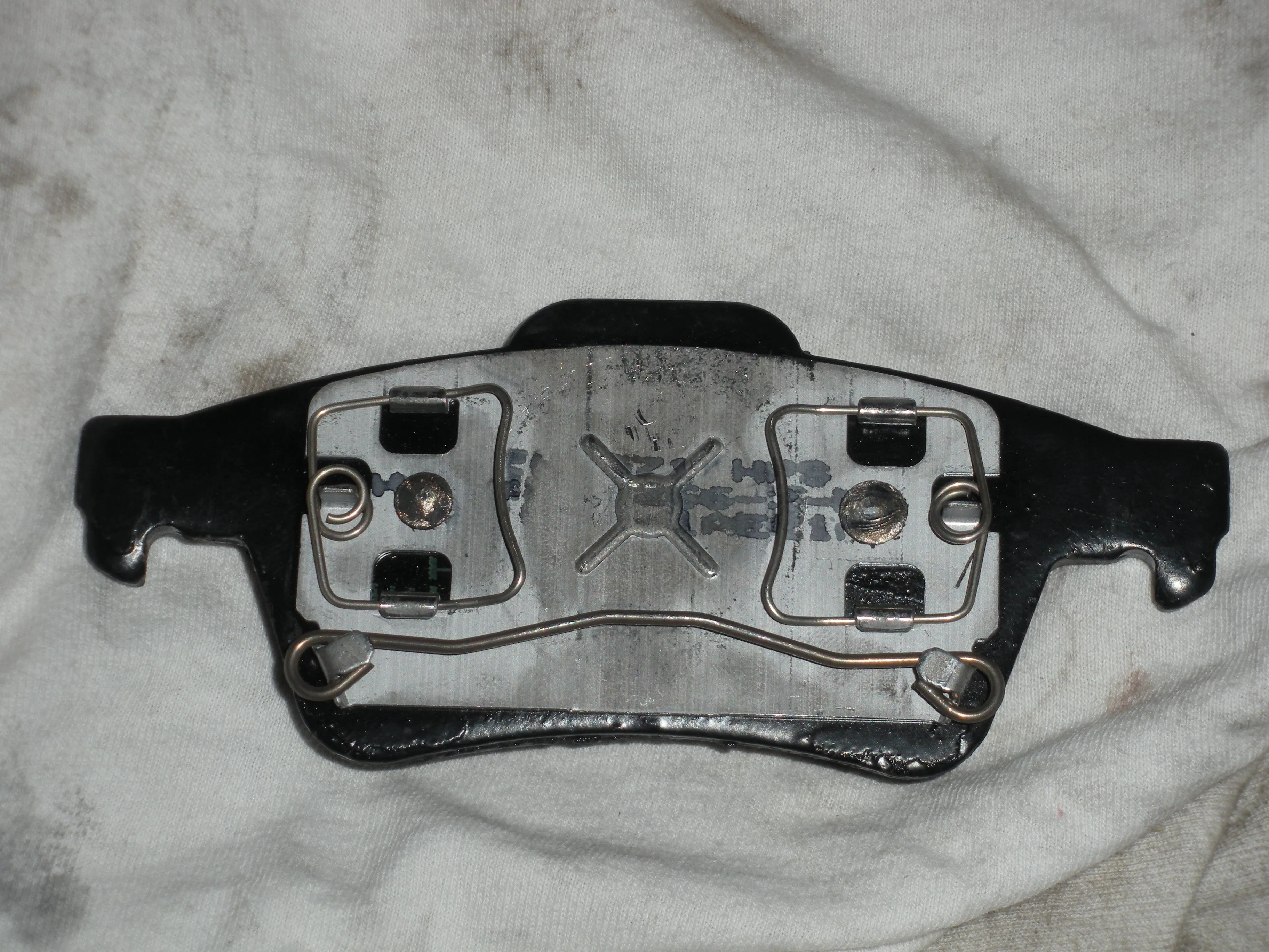

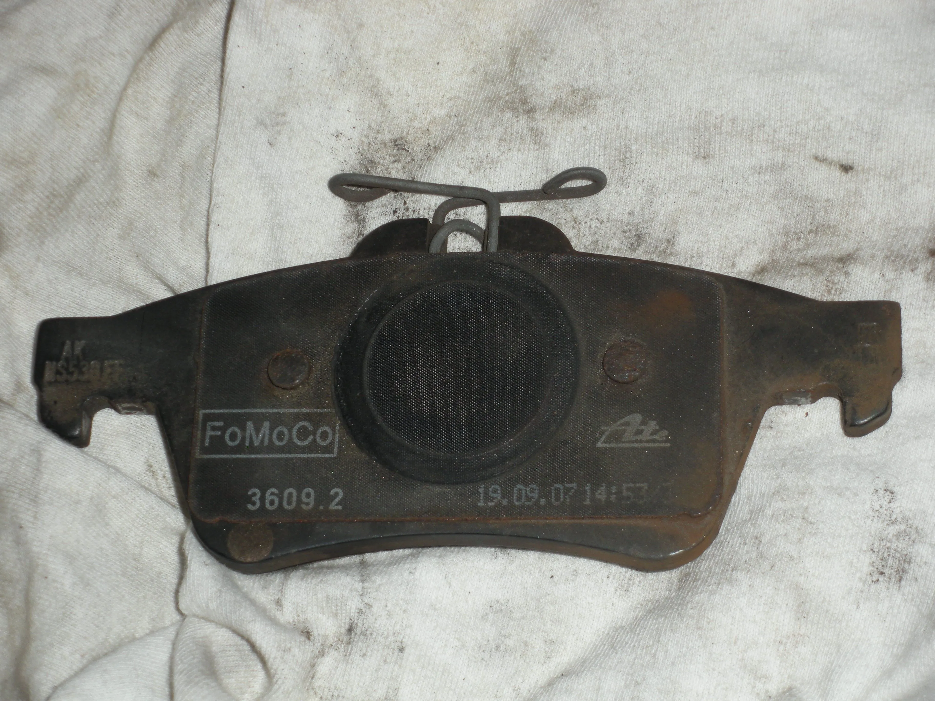

My question relates to the installation of the Hawk HPS pad in the rear caliper of the MS3. The Hawk pads have a totally different spring retention system than the OEM ones do. The OEM pads have a spring that comes off the top of the pad, while the Hawk Pad has springs on the back side. (Pictures below)
It appears that the springs on the back of the replacement are designed to fit into the slot on the piston, but it's near impossible to get the pad on the piston, and get the slider in proper position.
I ordered the pads from Protege Garage, so I assume they're the right ones. I was hoping someone might be able to shed some light on this issue.
Any and all constructive input is welcome.
Thanks!
GT
I would email Ken and find out. Me thinks that they accidentally sent you the wrong ones. Were the front ones correct?
The Hawk HPS part number for the MS3 is:
HB478F.605
You have the wrong pads.
I'm looking at a brand new set of them right now, and they definitely use the same retention system/backing plate setup that the OEM pads use.
Definitely contact Protege Garage, and have them send out the correct parts.
I was gonna say, my Hawk Performance Ceramics didn't have those funky springs for the rear pads.

thanks for the heads up here. i was acutally talking with both hawk and nutari about the pads here. HB571 is what both my hawk rep and wholesellers have been recommending me for rear pads on the MS3 as of late and thats what they have been sending over the other part number for me. i'm talking with them presently via email to get the other pads to you or at the very least find out why they are sending these if they do not fit / what the reasoning is?
i do apologize for playing phone tag with you as well, and will PM you myself now.

I am in contact with both Ken and Steve at Protege Garage, and we are very near a solution to this. Apparently Hawk was providing the wrong numbers to their retailers. We should have a resolution soon. Thanks to all those who helped, I think we may have ferreted our a problem.
Just to follow up, we've got everything straightened out. It seems as though Ken and Steve have been put into awkward positions by their vendors. I'm happy to report that the issues with the pads and the rotors have been resolved, and I should be ready to go for VIR next week.
