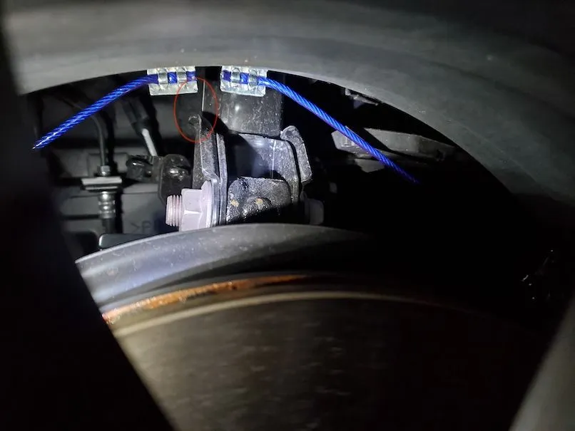

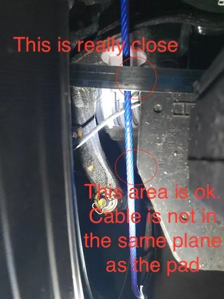

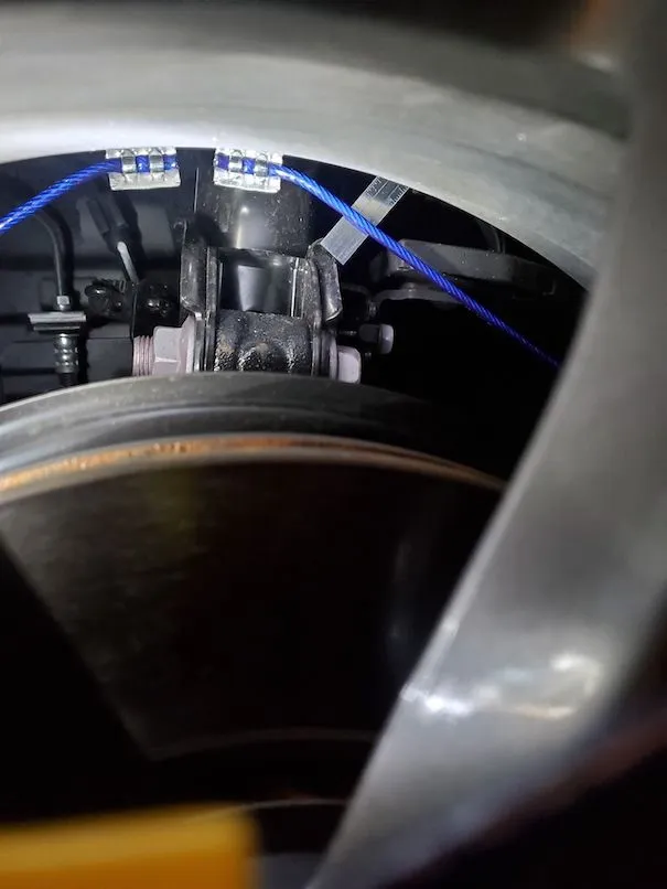

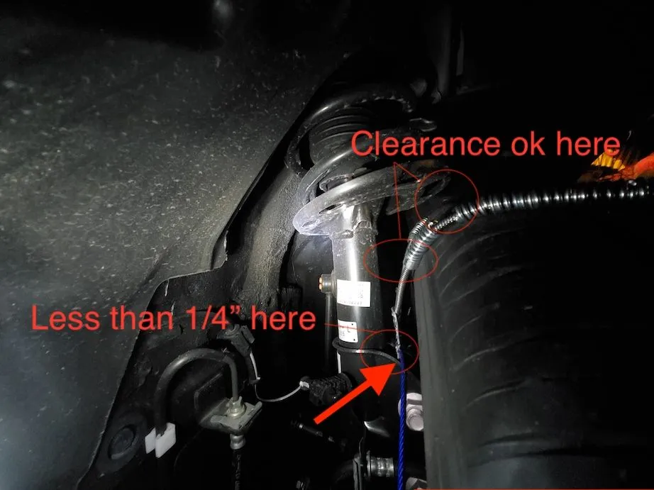

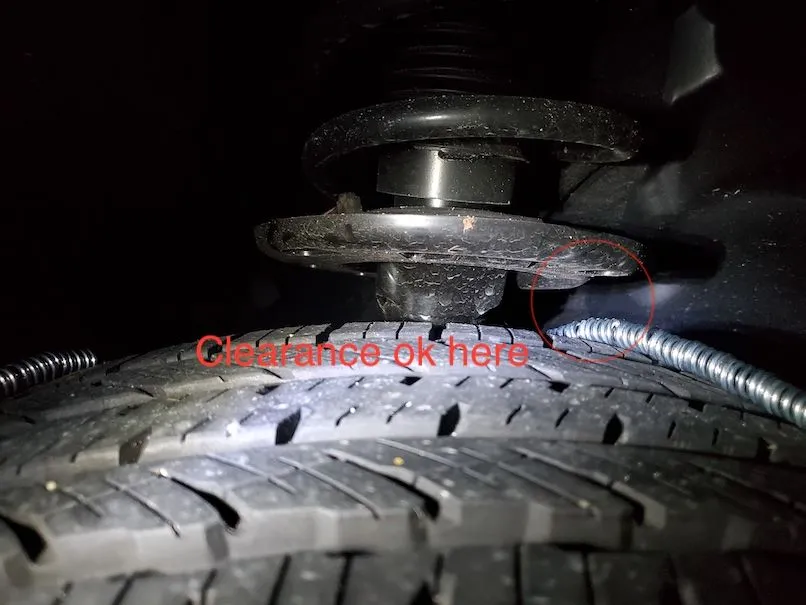

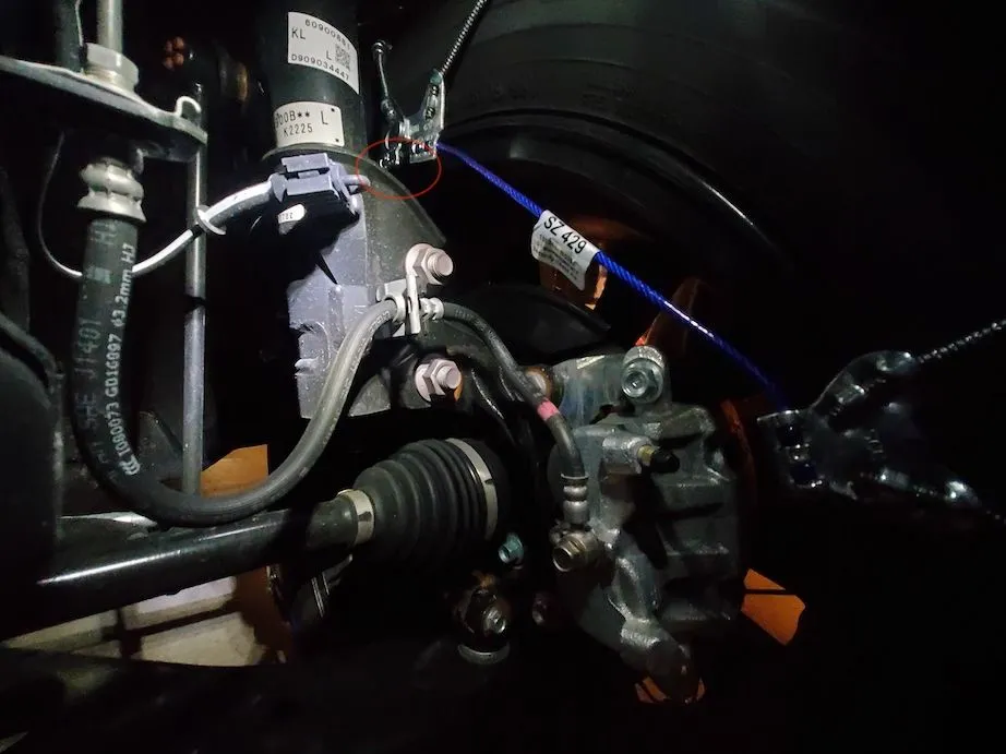

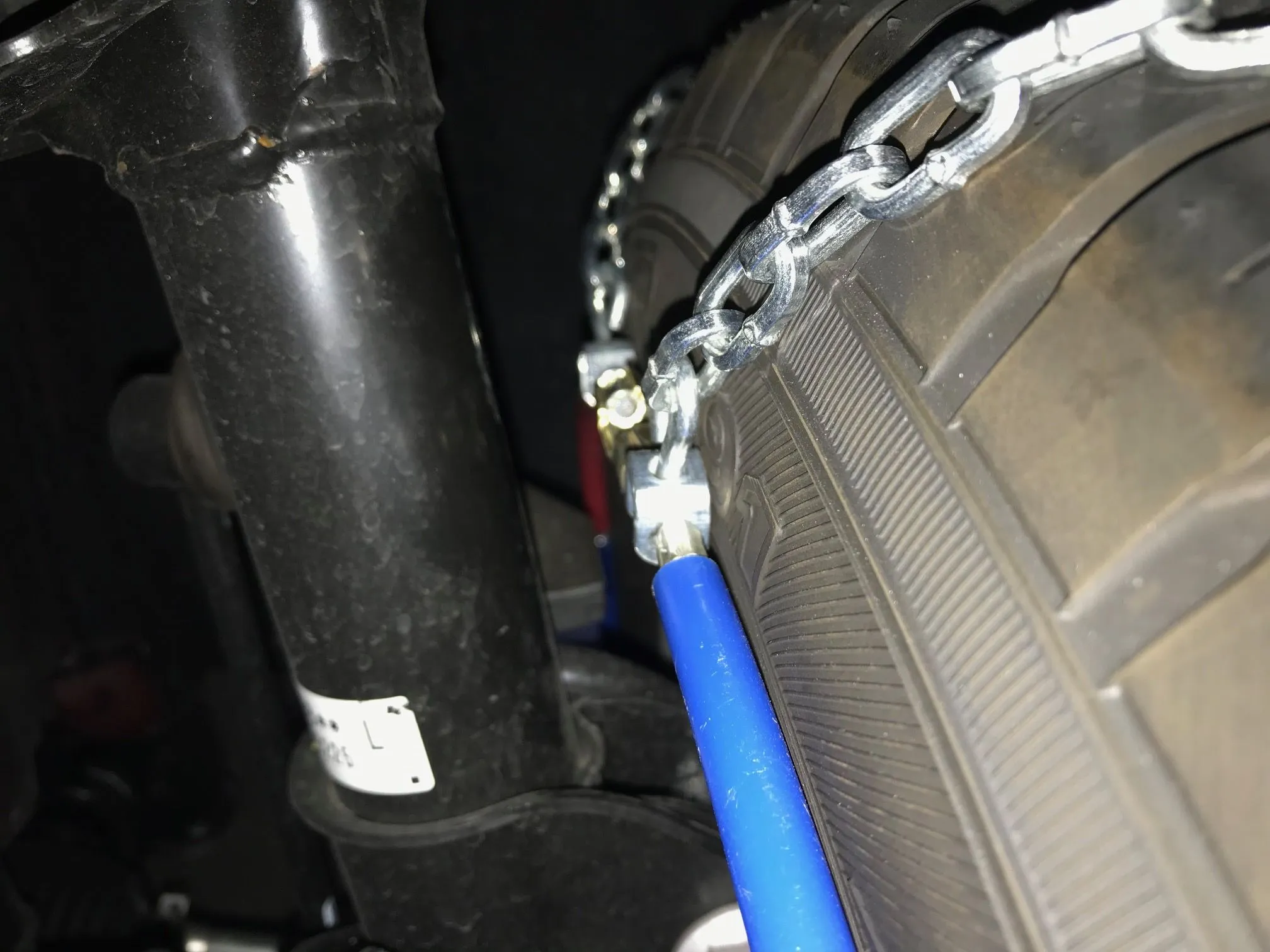

Thanks for posting that. I looked through my paperwork and definitely didn't receive that warning with my car. Since I already purchased the SZ429, I gave them a test fit. It actually clears the wheel well and main cylinder of the strut fine. But what worries me is the clearance to the lower part of the strut as well as clearance to the strut stop pads. Both were around 1/4" or less. Here are some pics.20191231_152651x copy.webp20191231_151709x copy.webp20191231_151419x copy.webp20191231_145233x copy.webp20191231_144834x copy.webp20191231_144804x copy.webp
