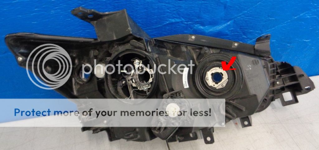

As referenced above, it's as easy as looking at the back of the headlight housing and seeing where the widest tab is positioned at. Specifically we want to know whether it's on the top or bottom. In our case that isn't all that easy to do. Thankfully salvage companies that like to sell headlights (and take pictures of said headlights) exist so I was able to find a picture that helps.
The arrow I've drawn in points to the location of the widest tab. It's on the top. Because of this, we can conclude that the non-LED CX-5s require the H11B bulb. For the record, The Retrofit Source states this as well on their website if you put in your car information before shopping.

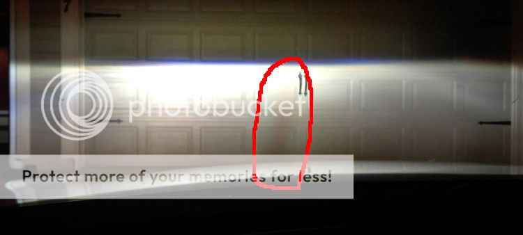

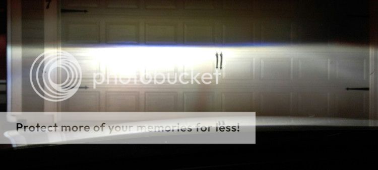

The ground/return wire shadow:
(This image was borrowed from the internet. It's not originally taken by me.)

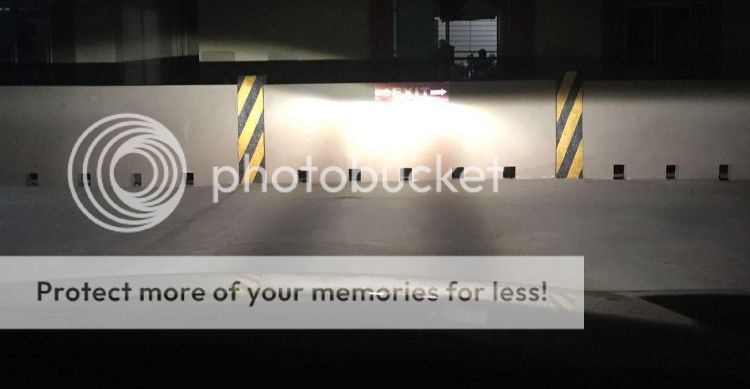

It's called the ground shadow, ground wire shadow, return wire shadow, etc. It has many names, but what matters the most is that it doesn't look good and it's annoying if you're OCD like myself. You can see it in all it's glory in the above image. What causes it? The position of the bulb in the housing. When the bulb is installed upside down, the return wire on the bulb causes a shadow in the light output from the projector. The only fix is the correct position of the bulb itself which can be done either by buying the correct bulb or by modifying your existing bulb so that you can re-position it (which we're not going to go over how to do today).
I took this picture after installing an H11B bulb in the drivers side headlight and an H11A bulb in the passenger. The car is angled so it's not the best picture, but notice the shadow coming from the H11A side that's missing from the H11B side?

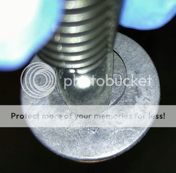

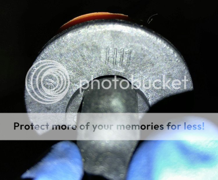

This part is for those who buy lights from CNLight. I believe the majority of setups you can buy from vendors online likely have bulbs made by CNLight, but I don't know if they change the stampings on their bulbs so this is specifically for CNLight bulbs only (until proven otherwise). I'm including this because it caused a lot of confusion on my part and took clarification from a vendor for me to understand. CNLight does not mark their bulbs as H11A or as H11B. The H11A bulb is marked as H11, and the H11B bulb is marked, strangely enough, as H16. I confirmed this with Diode Dynamics as, originally, I thought the wrong bulb was sent to me.
This is an H11A bulb.
This is an H11B bulb despite it saying it's an H16.
